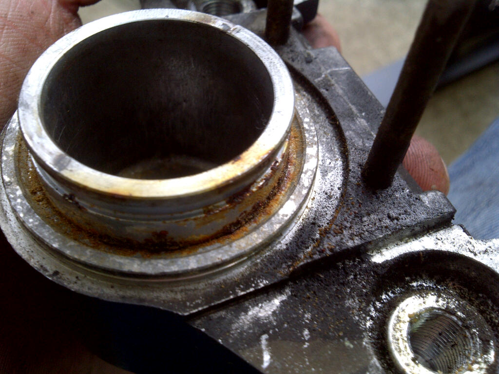

Here are some pictures of the piston. I tried pushing the piston back in with a C Clamp and it would not budge. I wonder if it is all the way in already?

ok! Thats pretty bad! Definetley want to take your time getting it out. I did see pistons on ebay and I'm sure even your local dealer will have them. I'm curious to see what the inside looks like since you cant even get that piston to move. Remove the caliper, if you havent already. It'll be way easier to work on off the bike. doesnt matter if you use PB blaster, or my favorite skin so soft, youre going to have to let it soak. Maybe this is a good time to upgrade to a dual piston caliper.
