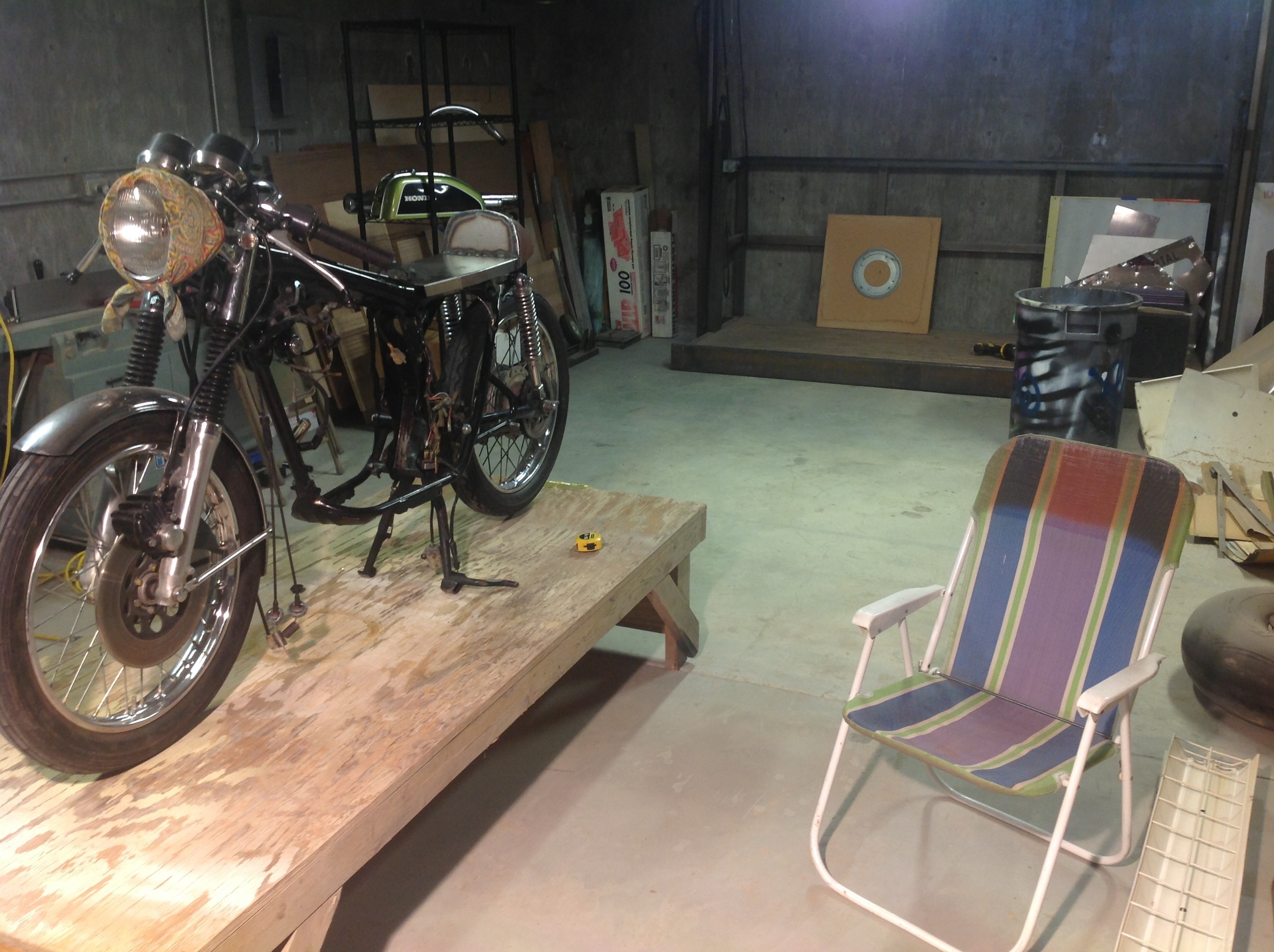

So, would it be possible for me to get a shorter shock, power the front end an inch and get a larger tire in the back?
I have a 2x4 under the wheel right now to get an idea of where I need the wheel to sit for chain clearance. Pic after lunch.

If everyone had your mentality then we would all ride stock Japanese bikes and nothing else, no cafe bikes, no choppers, no trackers. I have been very understanding, and I refuse to humor you with any aggressive comments, I may be 18 and naive but I also understand when I don't need to waste my time with someone like you.
I think you might be able to get away with a smaller shock, if you can find the right one. I would also consider adding a bit more bracing from the upper hoop to the swingarm. But i think thats out of scope at the moment.
I would put the engine back in the bike so that you can measure the stroke of the rear sprocket in relation to chain alignment. Measure the shock mount at the max upper and lower bound. That should give you a good estimate on what size shock you could put in there.
