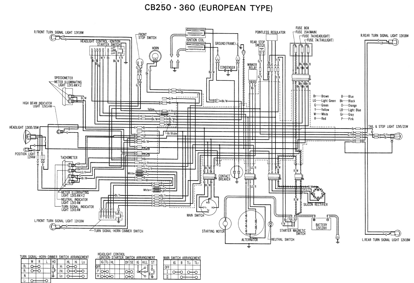

Can any on you legends help a brother out with a wiring diagram for a 74 cb250g
I have searched google for some time and cant seem to find one that matches my harness
(some of the wire colors dont match my harness and the odd wire on my harness doesnt exist on the diagram)

Enjoy!
