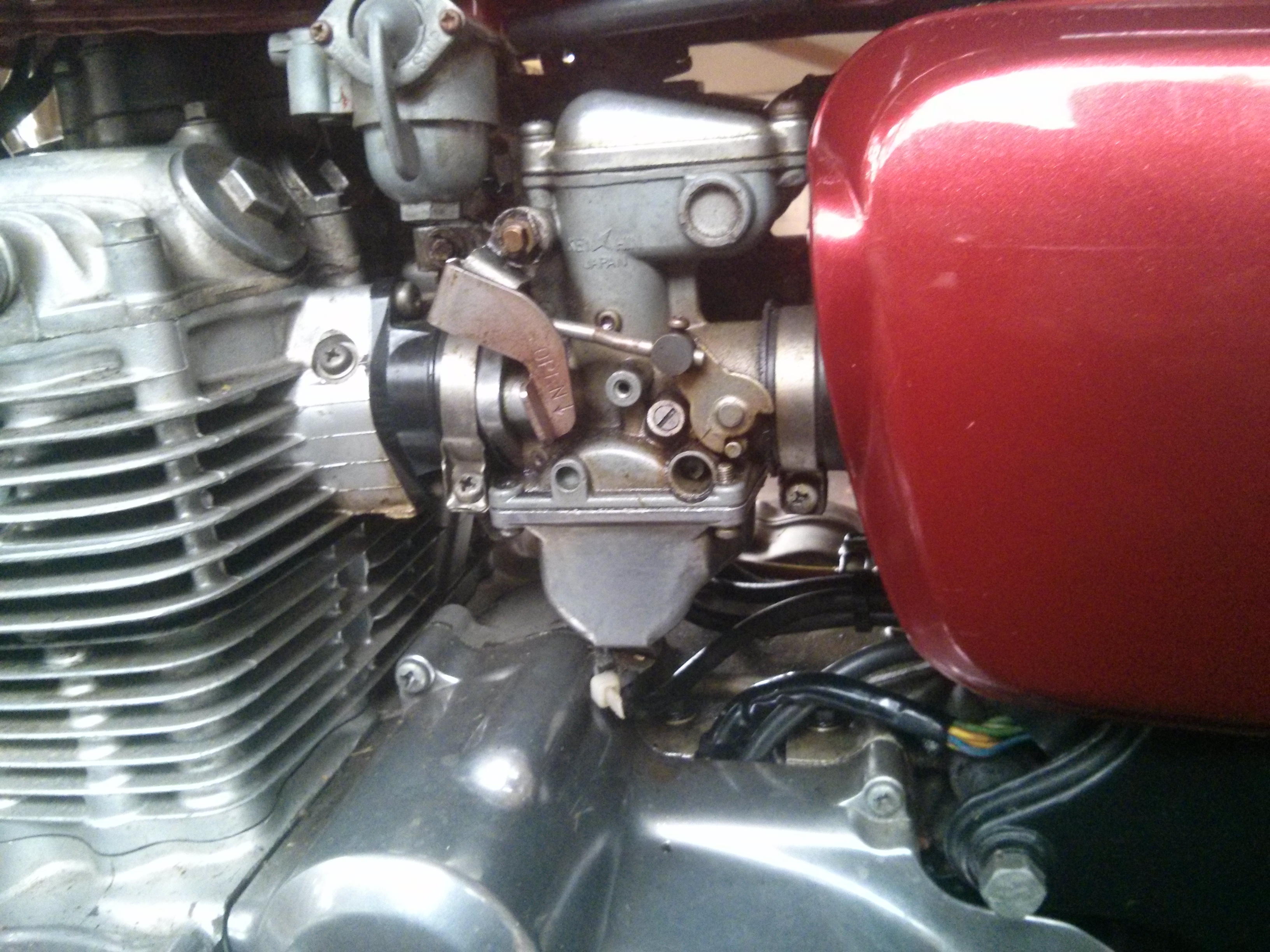

when I took her out of the shed there was quite a big puddle it seemed to be gas and oil I know the very first carb on the left leaked a little .there may have been some stuff in the carbs and tubes before I winterized her.

I am afraid to run the tank through because i feel the sound she is making is NOT GOOD. hopefully it's the carbs
