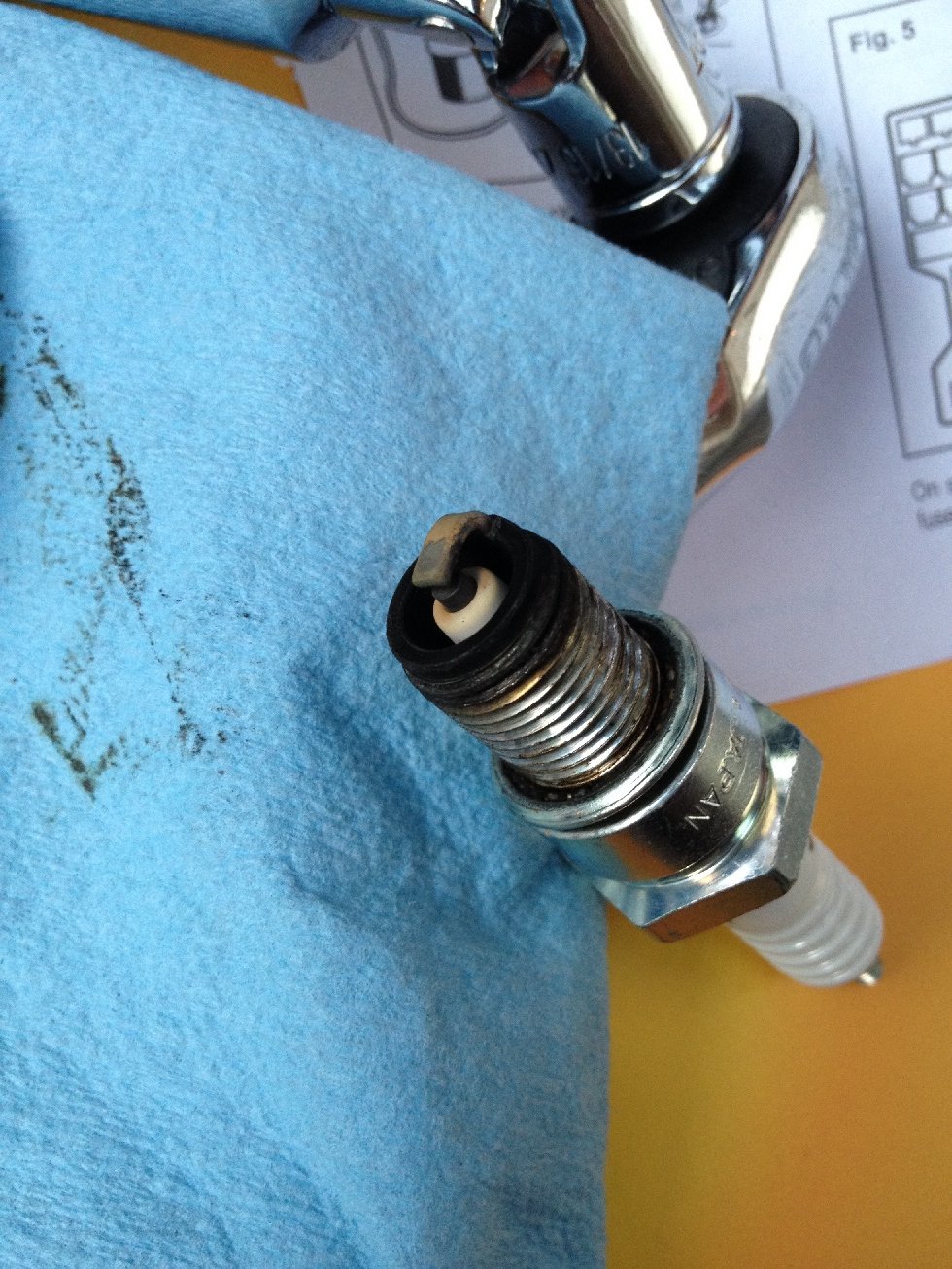

Hey guys, so here's the deal.
I have a '73 CB350 with a little over 6000 miles on it, which I have owned for a couple months now.
It was running ok when I got it, but never great. So, I have undertaken most of the normal tune up items: New gel battery, new petcock (had a leak), new fuel lines w/inline filters, tore down the carbs and replaced all the seals n rings (cleaned everything), new plugs, new points, new condenser, new intake boots and gaskets (fixed a racing idle issue), new throttle cable. I sorted the timing and carb sync, but it's still not running great.
My idle is pretty erratic (and stalls often), and I am not getting the power output that I should. Additionally, the left cylinder (which was always a bit more finicky than the right) runs colder, the left exhaust is wet at the tip of the muffler (oil I think), and it shoots bluish-white smoke when I get on it.
Suspecting the worst, I put a compression tester on it, and I hit 170psi left and right (pretty rad), but I did notice the left plug is oil-fouled. So what now?
(Attached are pics of the compression test, right plug, left plug, and left exhaust.)

I agree that there might be an electrical component to the inconsistent idle/cold cylinder, but that would not explain the oil-fouled plug, oil at exhaust tip or the blue smoke would it?
How does oil end up in a cylinder that has not had it's rings/compression compromised?

a broken or stuck oil ring does not mean the compression rings can't do their job and in fact the extra oil will help sealing
you could also have a badly worn valve guide,but i think it is more likely an oil ring
i had this same issue on my 350 when i bought it.it ran fine but 1 pipe smoked bad
i tore it down to find fresh new pistons with a broken oil ring
try to get the thing running good and see if the smoking continues if so a teardown is in order
on the 350 you can even see inside the plug hole to look at the cylinder wall

Then, took some time to inspect the piston tops and (what we could see of) the valves through the spark plug holes. As expected, the right piston was dry and perfect grey with some very minimal carbon deposits on it. The left was also as expected, a thing layer of wet-ish black deposits. The interesting bit here was the valves. On BOTH sides, the exhaust valves were dry and clean grey, while the intake valves were a bit blacker (layer similar to the top of the left piston but much less of it.) I had expected to see perfectly clean valves on the right side and one obviously oily valve on the left, owing to a worn valve guide which was causing my oil problem. So it looks like @xb33bsa might be on the right track with the cracked oil ring.
