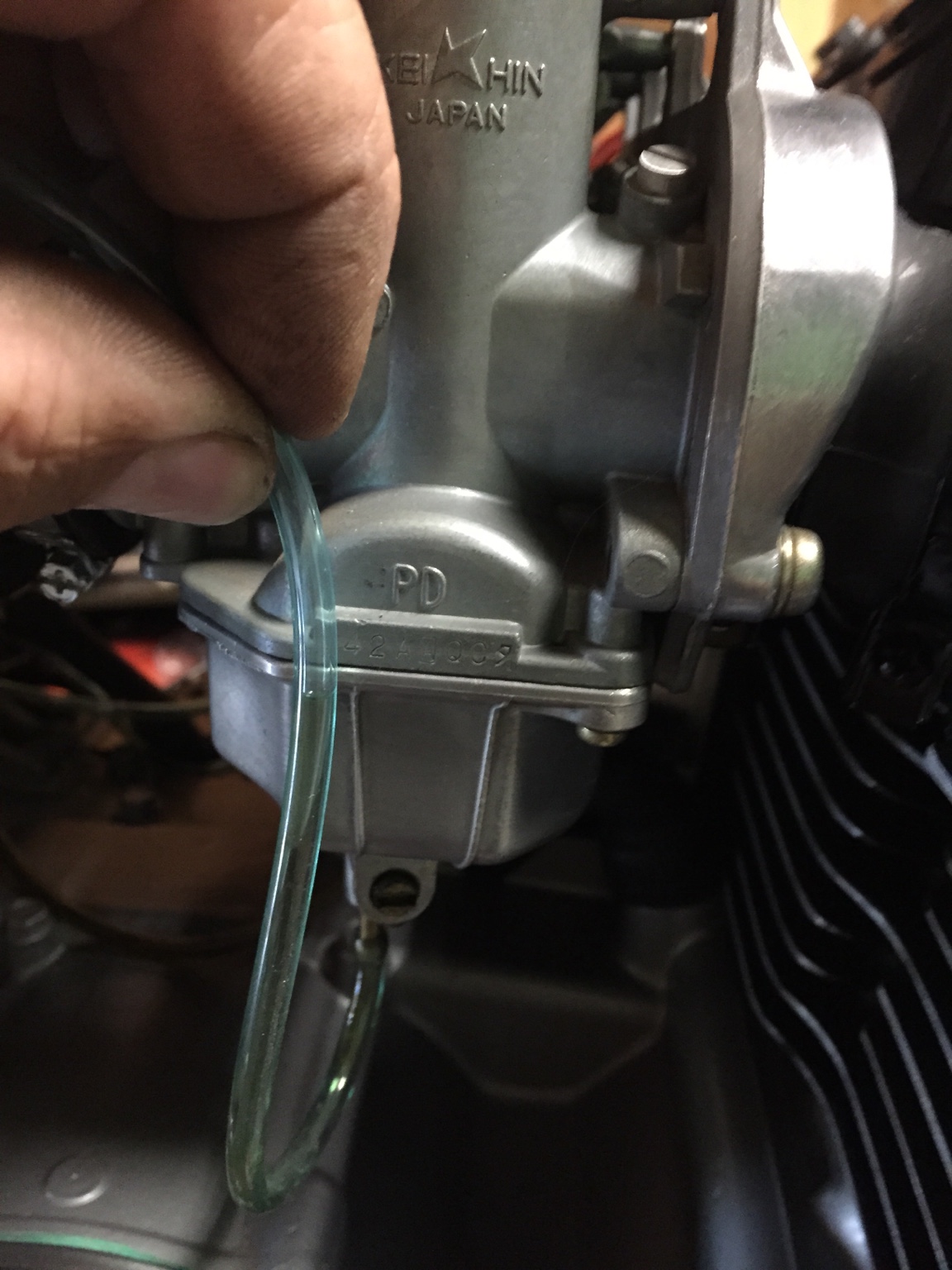

I doubt the fuel is bypassing the rings while riding, but if the fuel is weeping into the cylinders it could be draining into the pan, I would individually open the bowl drains and see if the fuel just flows free with the petcock closed to verify that and then check to see if the floats are set right by holding the drain tube next to the carb and see how high the fuel is in the tube with the petcock open and the drain screw open, should be just below the gasket.

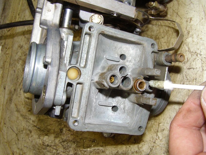

What do the tips look like? I absolutely HATE aftermarket float needles. They are damn near never to spec. If the tips aren't gouged or have a deep ring in them, you'll be OK. My favorite trick is using brasso and a q-tip. Polish out the float valve with the q-tip, until it's clean looking. Don't use a drill as you can take away too much material. Then do the same with the tip. Take brasso, put it on a paper towel, rub the tip in it and spin it if you can. That should help with any excess gunk that might be on them etc. Lastly, I don't know if it was mentioned...but do the tails of your float needles all spring in and out as they should? If one is stuck out or in, you will have a bad time :)

Yes, OEM carb parts ONLY! But I find it very rare that I need to actually replace a needle and seat assembly. Clean them like MBB suggests. Any fine polishing compound should work great - even toothpaste! (If you don't have any Brasso laying around!)
Sorry guys, the stock Keihins on the 360 dont work that way. The bowl drain screw simply drains w the screw. The overflow w drain tube is separate.
cant check fuel level w a tube. (god knows I wish I could.)
As long as the overflow tubes are clear and functional and the bike is parked on remotely level ground fuel cant seep into the engine.
