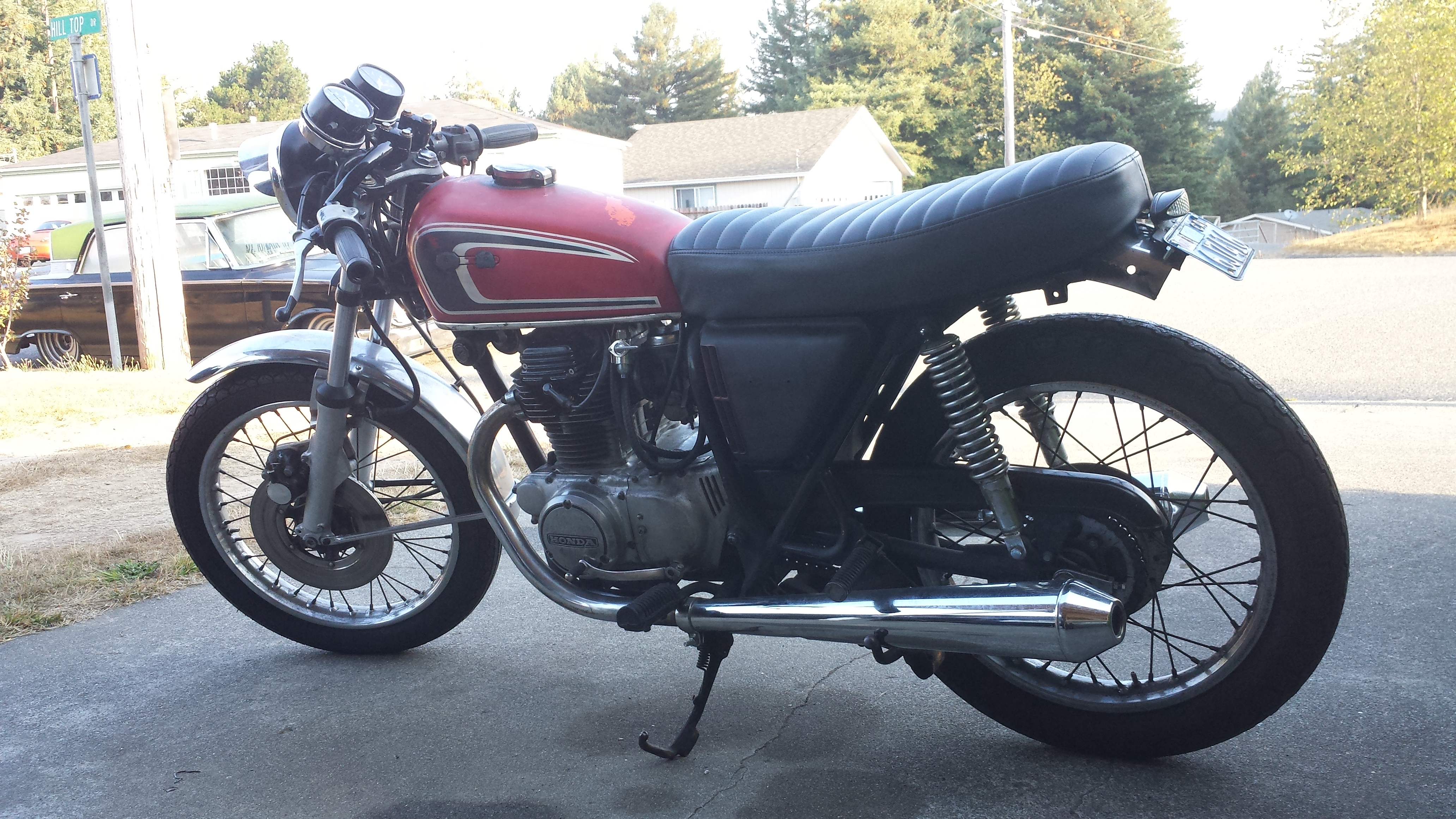

The other night I made some real progress! Got the engine out so I can start on doing a valve job and new gaskets. While its out I'm going to make a good assessment of what tabs and brackets I will be removing. Then its time for soda blasting and paint! I haven't decided on colors yet tho...
