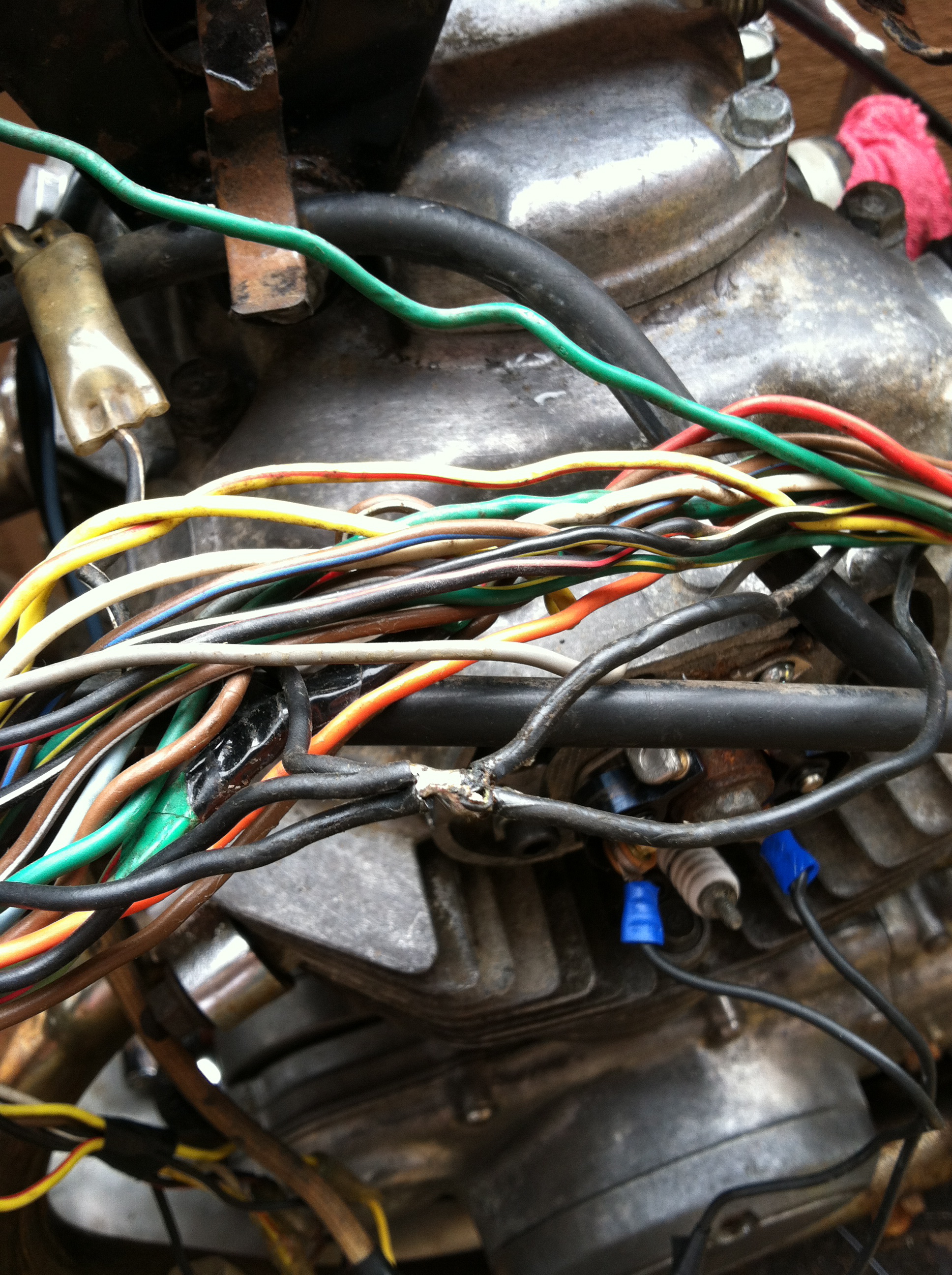

Pulled apart some more of the wiring and found some good ol' handy re-wire work. So from the picture with the wires coming in from
the left (I pulled the black wire coming from the horn off)
wires from the ignition>right handlebar switch>front stop switch>>>then the wires coming in from the right....voltage regulator<relay starter motor
Allllll spliced in one spot. Seems legit.. >:(
Is this correct? If so i plan on getting rid of that gob crap but I just want to see if this is all correct. Hate seeing janky work like this

Ordered a wiring harness for a 360 - consider this post closed. I'll post again if i run into any problems but again i appreciate the help you guys. Saved me some money and a lot of time. Always in tune with this forum so i'll keep you guys posted;
