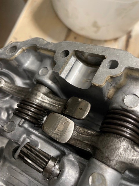

Fouling plugs and low compression led me to do a top end tear down. Inspection of the following pics shows issues. piston and head had some object flying around and deforming them. The other piston looks great and the walls all look and feel good according to the fingernail test. Should I replace the piston pictured or just clean it up?
Also, the cam is definitely worn, see pic. Where do I send the cam and rockers to get resurfaced? How much should that cost? I have all winter to get the project back together.

Piston and rockers look trashed. I would swap out that cam too. The second lobe in the pick looks gone, ie. worn at an angle.

CB360s often suffereed from cam problems and frequently also damaged the bearing surfaces in the head and rocker box, but yours look OK from what we can see.
I'd get the $30 camshaft in good shape that's for sale on Ebay and run that (here). There's a few NOS rockers and rocker assemblies for sale, too. Then, ride a life of frequent oil changes and never idling on the side stand.
