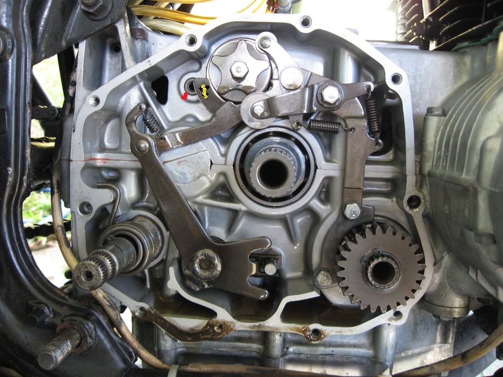

I fixed this issue last summer but I forgot to post my findings.
What I found was that in the gear shift linkages behind the right engine cover the stopper arm that holds the drum, gearshift assembly in place was bent outward. This was allowing the shaft to slide left and right and not hold 3rd gear in place. In the attached picture the yellow mark is the stopper linkage and the red mark is pointing to the end of the shaft. Bending the stopper back into position held the shaft in place so the assembly would stay in 3rd gear.
