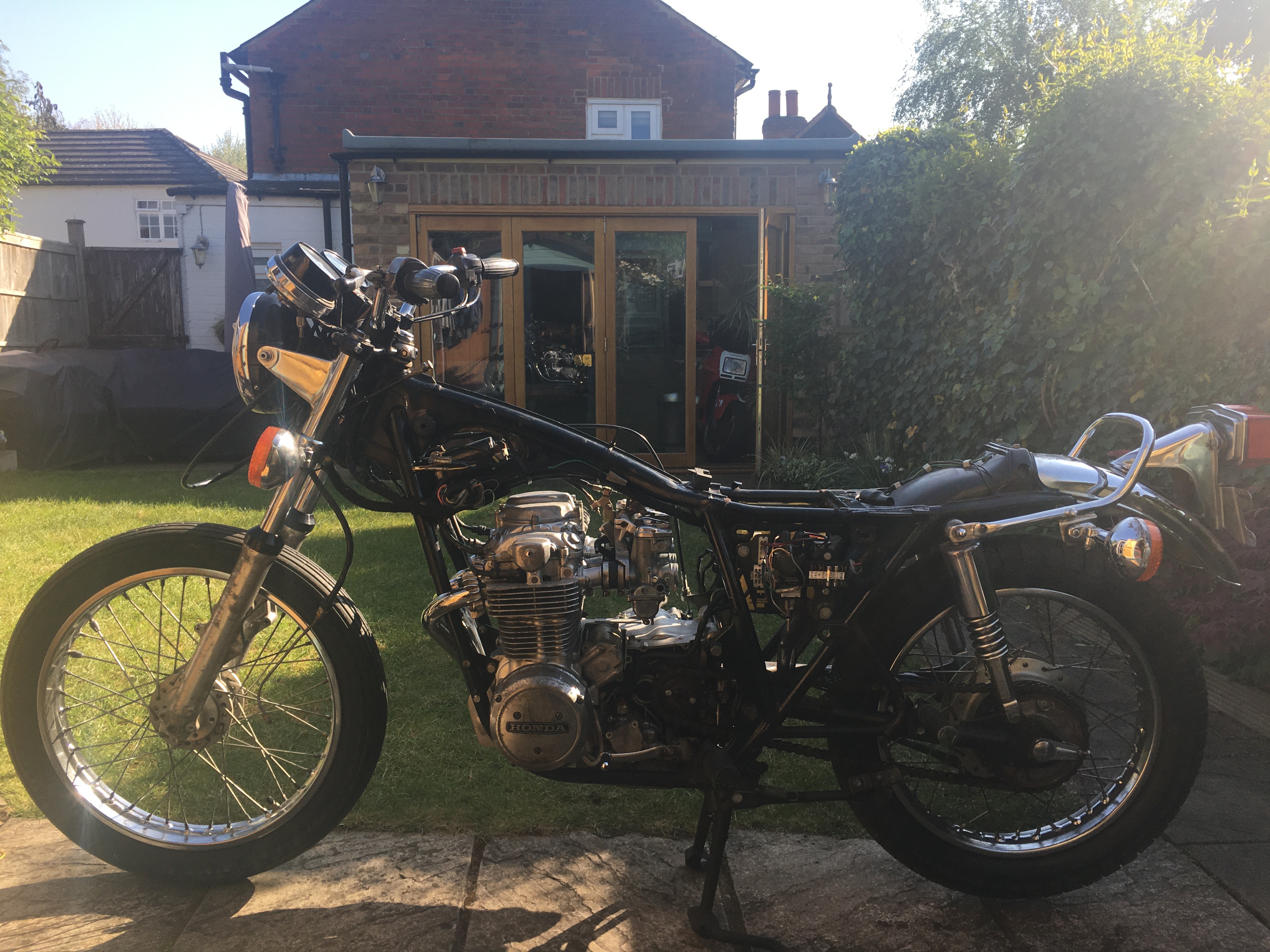

The CB550 project was delivered under quarantine conditions on 7th April, so I rolled it into my workshop ...looked right at home :cool:

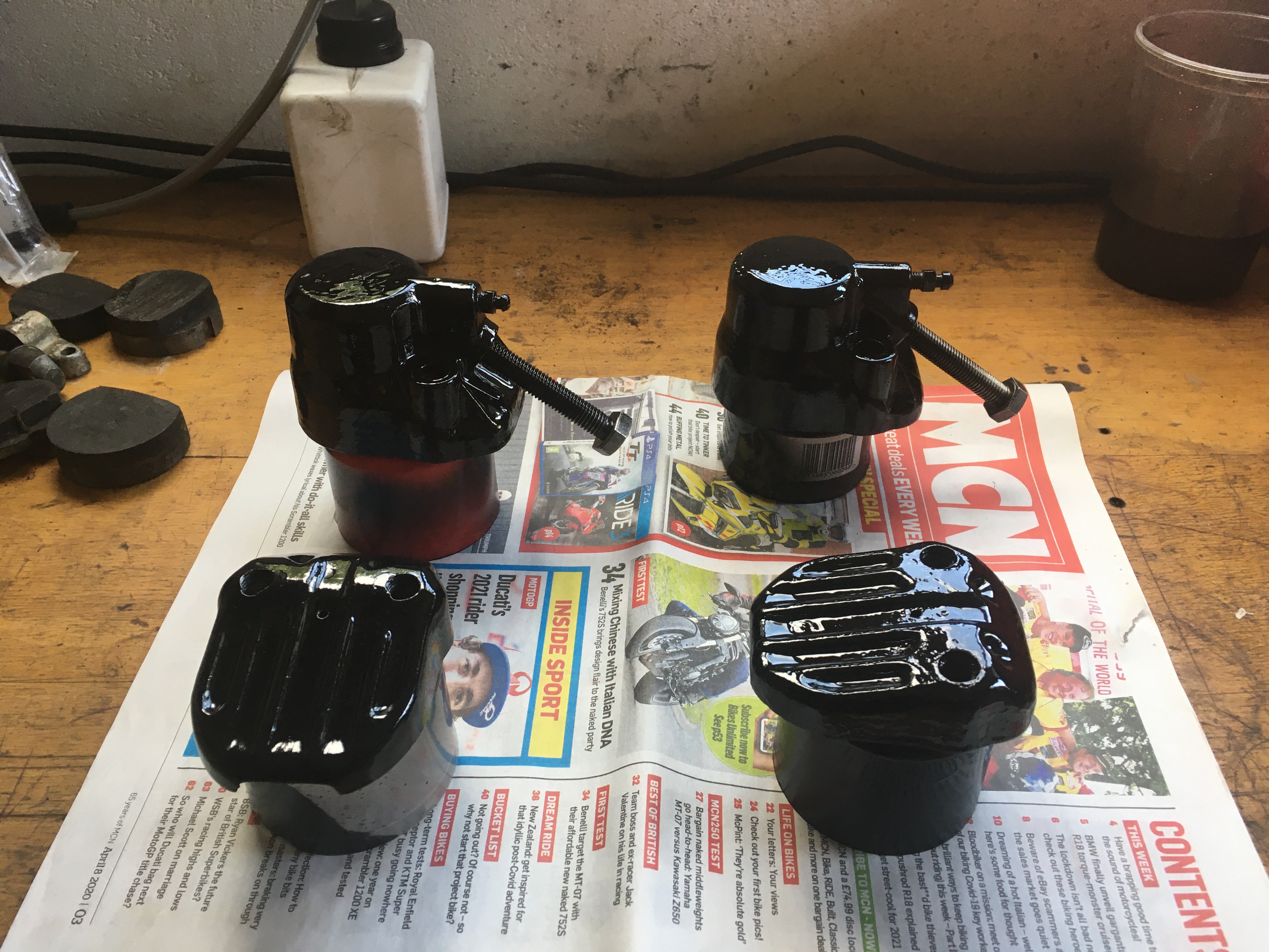

Carbs on the workbench in the garage, aka the 'cleaning station' and the off with the float bowls.
First two in amazingly clean condition but second 2 corroded out, float and jet mounts were gone !
How could two be so good and 2 so bad !?

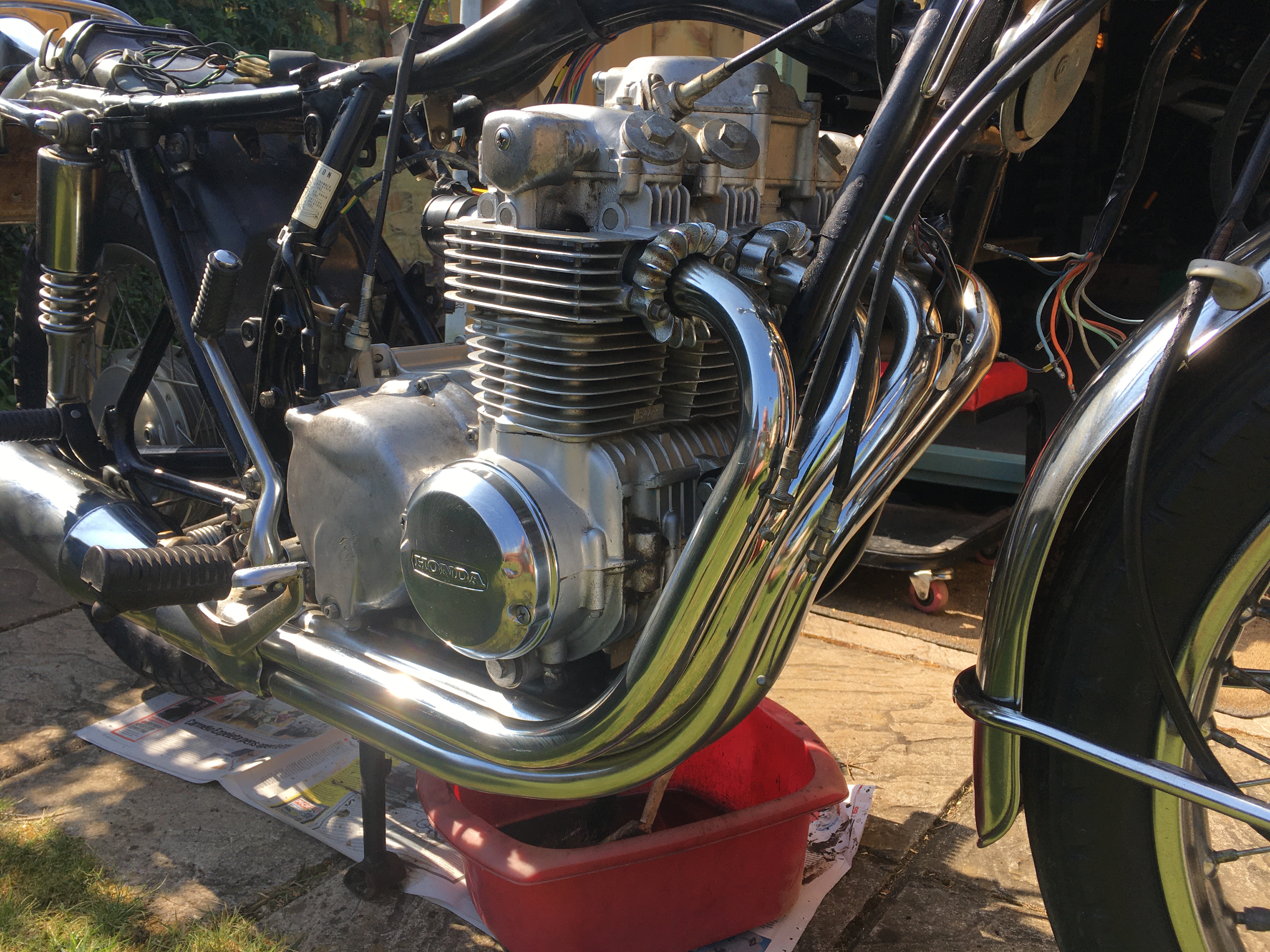

The engine was still seized so added some more Diesel and left the bike for another night, whereupon the engine turned over with no effort at all from a spanner :-)
So off with the sump for an oil ( and diesel!) change.
with new oil the engine spins up nicely.

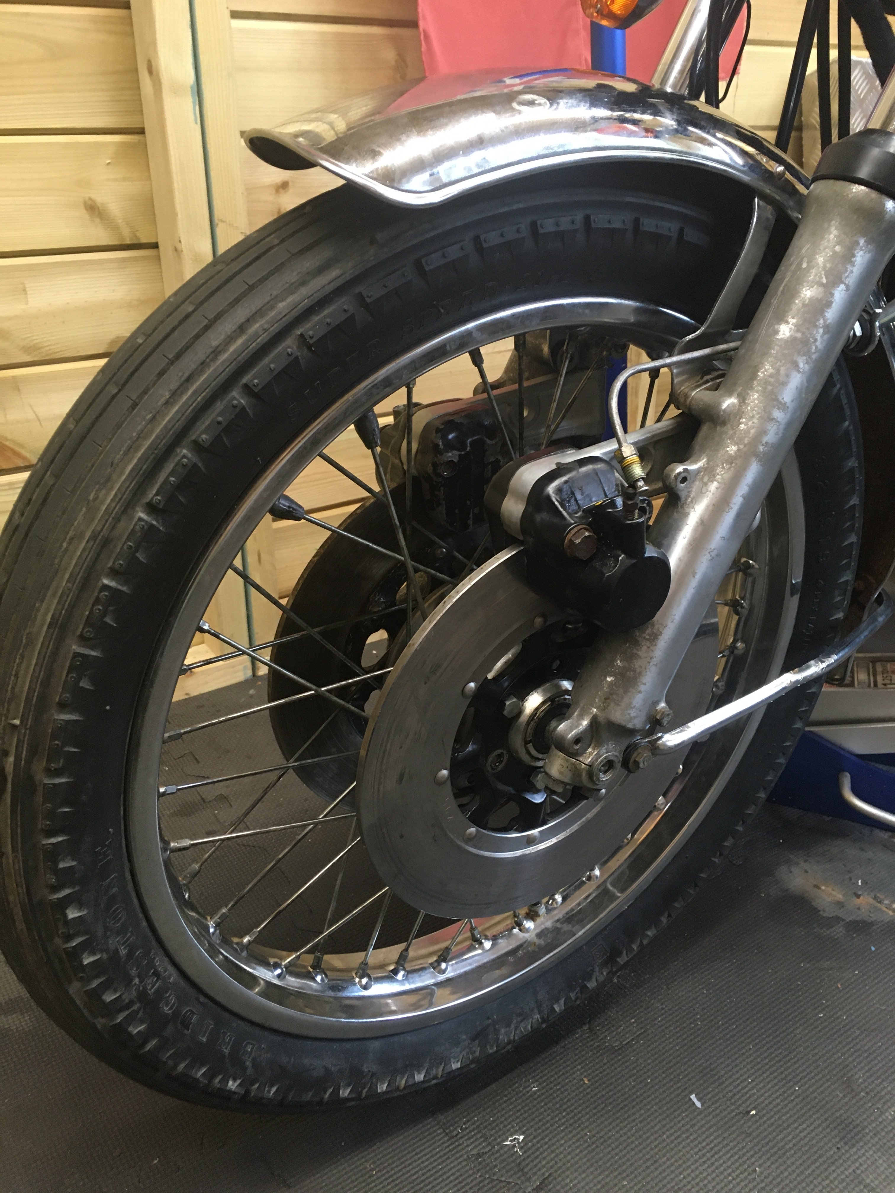

I still need to fit a pair of suitable lower hoses when these arrive, oh i also rebuilt the master cylinder of course. I plan to see how this works with the twin disks, if there is too much lever movement then i'll replace with a bigger bore item but i would like to keep the original if possible.
