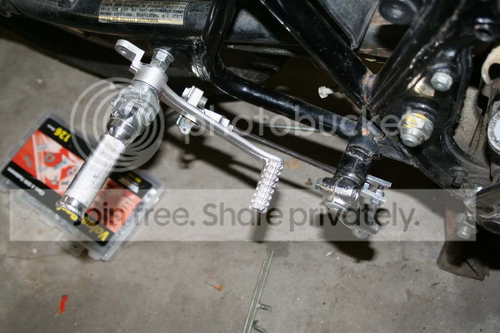

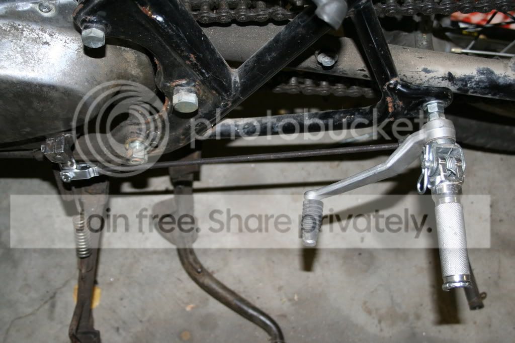

snowman88 said:So in my cb550 transformation into a cafe racer i upgraded my rearsets to a '01ish GSXR 750. Here's what they look like.
Brake side
locO leoN said:hey Snowman...
hows this brake pedal working for ya?
Looks like a very interesting ideal..Does the downward motion of the brake pedal pull the brake actuator arm enough to activate the brake?
Unless Im wrong, I believe that you are using a rear-set from a gsxr & that piece on the pedal that you mounted the rod onto is orginally used for the return spring.
I dont believe that it moves/pivot.. So im wondering if it will give you the motion & direction you need to properly pull that actuator arm...
