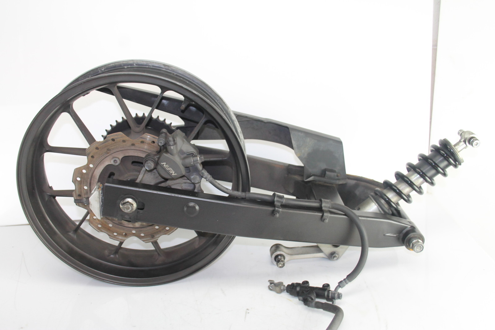

FZ6 swing simple mod with stock axle mod. 1-3.5in stretch maybe with some trimming of the adjuster block 0-3.5 stretch.
