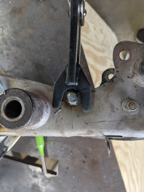

I it seemed everything was good but I was wrong. The swing arm had a slight bend in it and the rear shock mounts were pretty much trash.
https://ibb.co/ByqDDCL][/url]
I formed and redid the mounts using 12mm bolts but was not happy at all. So the project stalled a bit while I searched for parts and finished school.

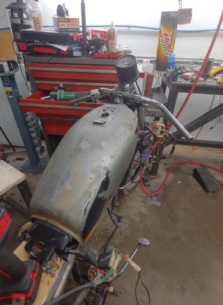

I decided to have a crack at the tank and see what damage I could do. I started by drilling two one inch holes in the bottom so I could get the big chunks out. I then patched them up and worked on the dents in the tank. Follow by several soaks on muriatic acid.
https://imgbb.com/]
[/URL][/url]
After all that work it came out pretty decent. I do have a back up tank on the way just in case I run into any issues with this one.

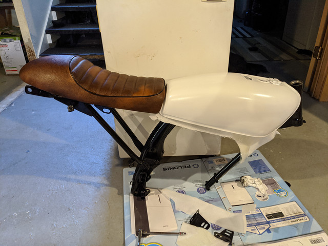

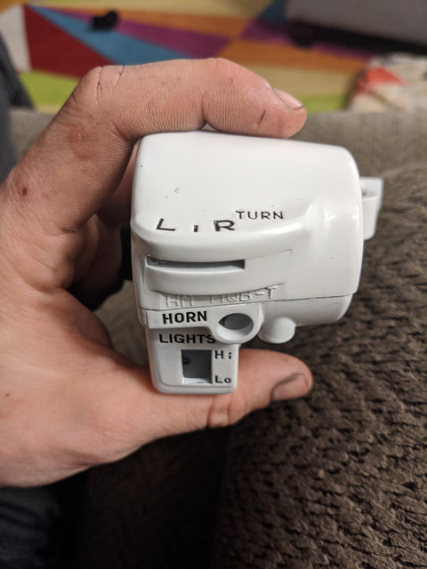

Here it is with a couple coats of white appliance Enamel.
https://ibb.co/gJLgs4s][/url]
Also in that picture is the new head light. The old one rotted out so I replaced it with an 8 dollar one from Harbor Freight. I plan on doing an led or hid conversion to it.

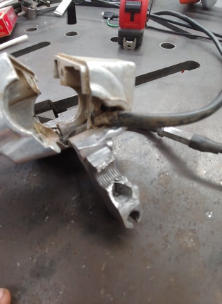

Broken brake lever fix. I don't plan on running the stock position mirrors so I welded it up and ground it to its final shape.

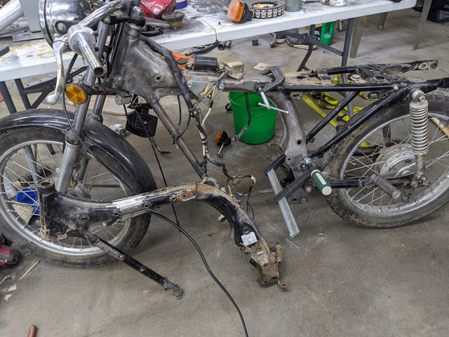

So I was working on the bike and having a couple Old Fashions and I had the dumb idea to do a partial frame swap. I made a template of the upper and lower mounts, made a center mark and then punched that center mark on the new and old frames. I took some measurements from each frame in relation to that punch mark and key parts on the frames everything lined up so the. I drilled 1/4" holes on the punch marks on each frame and proceed to separate each rear portion from their frame.
Once they were fully separated I cleaned up the mounts of the donor frame of cut marks and weld and bold it the the main frame. I assembled as much of the bike as I had and made sure all my measurements came out before any welding.
With everything coming out I welded her up.

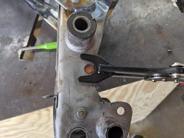

I had to relocate the spring perch for the rear brake. Ground the weld of from the back and punched it out.
https://ibb.co/ZXP0S2N][/url]
Nifty little plug weld tool from Eastwood.

Got a cheap seat off of eBay. My best friends uncle has been doing upholstery for close to 40 years so I'm gonna sweet talk him into recovering it for me after ive made modifications to it.
https://ibb.co/2ZkvM0R][/url]

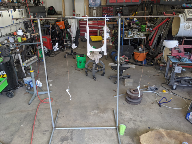

Painting some of the small parts.
https://ibb.co/c2N911W][/url]
I have to reshoot the the head light as I got a nasty run it but there is a chance I'm getting a used oven in a month so I may look into powder coating it some of the parts.

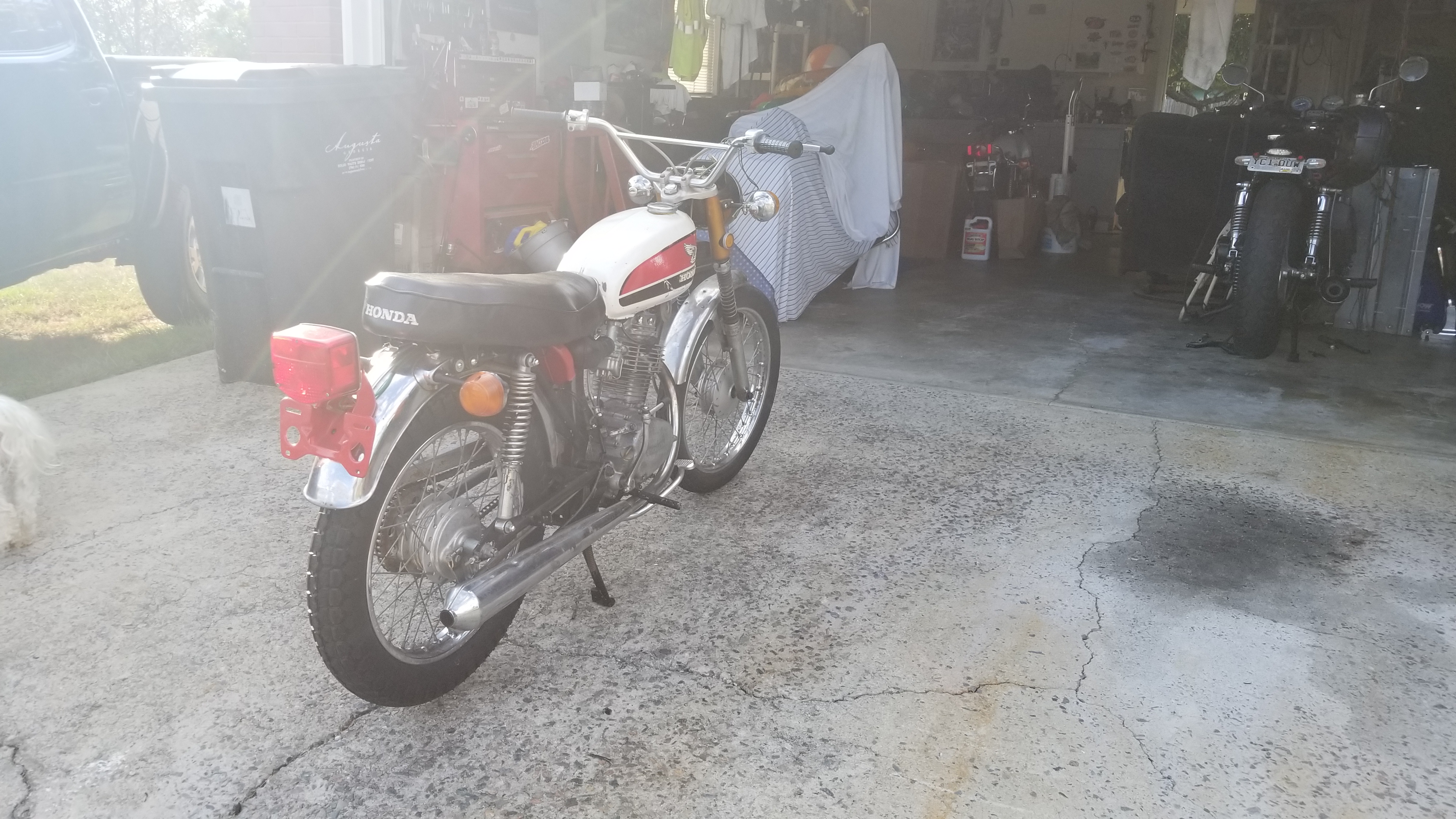

I may pull my little CB100 back down and do some clean-up on it.
