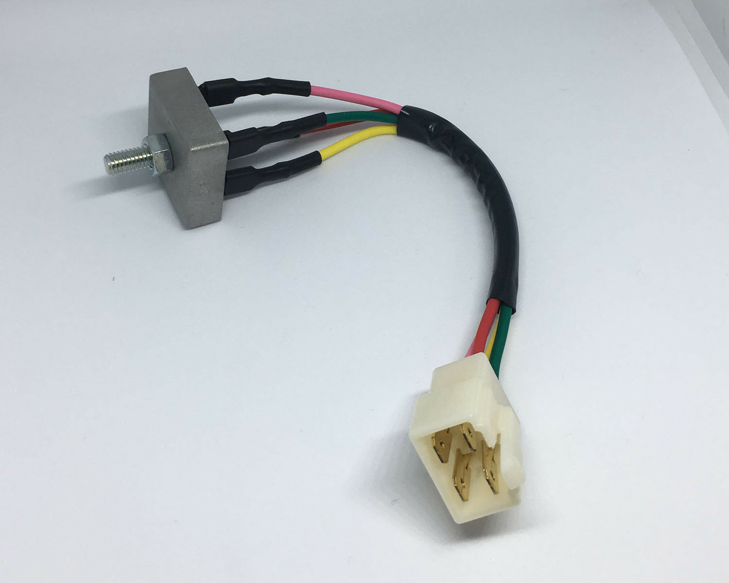

I think your right. I wired up a modern rectifier, just a simple $3 bridge rectifier off Amazon, and that seemed to help idle a little and maybe even power, and with a little more carb tuning I got it to a rideable state, but it still has the bog so I think I’ll do the full rebuild cause what can it hurt for $13 right?
Get the carb right and eliminate it as a possible problem. If not you will never get it to run right. Our old bikes are really simple but attention to details makes a big difference to how well they run.
