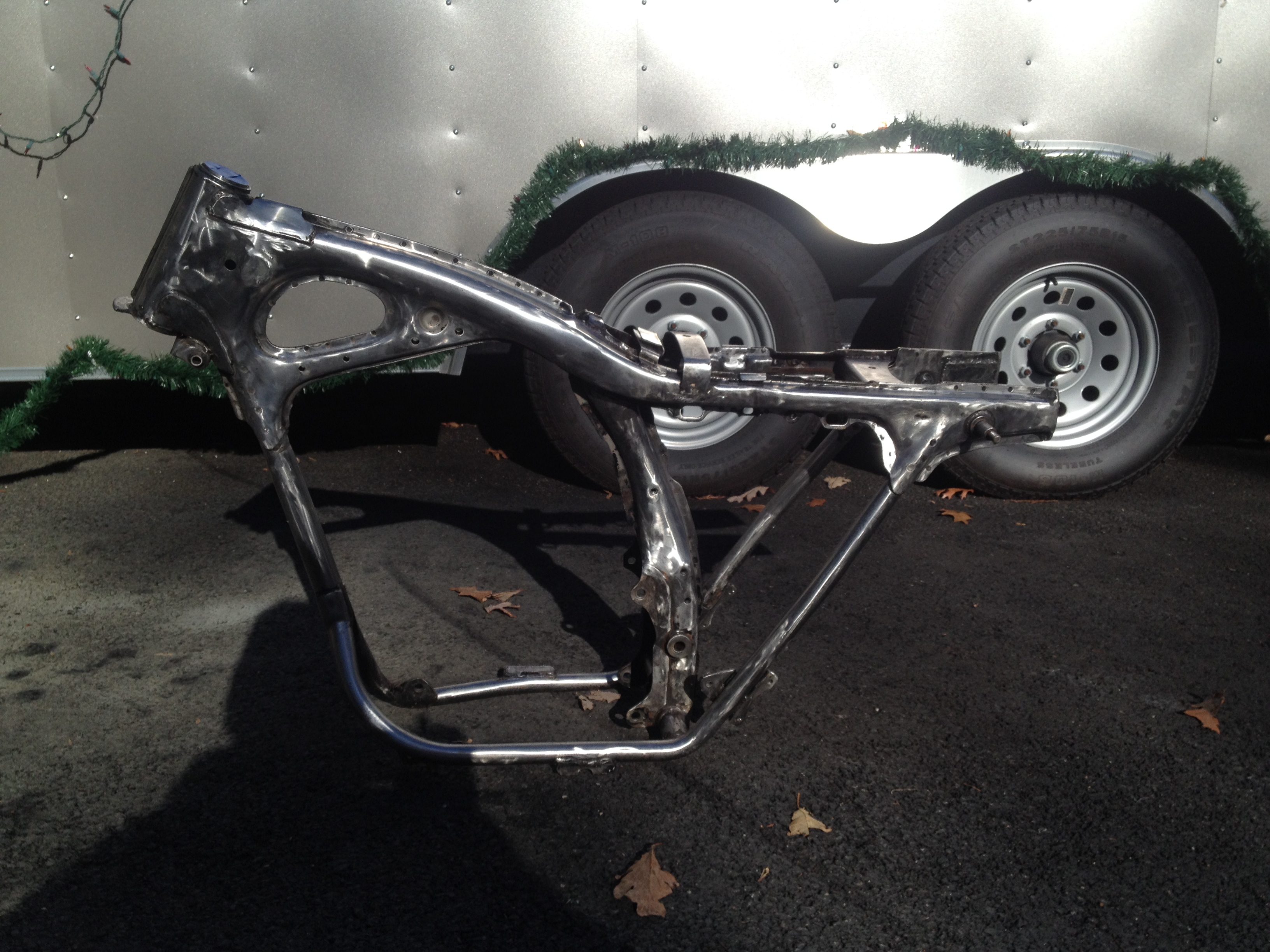

Took forever to get the frame bare because the compressor couldn't keep up but its done and painted. I used a black primer and I think that's all i'm going to do. I'll have to repaint it later but right now its just to keep it from rusting.

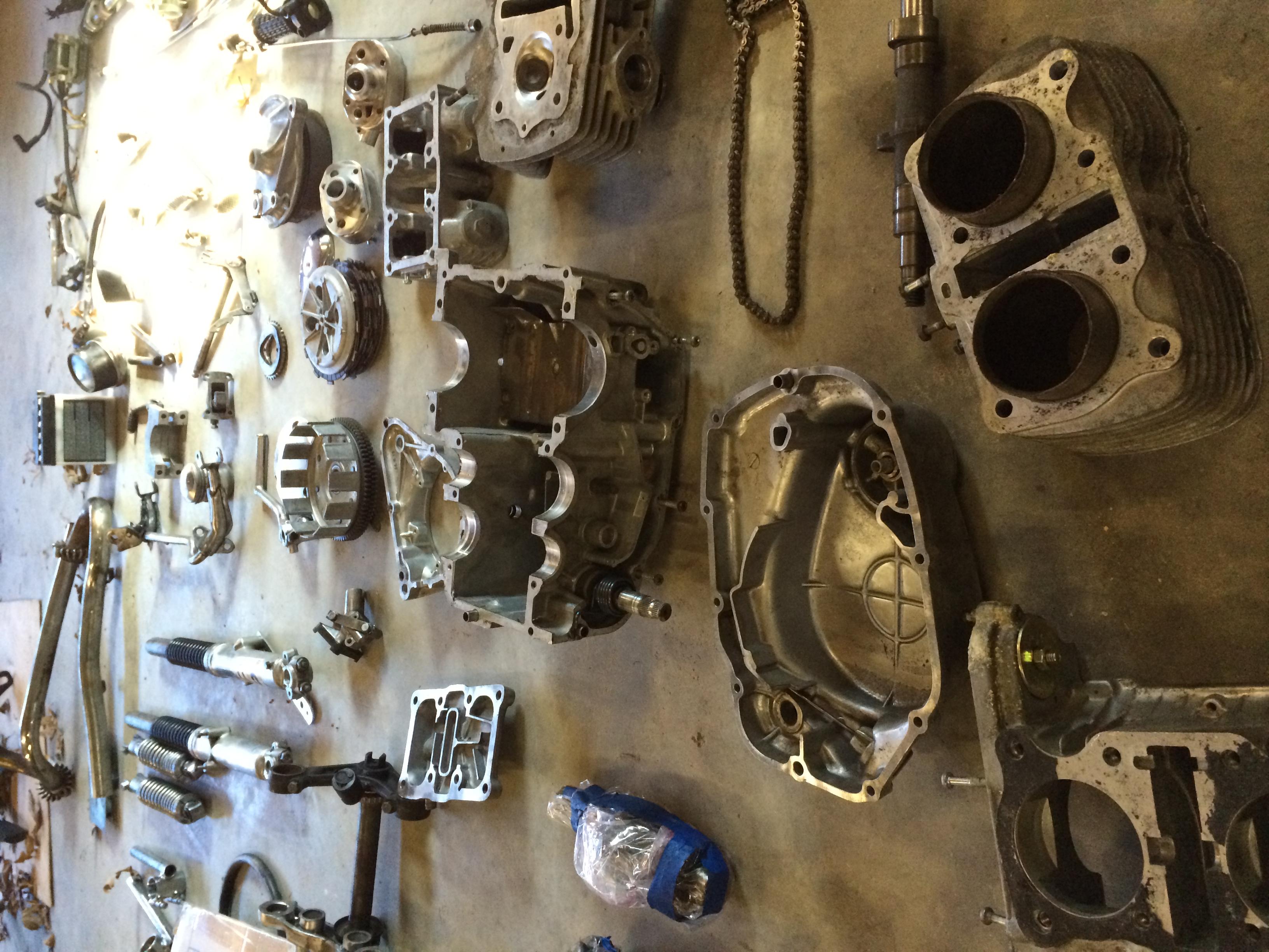

Everything's apart and I've cleaned for hours. I have no idea how I'm going to get this bike back together.

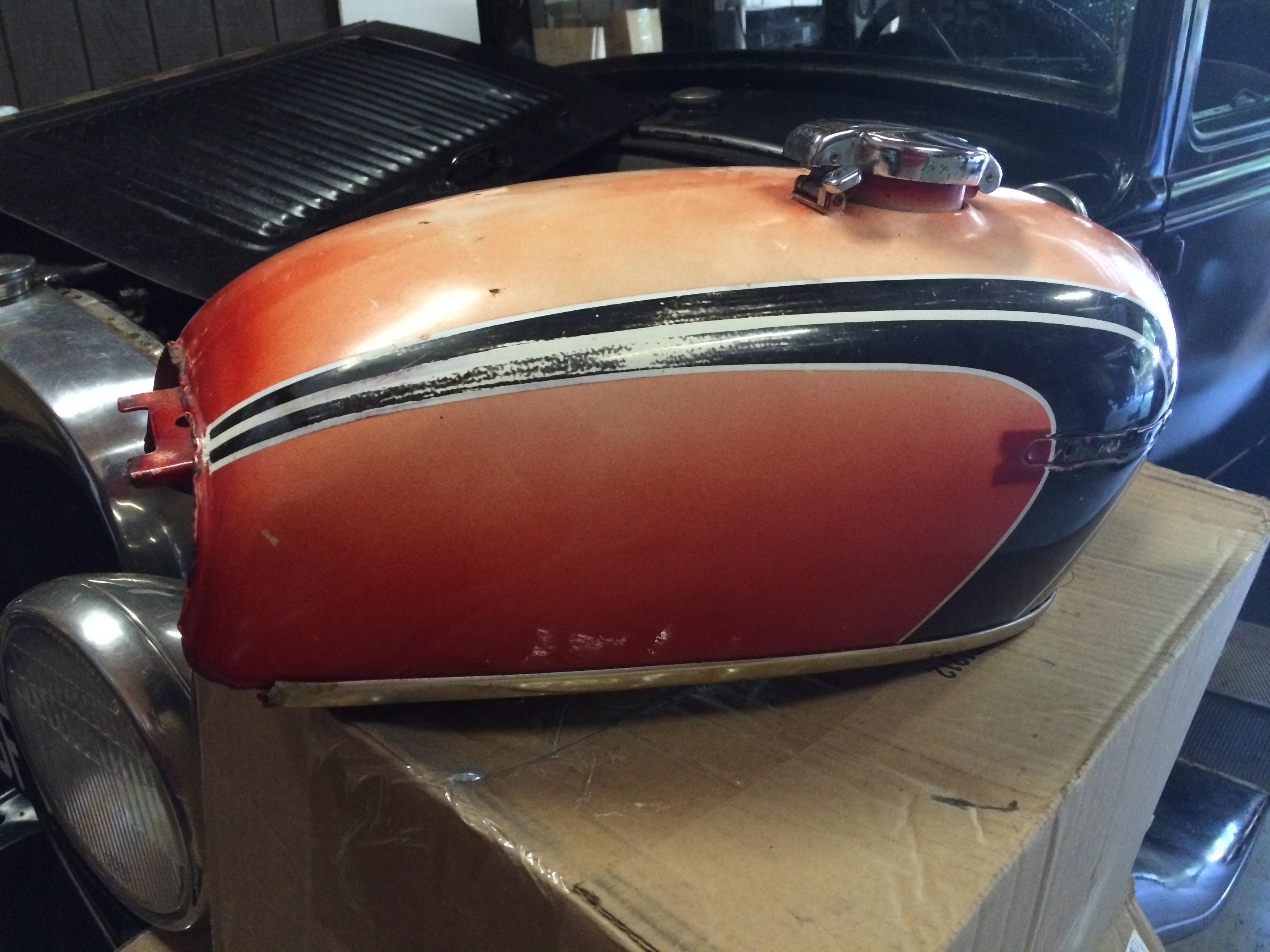

New Tank
I ordered a cb350 tank to replace the cb750 tank. Its got a small dent on it that I'm going to try to pop out, but I'm not too worried about it. The inside looks pretty bad, so I'm going to start cleaning it soon then let vinegar sit in it for a few weeks. Not sure what color I'm going to paint it, but I got a while before any of that.

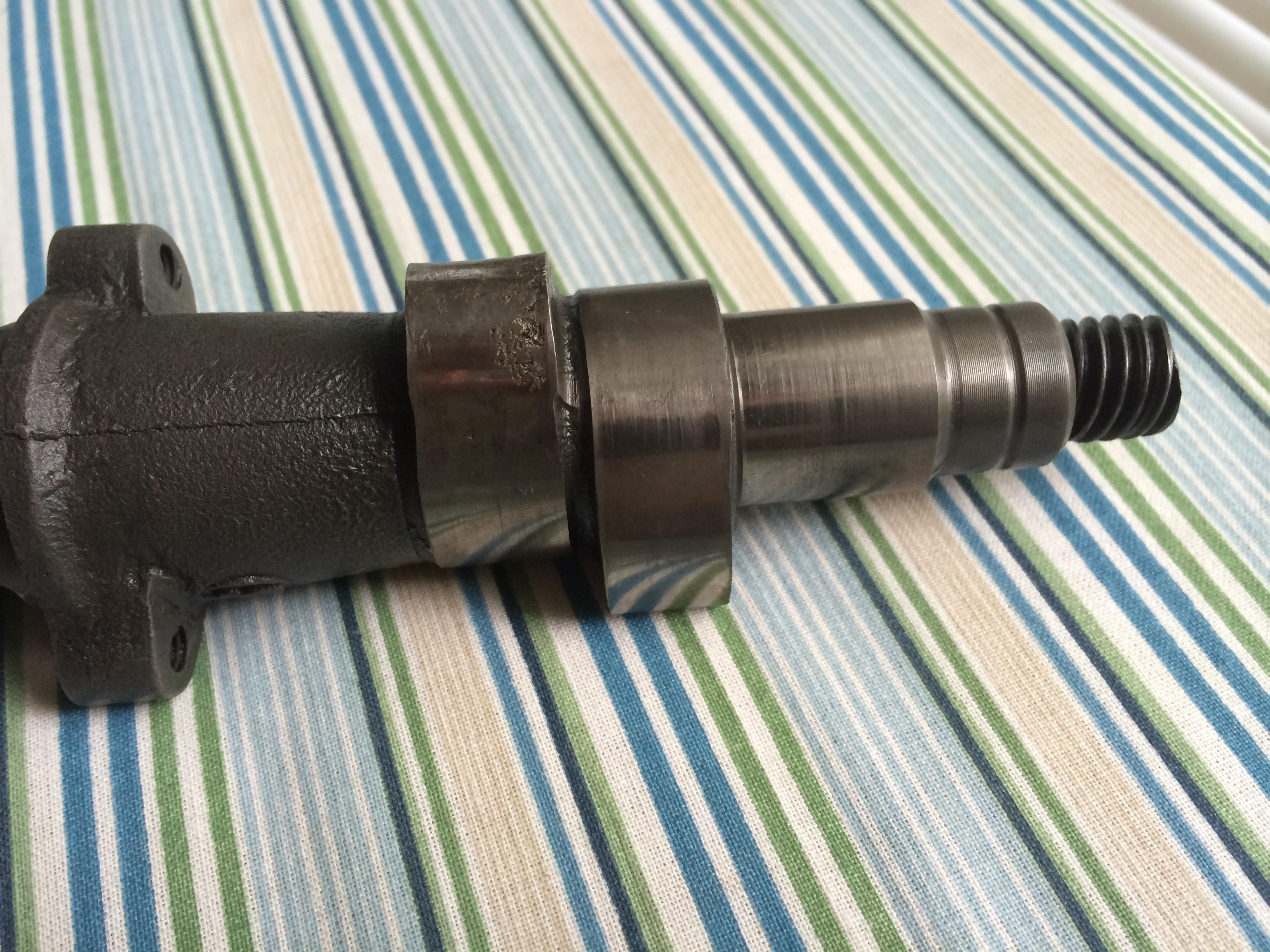

I found a used cam on eBay for cheap and the pictures looked great, so I ordered it. It looks great except for a couple scratches that I wouldn't even call "pits". I went back and fourth on just saving up for a racing cam and piston set, but this cam looks pretty good and a lot better than what I've seen people put back in their bikes.
I think I have everything to really start rebuilding the engine (that I know of). Sometime soon, I'm going to find two solid days where I can lay everything out again, pull the manual out, and put youtube on stand by and really start this build.

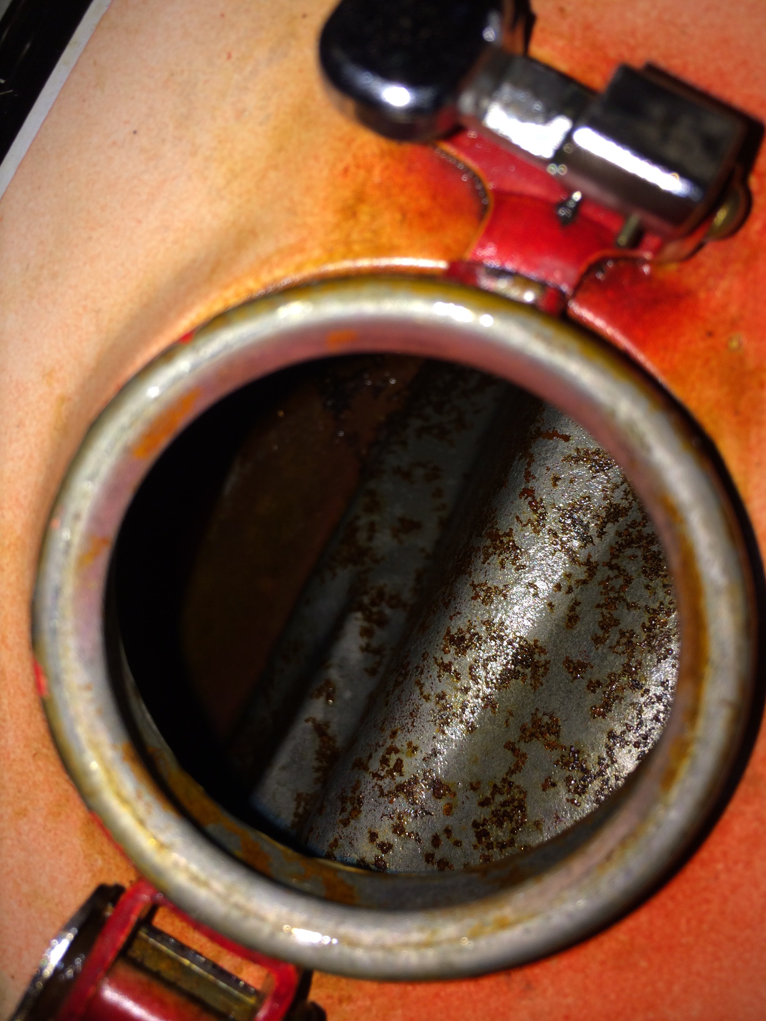

I saw a video of someone putting gravel in their tank then throwing it in the dryer to clean it, so I wrapped it real good and let it run for two hours. It came out great, but I let it sit for a couple of days and it got a good amount of surface rust. Next I plugged everything up and let apple cider vinegar soak in it over night and it looked brand new. I rolled some transmission fluid around in it to prevent rust since its going to sit for a while, but I opened it up today and took this picture. I guess I need to seal the tank as soon as I get the vinegar out and dry. I wouldn't have though it would have rusted that quick.
Next week I'll be putting the frame back together and hopefully rebuild the engine some. I think the only thing I'm waiting for is the fork seals and bearings.

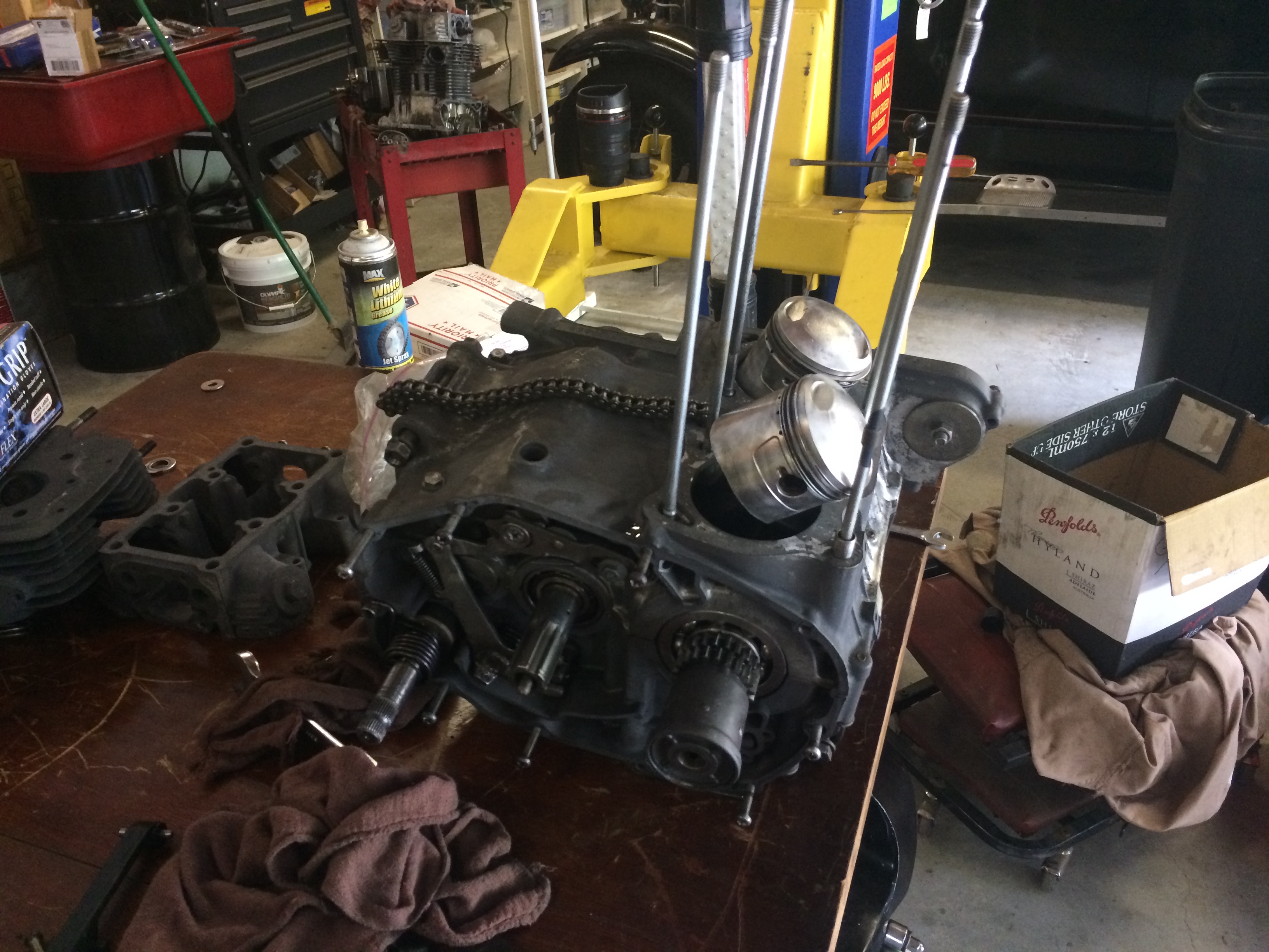

I've done some more progress and more importantly, I'm more confident in putting it back together.

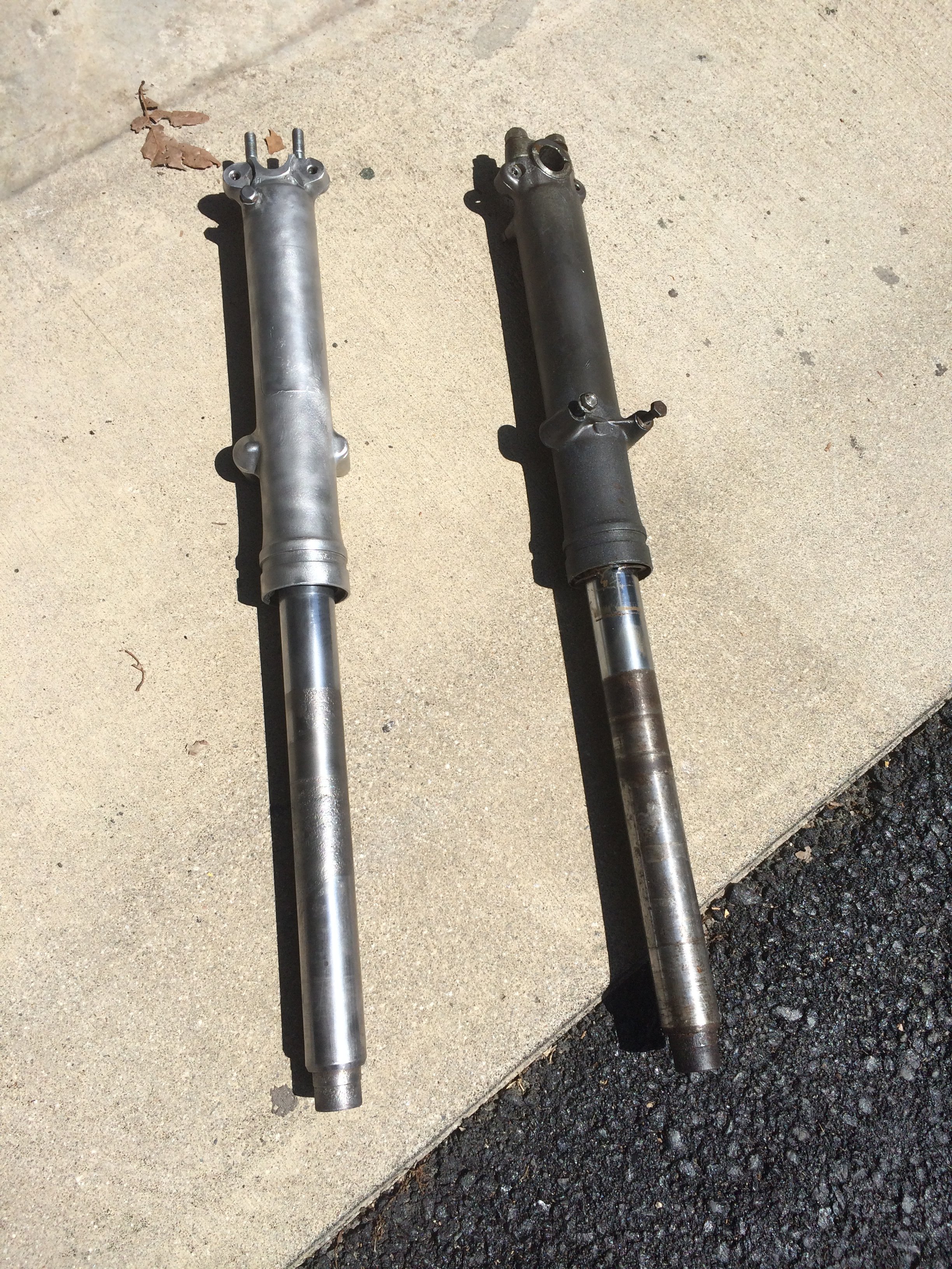

I got new seals for the forks, but I found out on one of the forks a washer and plastic piece on the very top was missing. They doesn't seem vital, but I will get them anyways. The first seal went right in with a little bit of oil on it and the fork, but the second was a little difficult so I put the old seal on top of it and hammered it in.
The bottom end is complete and I just test fit all the other engine parts on to seem if i was missing anything. I didn't realize how hard it was to put the pistons clip back in. I saw a video where they said just use your finger tips to not damage anything, so thats what I did.
Replacing the original cam chain tensioner with Bore Tech's KA1 slider type, but I'm not exactly sure which why it goes. I'll take a picture of it in a little bit and post it then someone can tell me if I'm an idiot or not. While trying to put those little rub pieces on the roller (from the original tensioner) I dropped one down in the engine and its under the cam chain in a spot I can't get. I probably got it stuck more when I tried to get it out.
