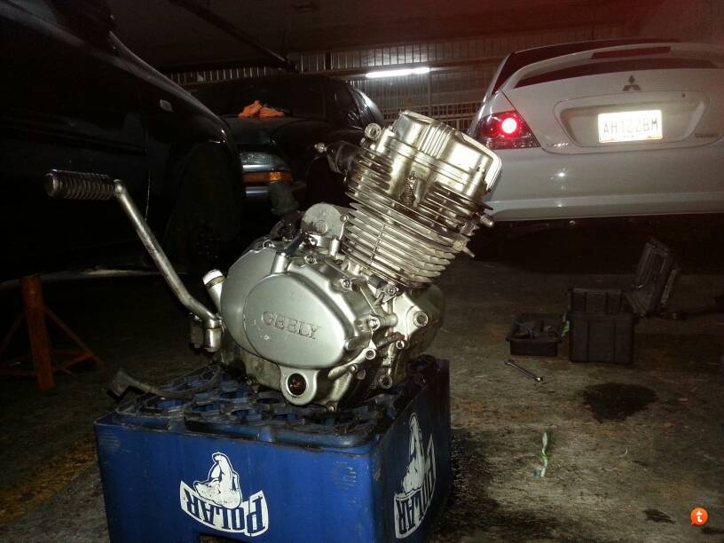

Began cleaning the engine a little, as it had years of oil dripping catching every little particle the road had to offer. Here's my endogenous work bench, beside a bottle of my trusty degreaser. Gasoline. I know I'm an heretic for using gas as degreaser, but here it is cheaper than water BY FAR.
These are the journeys I embark on, by working on my parking space hahahaha.

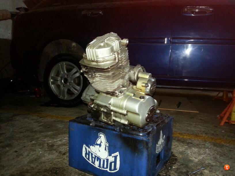

A lot cleaner engine:

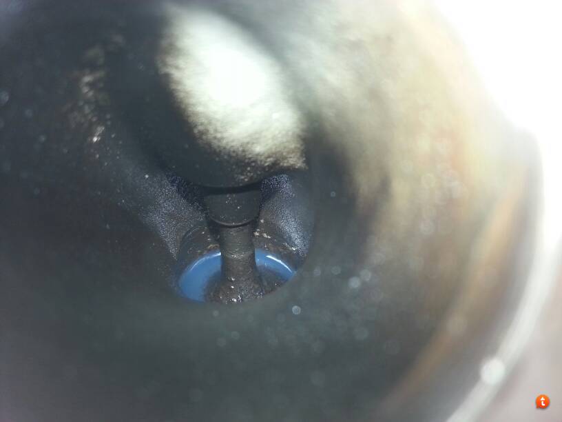

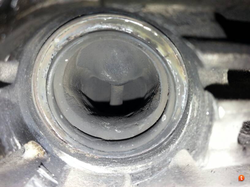

Exhaust and inlet ports:

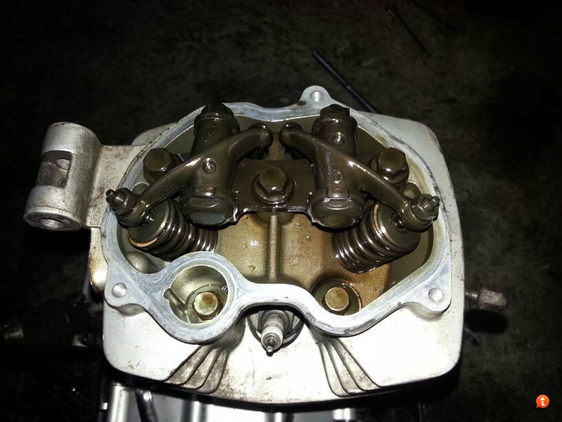

Removed valve cover then tappet assembly:

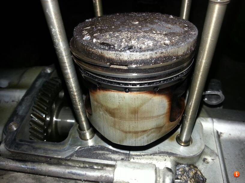

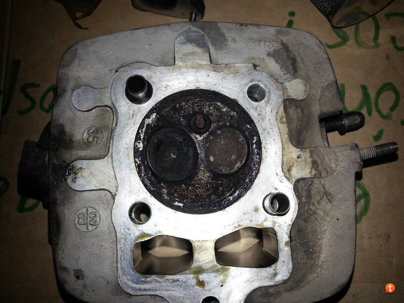

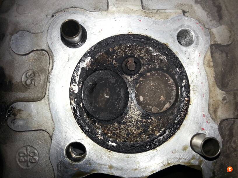

Removed Head. Notice the big amount of carbon in the combustion chamber and the top of the piston:
Removed the piston from Con-Rod:
After a lot of fiddling (without going into the lower part of the engine. Yet.) I found the Con-Rod, does not have any sort of play in any of its ends, other than axially.

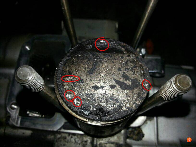

Taking a look back at what happened got me guessing why would the bike sound like that and unable to fire up. Looking deeper at the piston and chamber and I found little pieces of what looked like some sort of drop-like shaped object, of aluminum or another soft metal. This lead me to inspect further.
Spots where "intruder object" made impact with the piston:

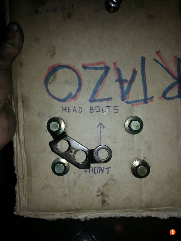

And last but not least, organization:
