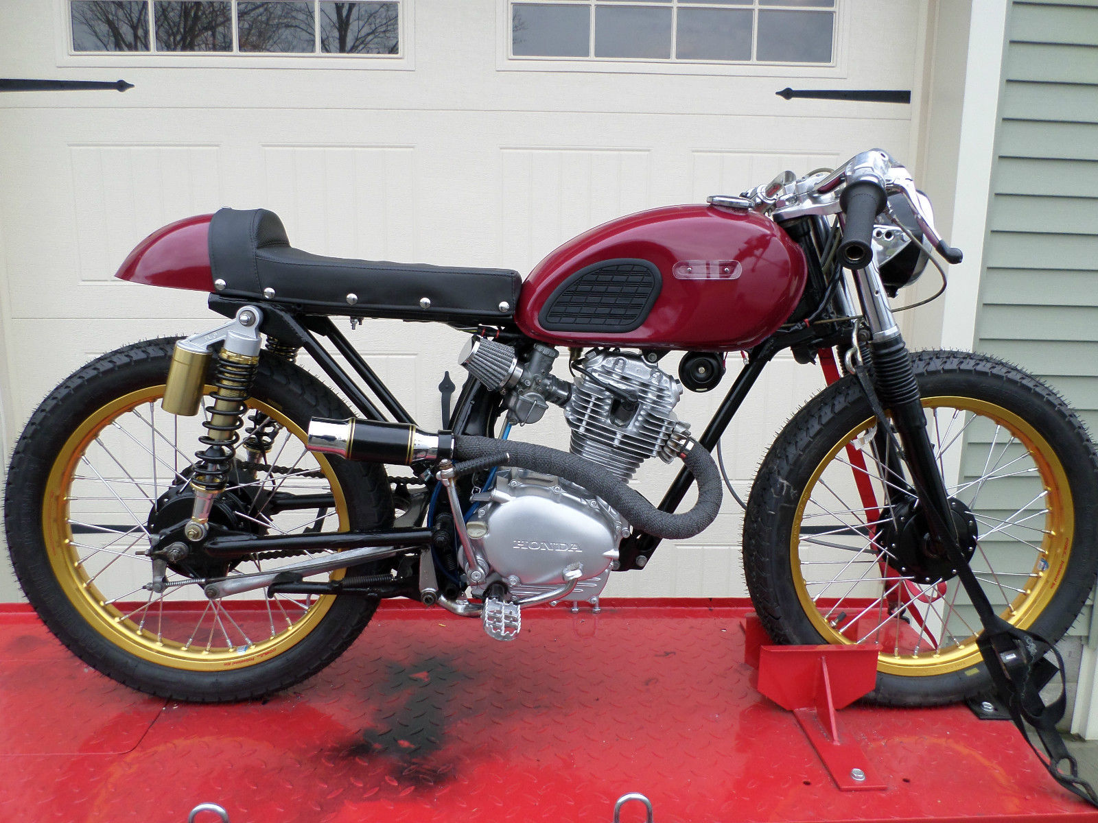

http://www.ebay.com/itm/Honda-CB-1972-honda-cb-125-cl-125-vintage-cafe-racer-scrambler-ahrma-brat-bike-/271340226679?forcerrptr=true&hash=item3f2d234877&item=271340226679&pt=US_motorcycles

Agreed. It does have some nice bits on it (I'd like to know a little more about that muffler, for one thing), but $4k for a 125 is pretttttttttttttttttttttttty steep.
What's nice about a bike that is worse then stock?
List of fails
-no front fender, these toothpick forks need allt he brace they can get.
-cheap junk shocks
-low bars and stock pegs for that back killing ride
-cheapest pod one could buy, sure it doesn't run well with that
-short cut pipe. Again these bikes HATE that.
-Gauges?
-No rear fender so the road crap flys at the carb....but let's face it this will not get ridden.
-willing to bet the rear frame cross over was cut out.
-Plate mount?
So much fail, just to get a look.
And then trying to collect the "hipster tax" with a meh listing in the winter?
