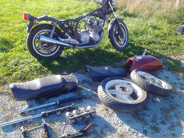

I scored a 80 cb750f with title and parts bike minus one motor.
In the same haul.... 87 cbr600 with title but snapped cam chain and a 89 cbr600 in parts.
Whats a man suppose to do when the materials magically appear in one garage for a super cheap price of 500 bucks.
Bring the F' to superbike status utilizing everything I can from the four piles of crap.
Here's to the start of winter, Ive got one hell of a project awaiting!
Ill also be parting out the spares so if anyone is interested let us help each other to fund each other.

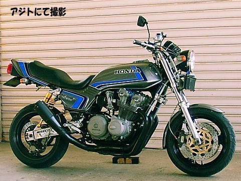

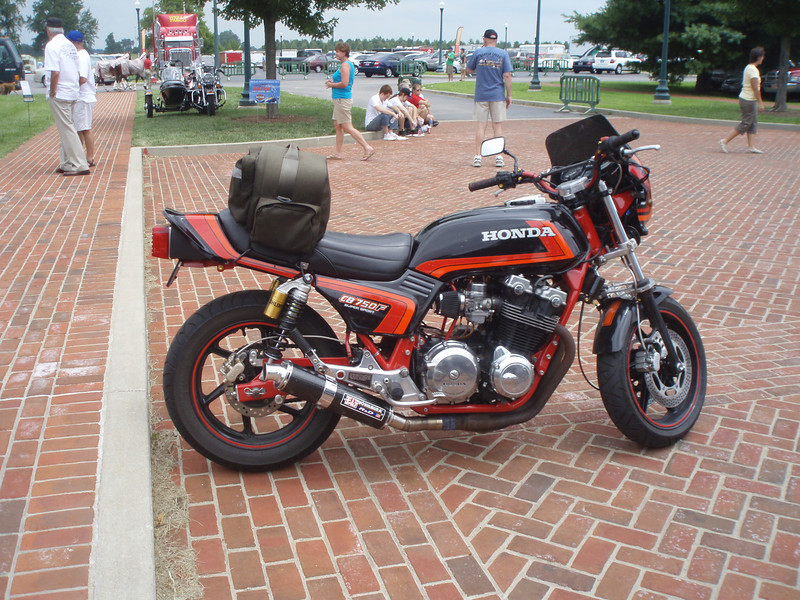

And now for some eye candy. Cheers

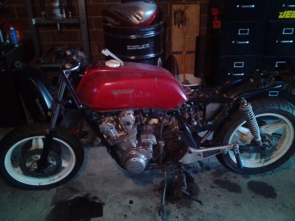

The front end came to together quickly as I used a 86 cbr600 front end utilizing a 1982 cb900f triple tree.
The first hurdle is the rear end as I need to find a cbr600 f2 rear as the early one, f1, uses a 17mm diameter axle and the length is to short for the stock swingarm.
The f2 rim supposedly uses a 20mm diameter axle which then the stock axle could be used and maybe I can just rob a f2 for the bearings so the rims match.
Dreaming of finding a cb1000 or cb1100f boxed swingarm, because that would be nice upgrade wouldn't it.

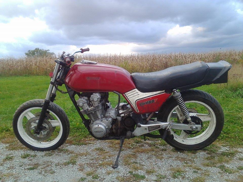

Some progress!
New rear wheel bearings and I scored a cb1100f swingarm!
Pretty sure Im going to cut that seat up and take out about six or so inches.
