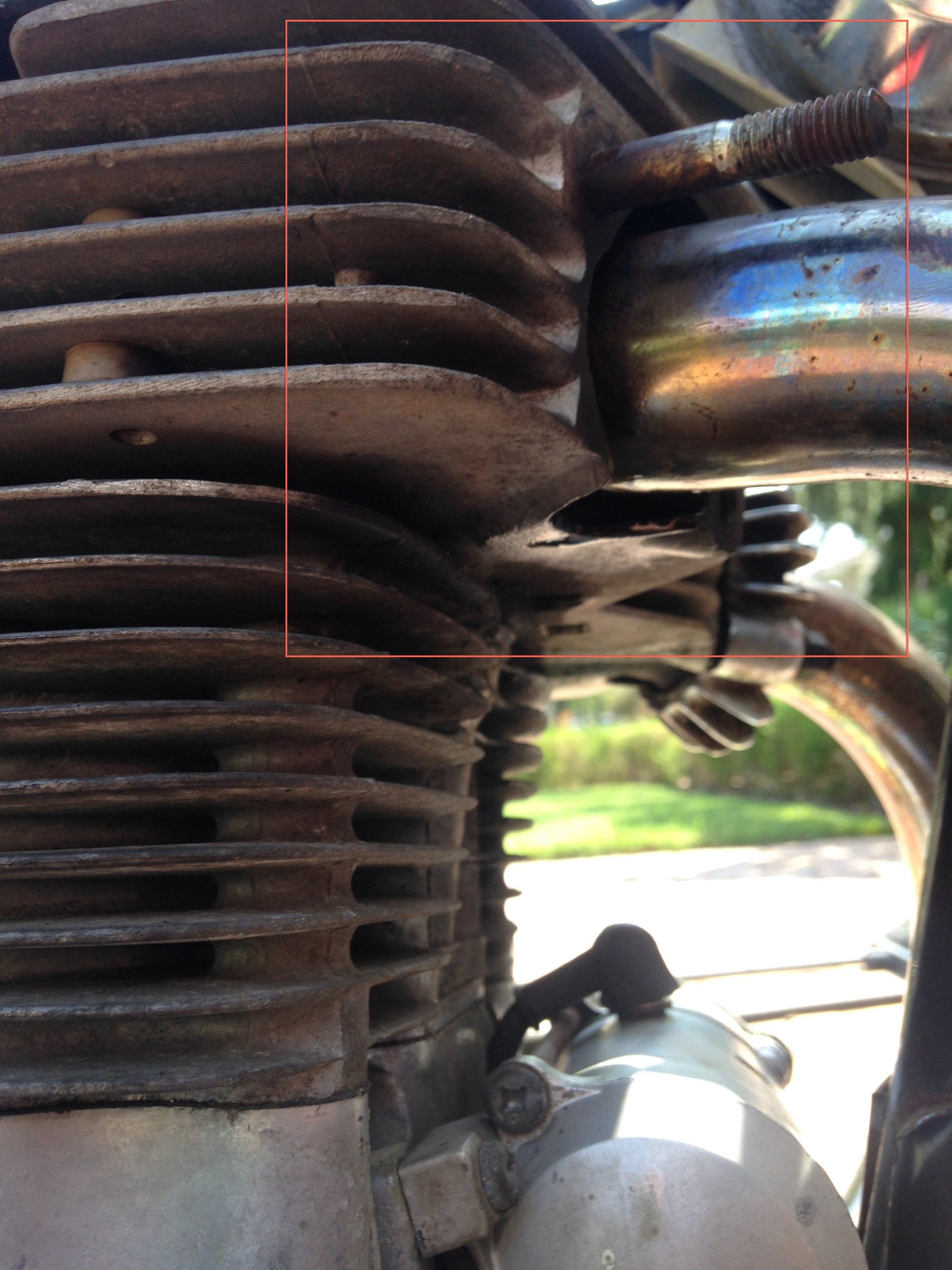

So i bought my first bike a few months ago, a 1972 cb350, but i haven't been able to put much time into it until recently. When i bought it the right cylinder wasn't firing but the left was. I checked the coils, replaced the plugs and the battery, and adjusted a miss placed wire. The right cylinder began to putt a bit and get warmer than before, but it still wasn't firing properly and getting hot like it should. After that, the bike wouldn't turn on at all. So I cleaned out the carbs and the bike fired back up. I noticed there was a big oil leak coming from a loose cylinder gasket on the left of the chain, near the gear shifter. I fixed that leak, but seconds after the bike started to drip oil from both the oil tank, and from the right cylinder head (picture below). What could this leak from the cylinder head mean? and does anyone know what i should do next to try and get the right cylinder to fire and to fix these leaks?
First Photo: Cylinder Head

Are you sure the one in the second photo is leaking? I can just see all the grime from the chain. If it is, its an easy oil seal that's not hard to get. Are you sure the battery is fully charged? Mine used to kill the right cylinder when it was getting low on voltage. Common on hondas. Also may happen if the battery you are using is too small. I would try to identify if its spark or fuel that's causing it not to run. Remove spark plug, connect to wire, and ground to head to see if that right plug is visually sparking. Then smell if fuel is present in the cylinder that's misbehaving. Id try these things since they are free before worrying about that head gasket. Then once the bike has warmed/run on both cylinders a bit consider a compression test to verify.

Oil leak might be the tachometer seal just above it. They commonly leak and the oil is tricky to be seen traveling down. Cheap part. I had a right cylinder that would be intermittent too. Think mine was a stuck valve, but you need to check timing and may want to swap left and right carb to confirm. Coils can be finicky of old but are rarely bad. If it's always cold and never firing I would be money on the carb.
