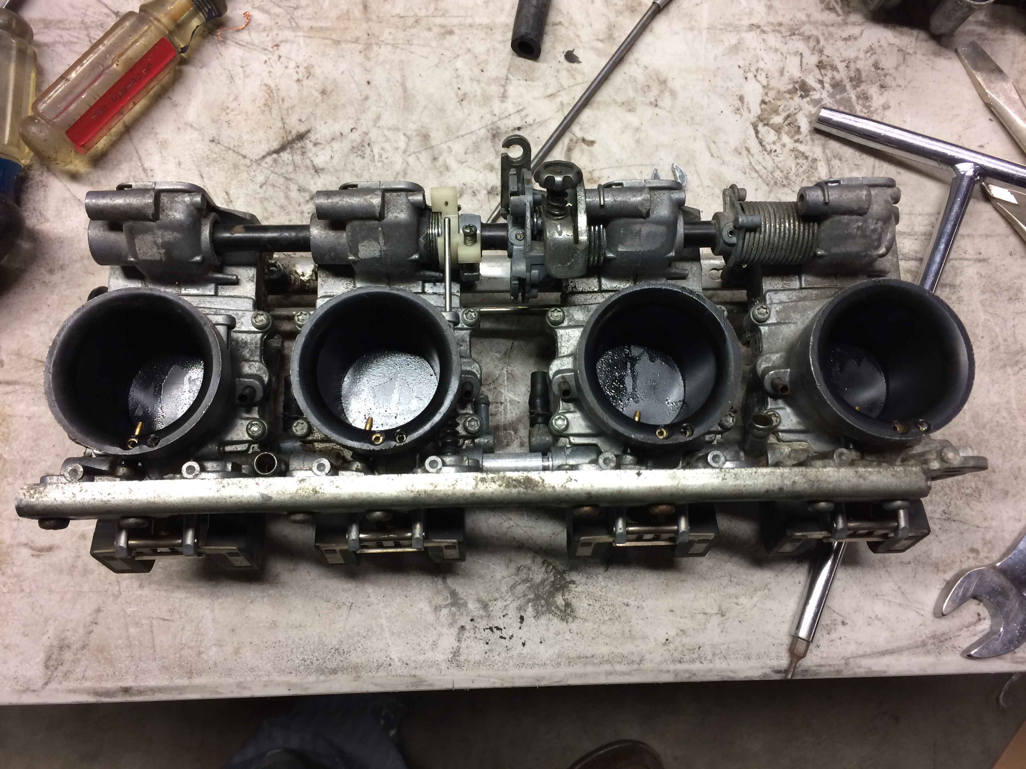

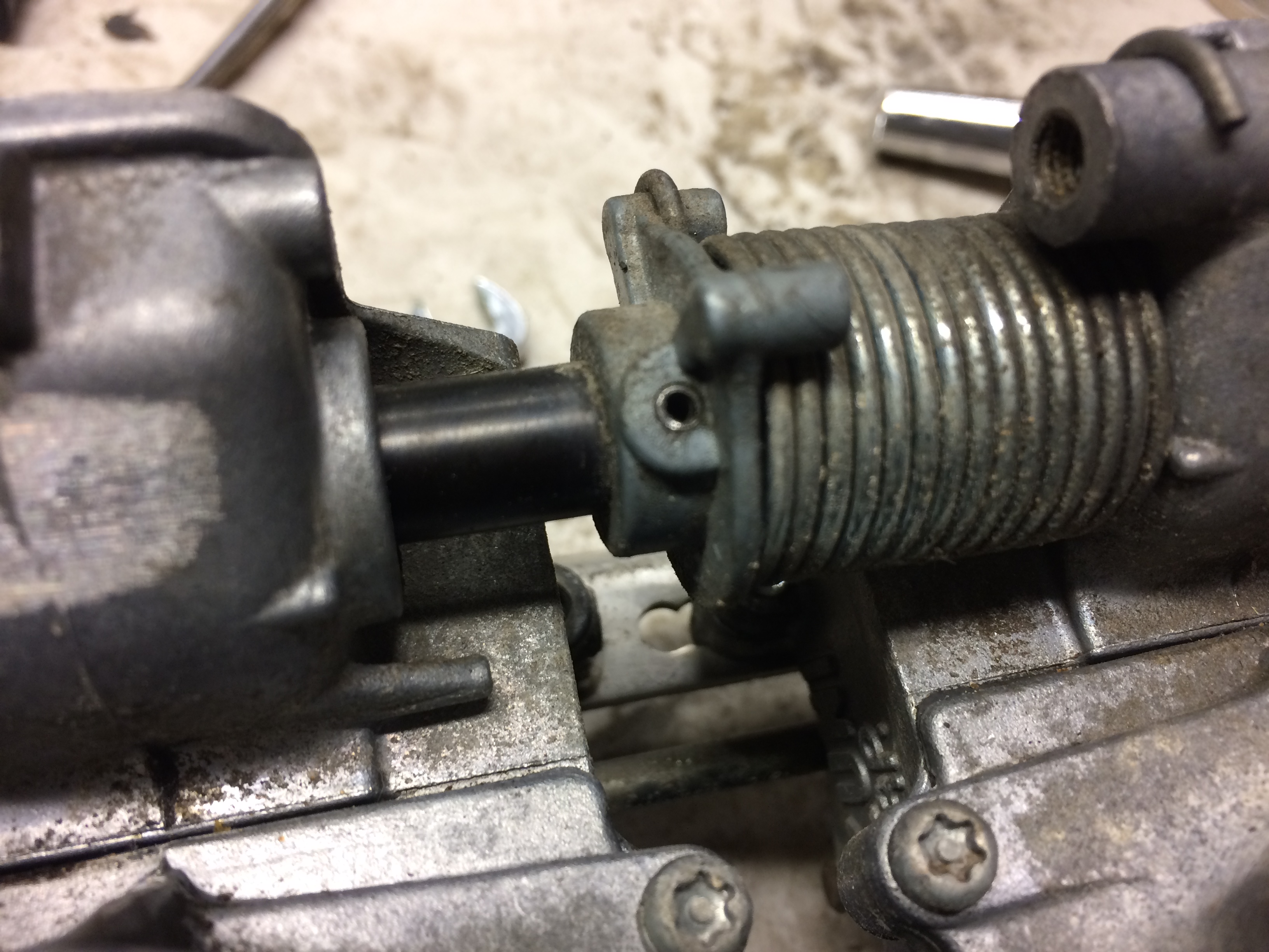

I hacked the wiring and it fired up with a squirt of starting fluid. I then pulled the carbs and suspecting they were super dirty, took them apart. Turns out they are RS36 flat slides. Nice upgrade for a hot motor. Also it appears the slide pivot shaft is held on with spring pins. What is the best way to remove these without doing damage? I really want to do a deep clean on these carbs because they are so dirty.

I just drive them out with a pin punch, but you do have to be careful. It's very important to back up behind the pin properly. Sometimes I will make a back up plate with a finger or arm that fits up into where the pin is out of a piece of steel angle or plate that I can clamp securely in a bench vise. Drilling a hole in it for the pin to pass through will provide good support so you don't damage anything. Getting someone to hold the rack accurately on the back up while you tap out the pin(s) helps a lot.

JP- made a finger and hammered em out. Worked good. Doug- I'll check out those calipers. I want to upgrade the brakes. It already has EBC pro-lite discs.
Carbs are disassembled, and I soda blasted everything and did an initial clean, focusing on cleaning out the needle bearings and regreasing them. Most of the rubber is rock hard so I will replace the o rings, and a couple other things. The header basically has barb wire holding things together and the back mount was held on with a piece of a door handle. I assume the primaries slip out of the bolt on flanges? Seems pretty stuck, but I want to confirm before I get rough with it. Literally every piece of the plastic including the headlights, seat ,and tail is broken or mangled so I'm chucking it all except for the upper fairing which I will repair. Yes those are wood screws.
That is exactly the right way to remove roll pins.

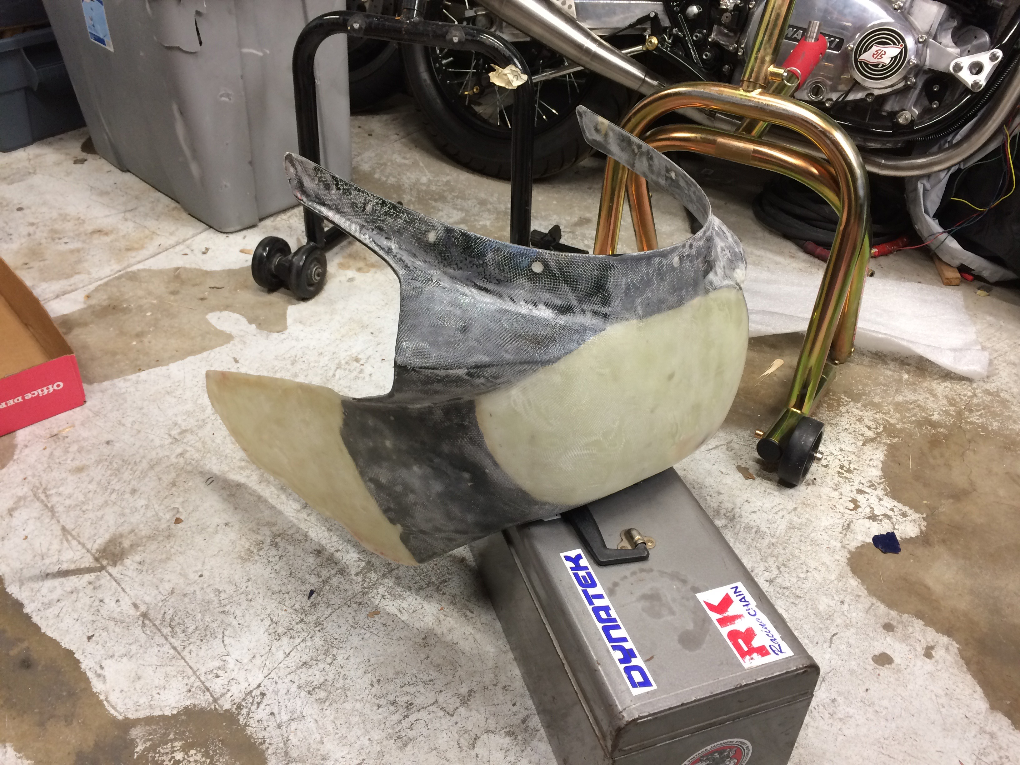

I decided to do the fun part first to get me motivated and give direction to the whole thing.

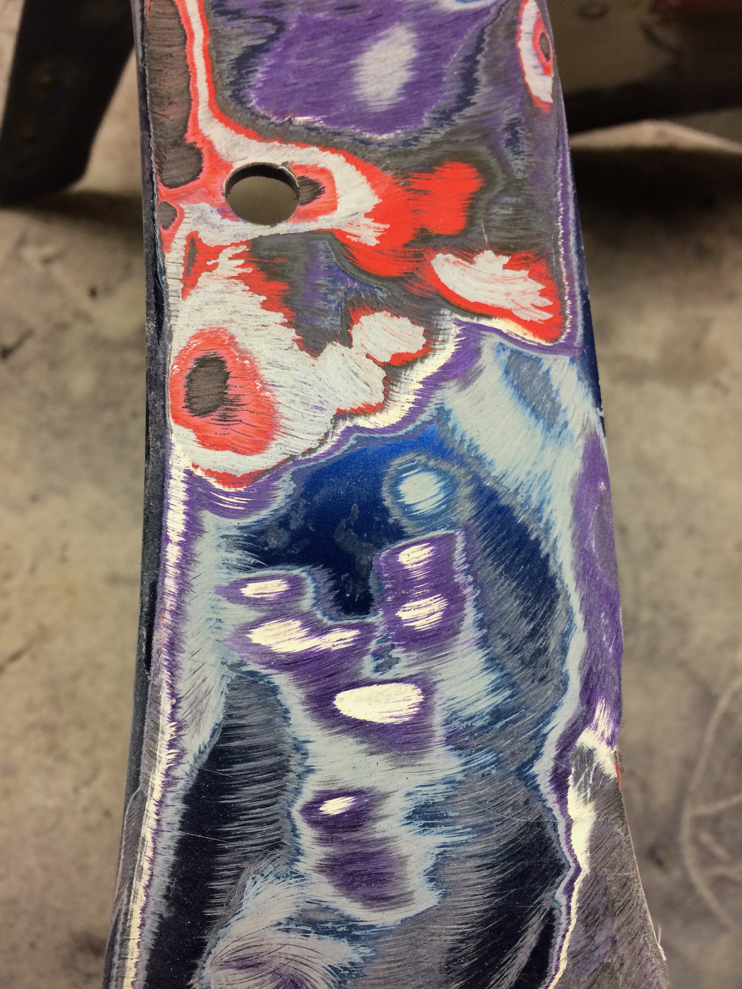

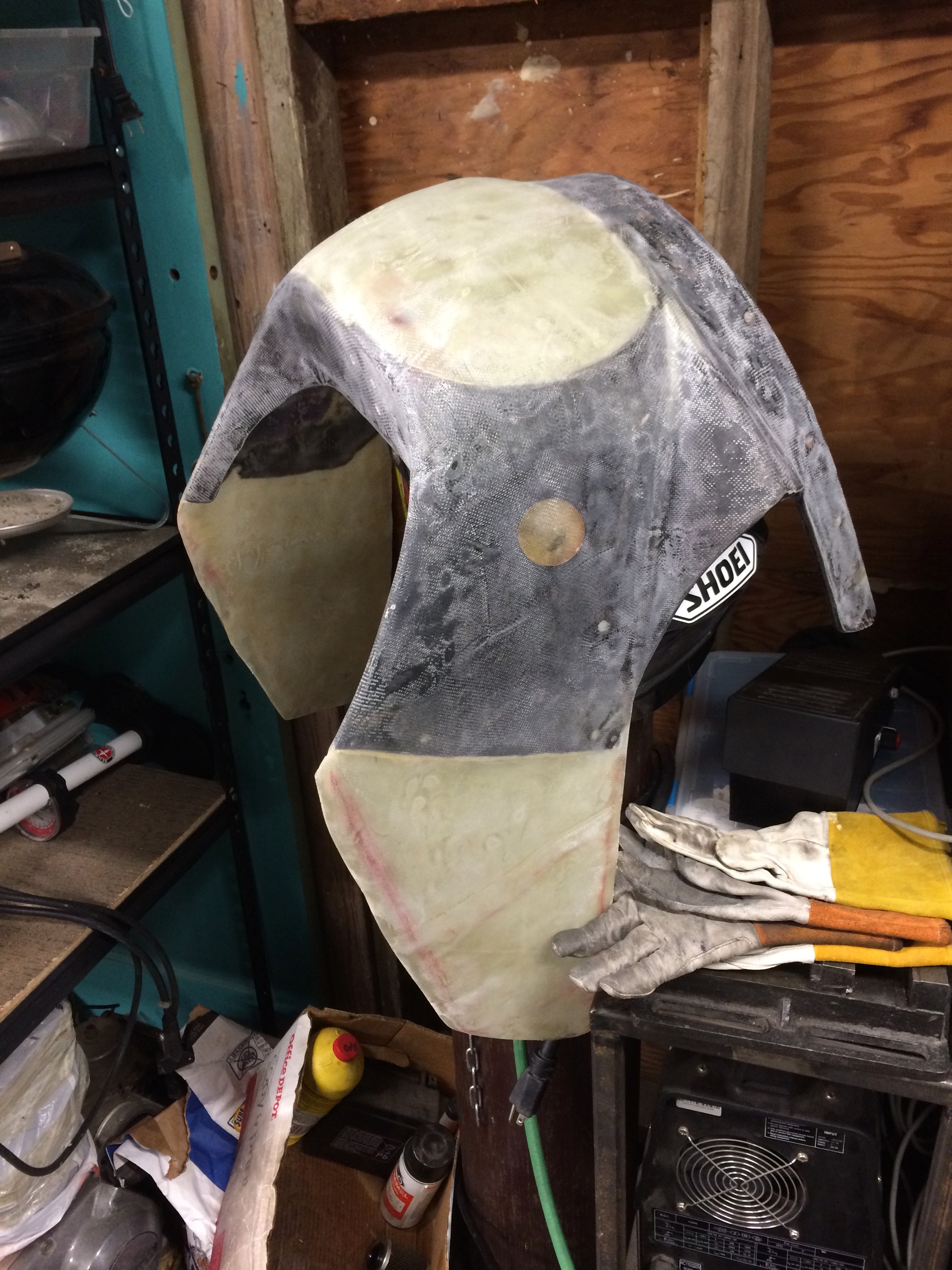

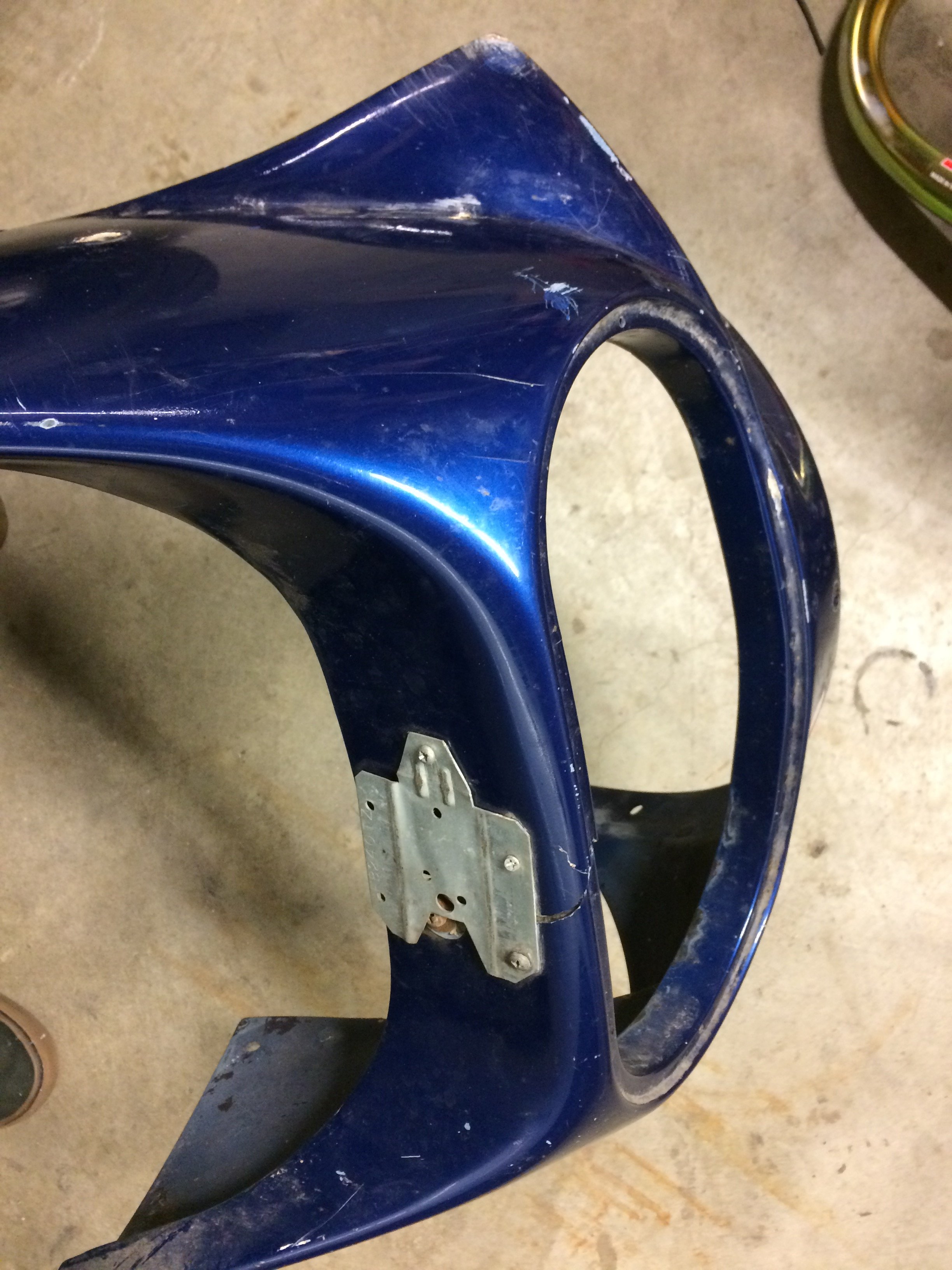

Started sanding the fairing down to bare plastic, there had to be 1/4" of paint on this thing. once I had it stripped bare I realized this fairing has been repaired many times and was cracked everywhere. Coincidentally my dad recently finished building a wooden kayak and had a bunch of resin and fiberglass leftover that he offered to me, so I got creative. I made a crude jig and mounted the original fairing on it then filled in voids with clay. I also did a thin final layer over the whole thing inside and out to seal in the original fairing because I just kept finding new cracks.
I'm going to use a 4.5" Harley headlight with a custom bucket i made years ago and never used. Offset, endurance style; i rounded over the opposite side of the fairing as well to compliment the look.

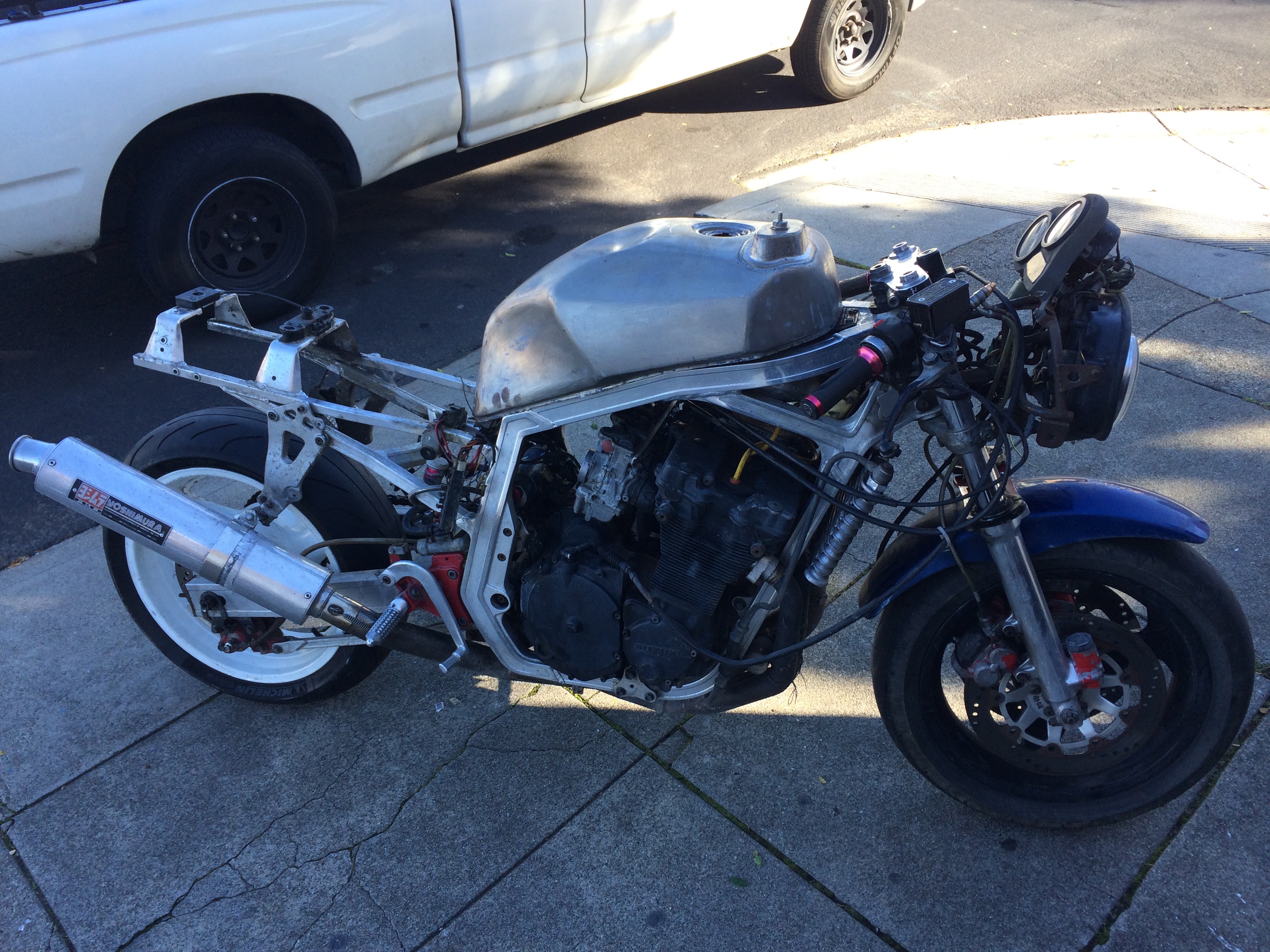

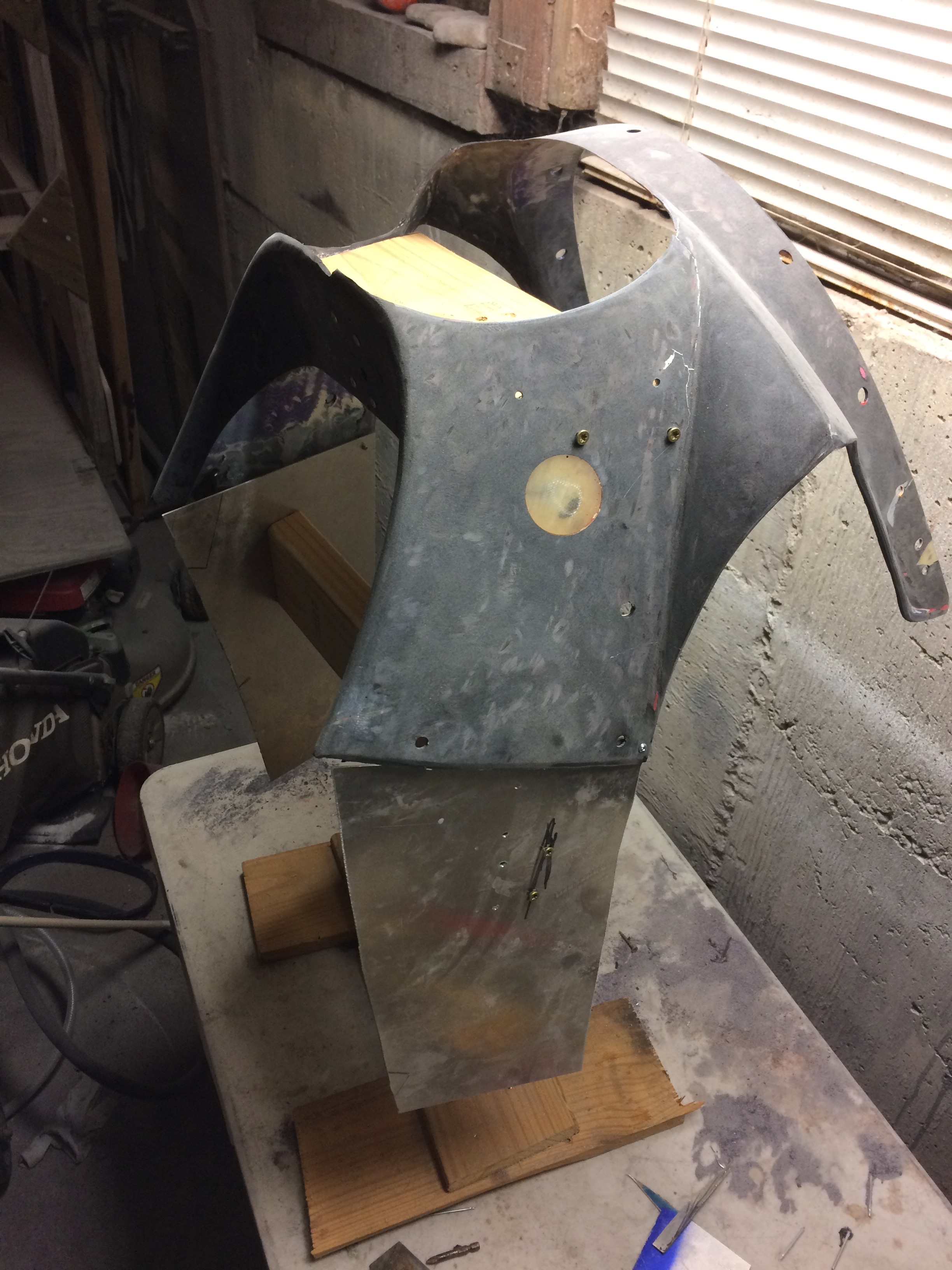

Im going to try something I have never done and fabricate and aluminum rear cowl. Needs some bashing and trimming but its getting there. Total cost of the cowl with stick on seat will be about $40 depending on how much I spend on fasteners.

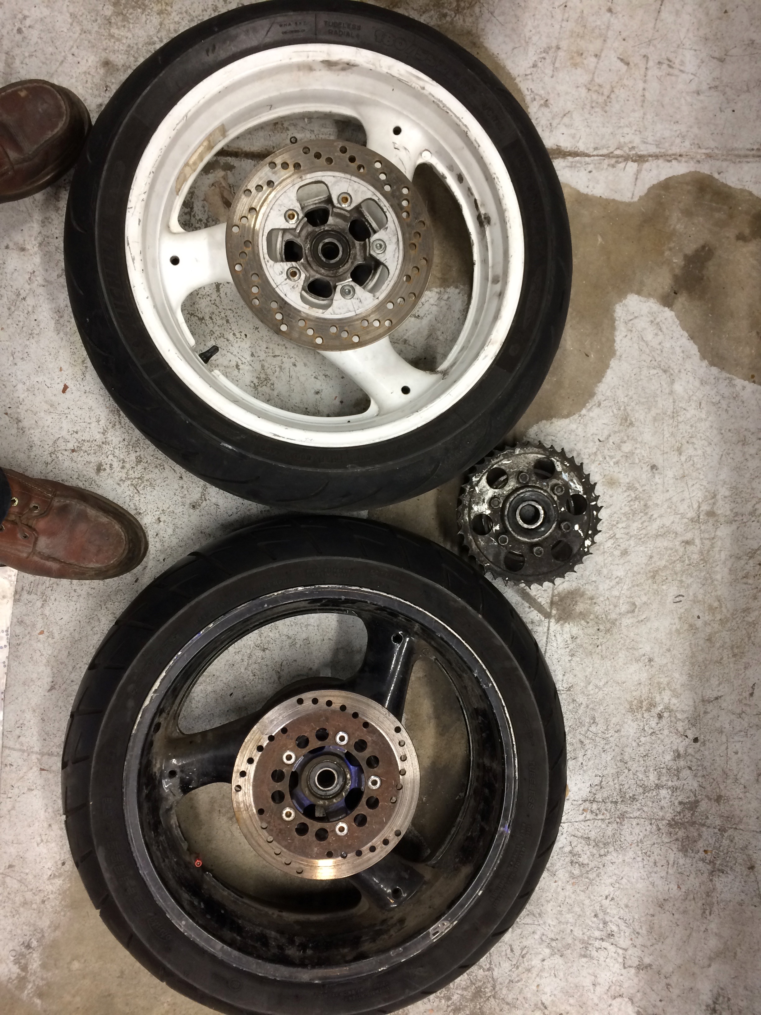

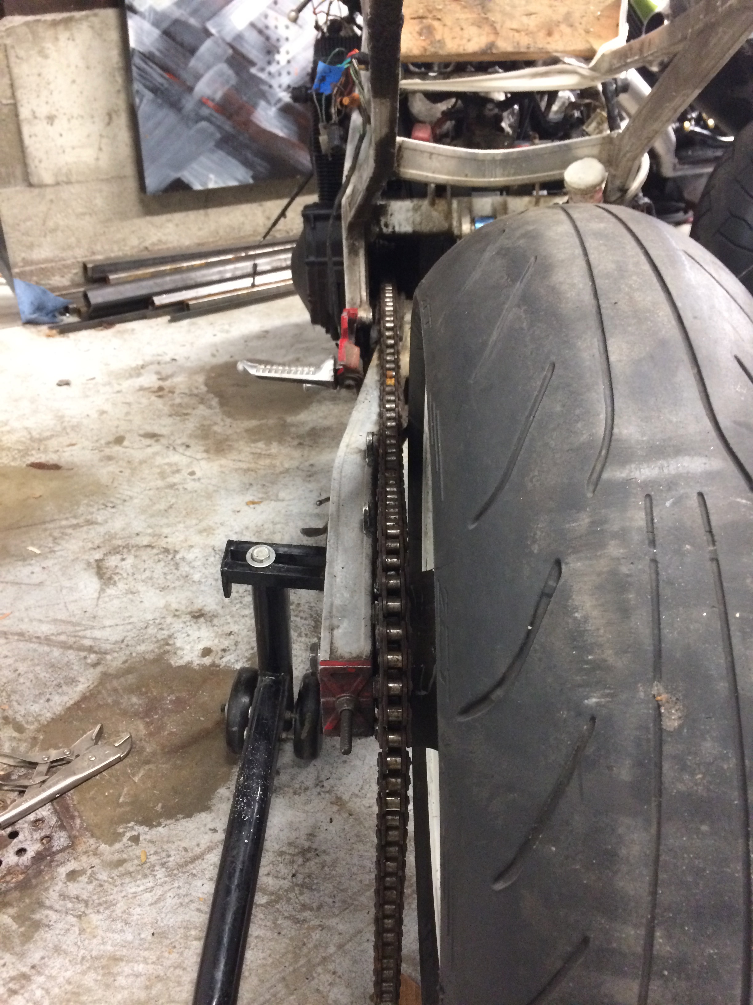

I had time to inspect the rear wheel. There was no spacer on the sprocket side except a steering neck lock nut that was doing absolutely nothing as the sprocket bolts were grinding on the swing-arm. I have a 10mm thick 20mm spacer that came in the box of parts that fits in the rear wheel dust seal perfectly. However, when the rear is assembled with that 10mm spacer there is not enough room on the other side for the remaining spacers. Is it possible the PO assembled the rear wheel without this spacer at some point and cranked on the axle hard enough that the swing arm bent and now the spacers wont fit? I got two wheels in the deal they appear to be identical, except with different disks. One is missing a bearing and the bearing spacer, and the other needs new bearings completely. Also the stepped spacer that goes in between the sprocket carrier and wheel is missing.

Pete12 said:
Great job on the rear cowl. Is it all one piece, except for the seat base of course?
Im just getting started on the rear cowl, I only bent up one side so far. The camera makes it look more complete than it is. ultimately I think it will be 5 pieces total.
