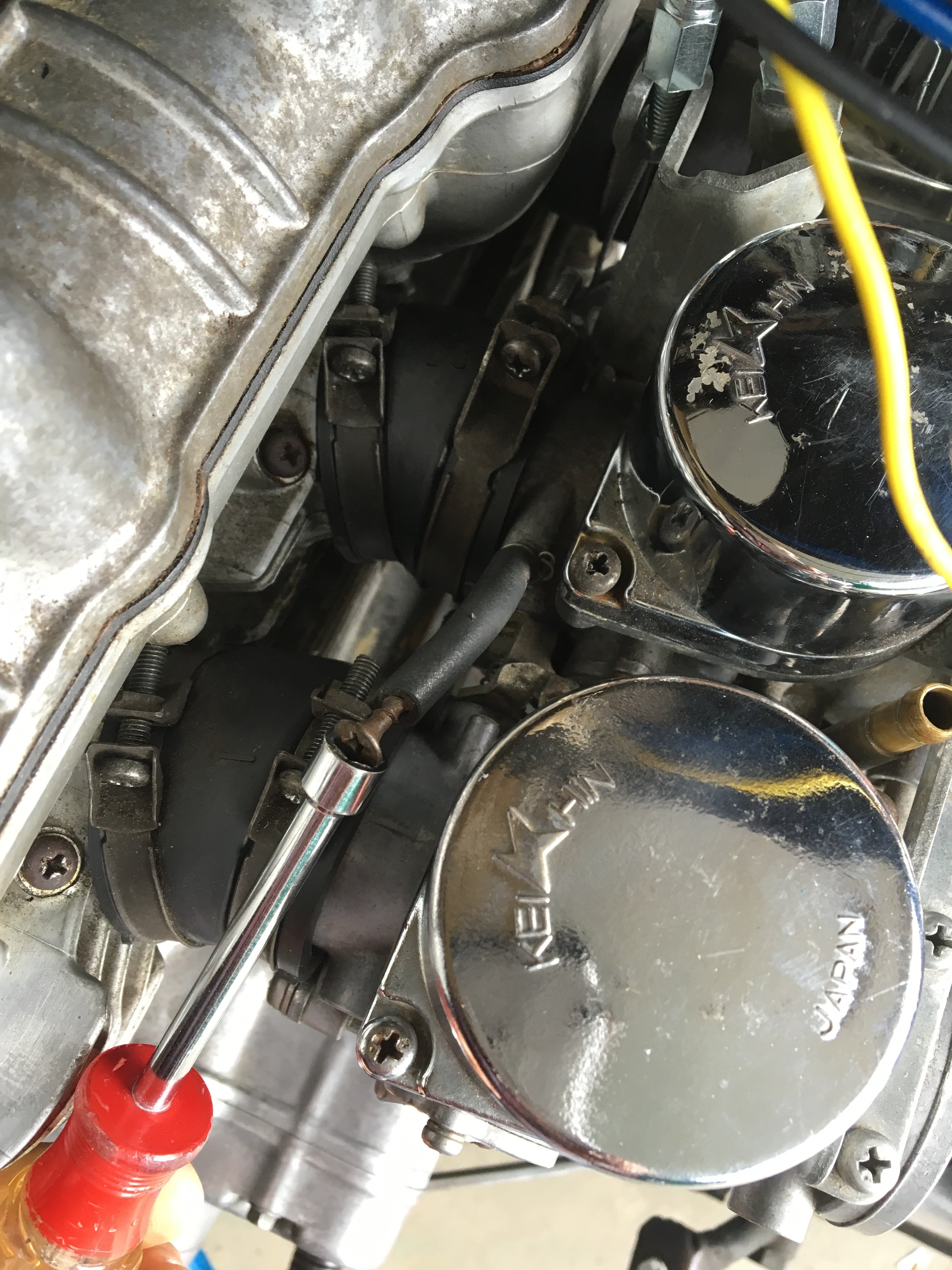

Can anybody shed some light on where these vacuum lines go to? Its an 81 cb750c that was partially disassembled when i got it. The honda pdf's available arent very descriptive.
First pic shows the hose coming out of the air joint btween carbs 2 and 3 and bending down almost like an overflow tube. Is this right?
Second hose has the screw plugging it on the picture in front of the nutrunner. Its at the front of carb 2.
At this stage im trying to just her running. Still deciding between a breadbox or K&N pods if that makes a difference.

1st hose is a breather for the float bowls (don't plug it).
2nd is for a vacuum fuel tap (plug it if you aren't running a vacuum fuel tap).
