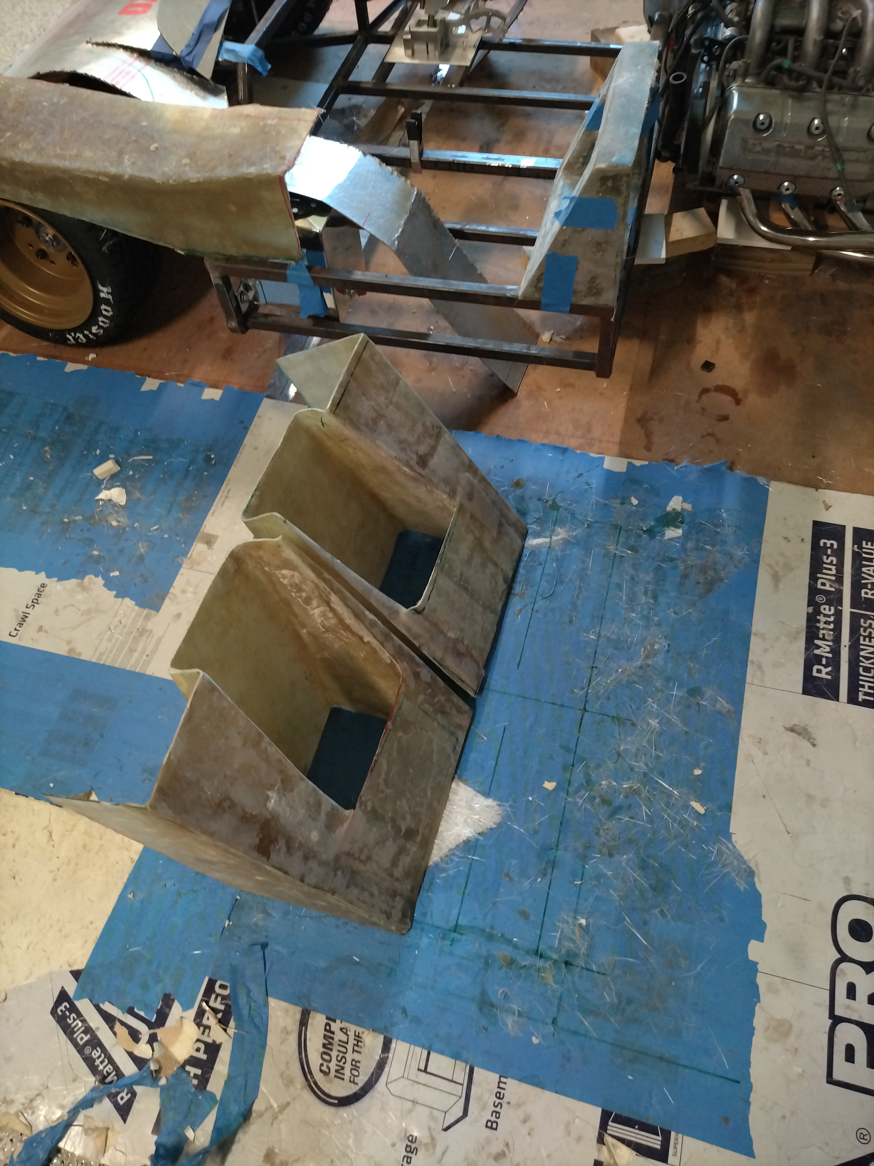

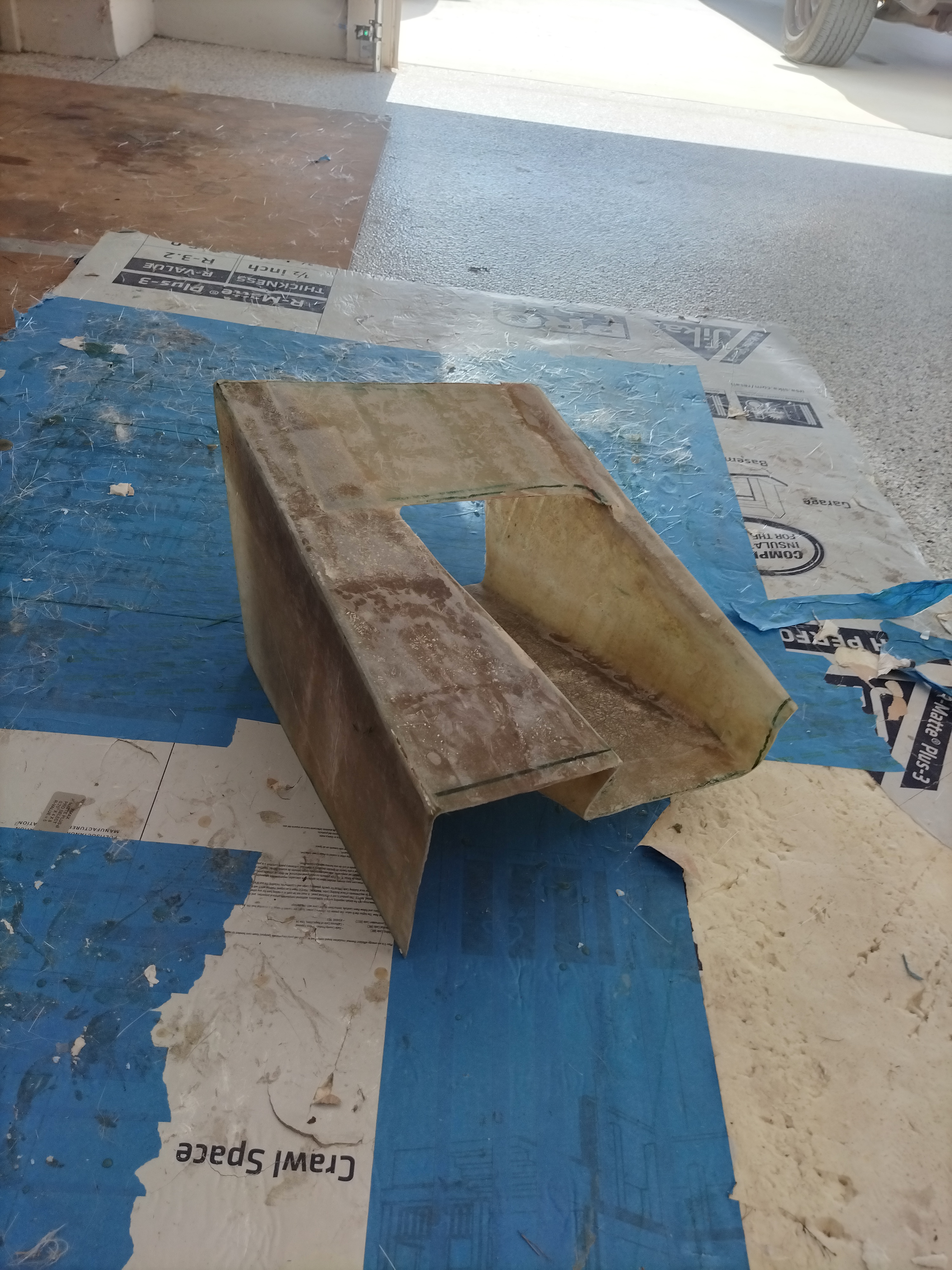

Good deal! It's good to be back doing this kind of stuff. It been years and I had forgotten how much I love this .....and hate it!! Forgot the feeling of being itchy with fiberglass!!! Started really working on the body this week. A little frustrated that the radiator housing are about 1/2 in to tall but not a big deal to trim and redo a few angles. The rear end is a little tricky but I am using a Polaris sportsman xp1000 differential which has roughly the same HP and torque as the wing. My first glimpse of the shape

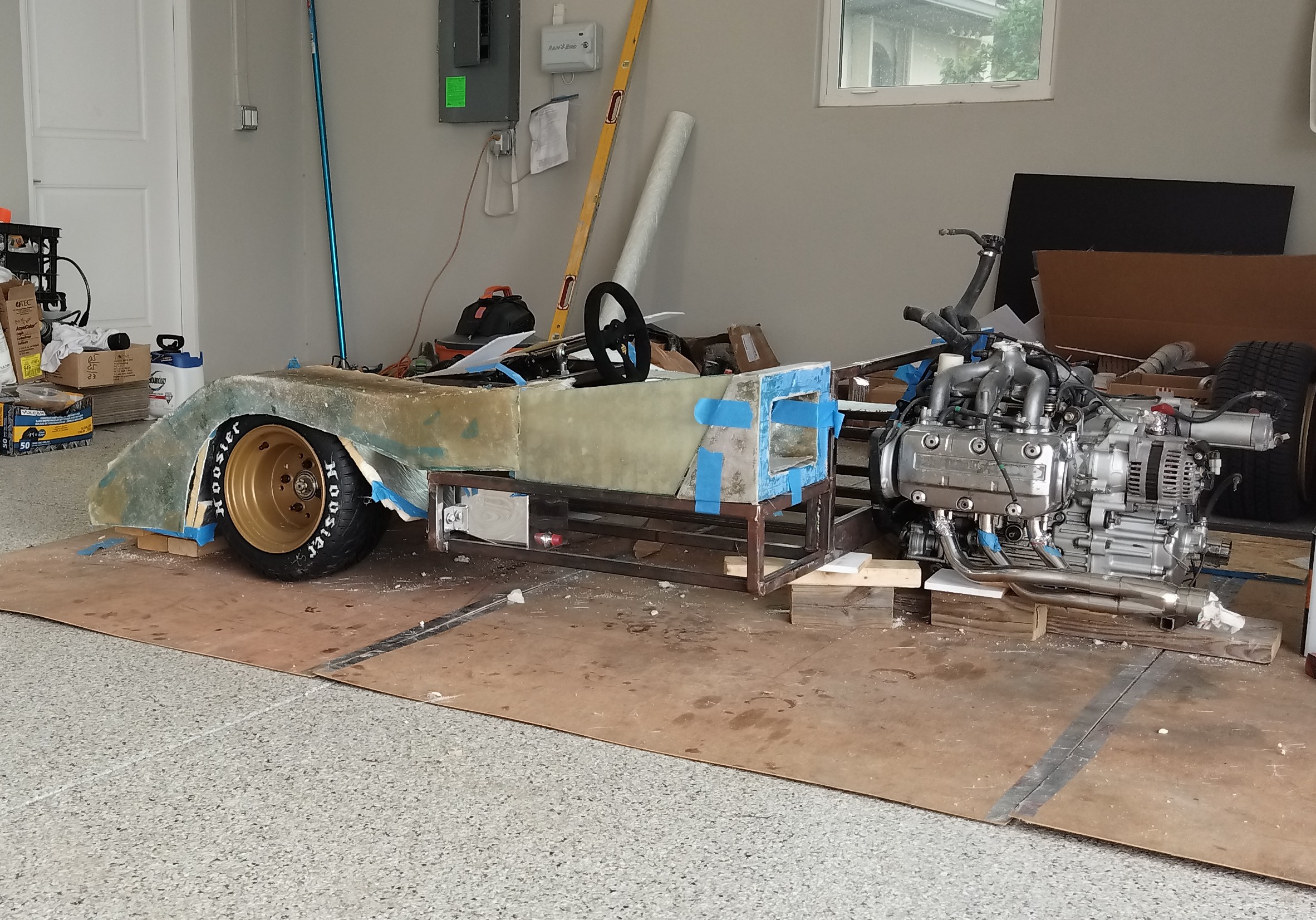

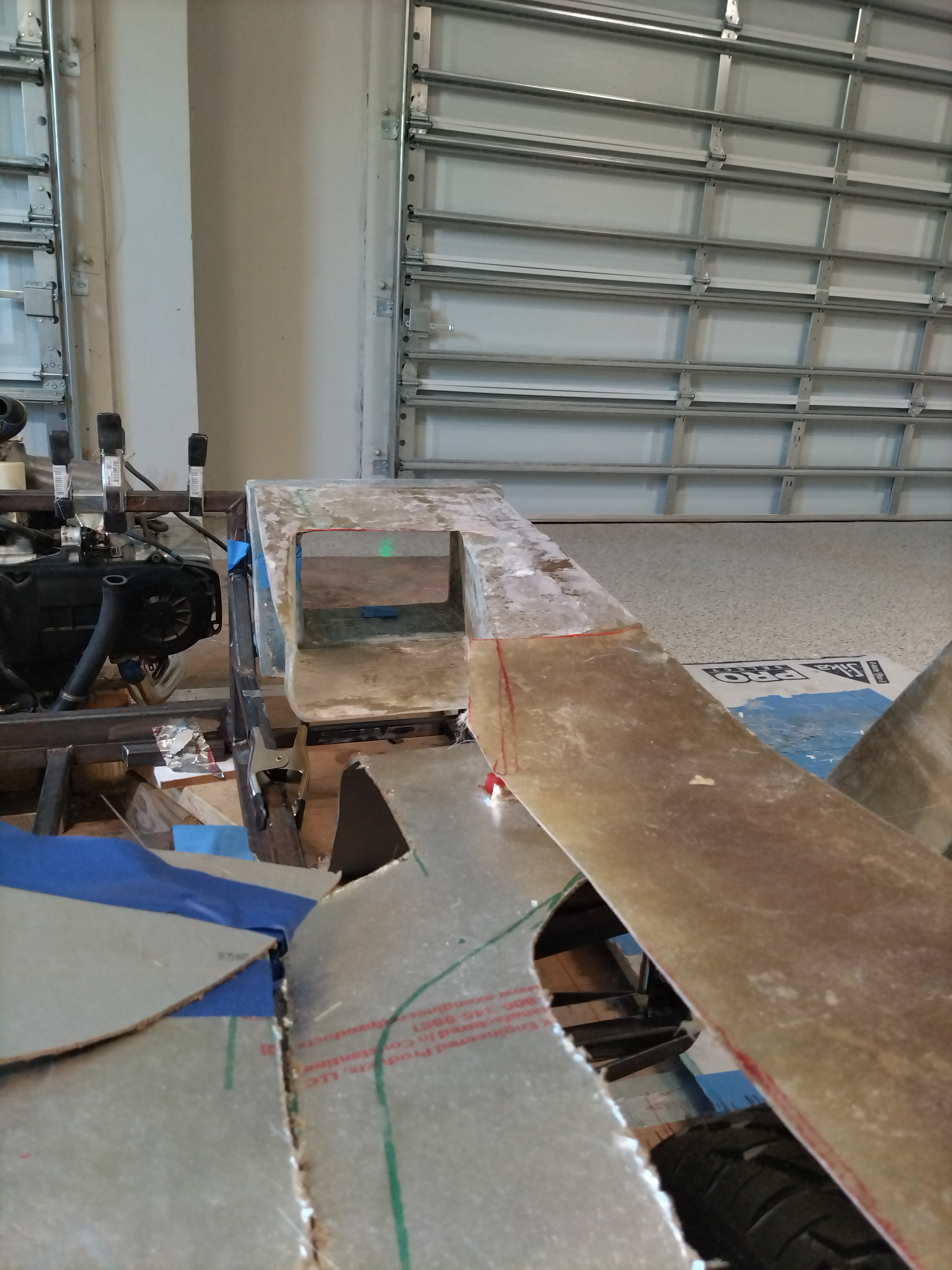

No major updates but was able to rough the doors, which was a major pain!!! A few tweaks and add the upper side screens then on to the front. I am waiting for the machine shop to finish the drive shaft that is why I am doing all the bodywork first. Rear arms, hubs, and brakes will be from a Polaris sportsman 1000. Steering is just a standard buggy rack and pinion.

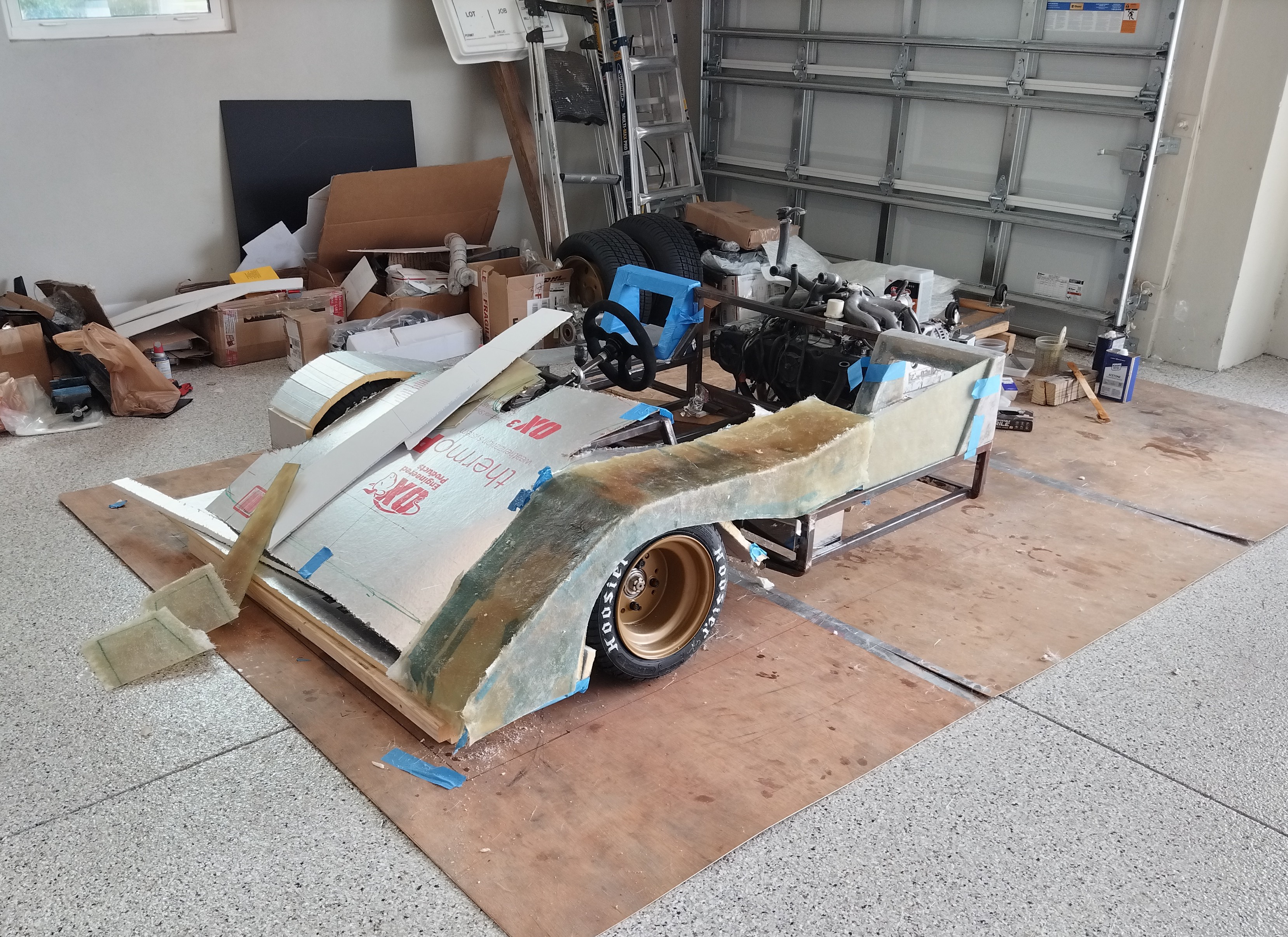

I originally set out to do the later version, but I had piece of foam board left over that was about the right size and set it up and liked the simplicity.
