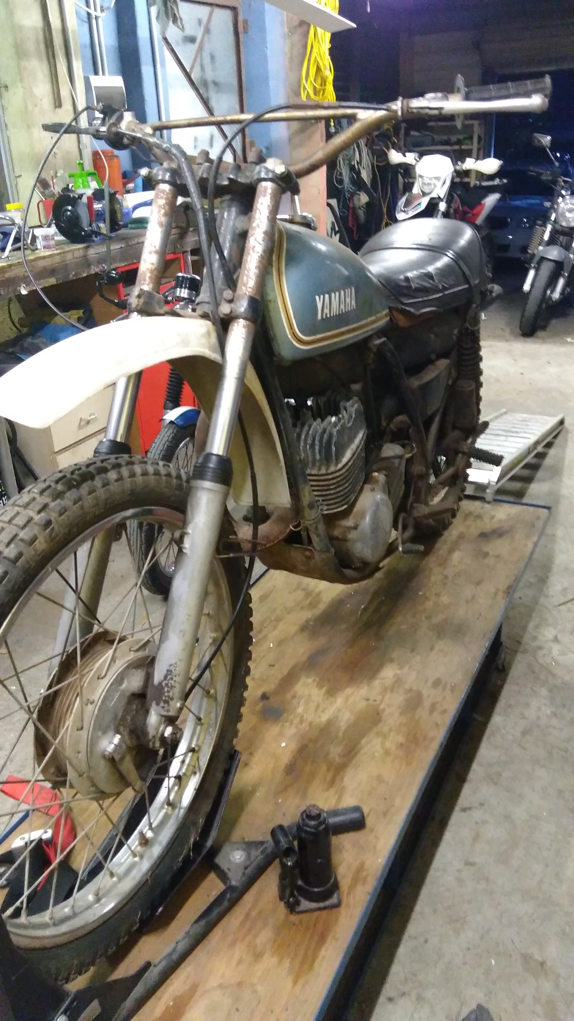

I brought this DT250 a few months ago and have had it in the shed while I finished my GT185 cafe racer.
Looks like it is a 1974 DT250A. Picked it up for $650 which is probably a too much for what I ended up with. Anyhow, its pretty complete, the engine turns over & has spark.
I want to turn this into a tracker, as per the reference image. A bare bones bike with nothing on it that it doesn't need. Will be road registered and I plan to ride it regularly.

Found some time on the weekend to add a fuel filter, reassemble the carb, adjust points and kick it over. No good, the spark is not consistent. Will need to delve further into the electrical. So I decided to pull the top end off.
Ugly. Will need a rebore and piston. Good news is the bottom end is clean and appears to be in good shape.
Time to order parts while the bore gets done!
