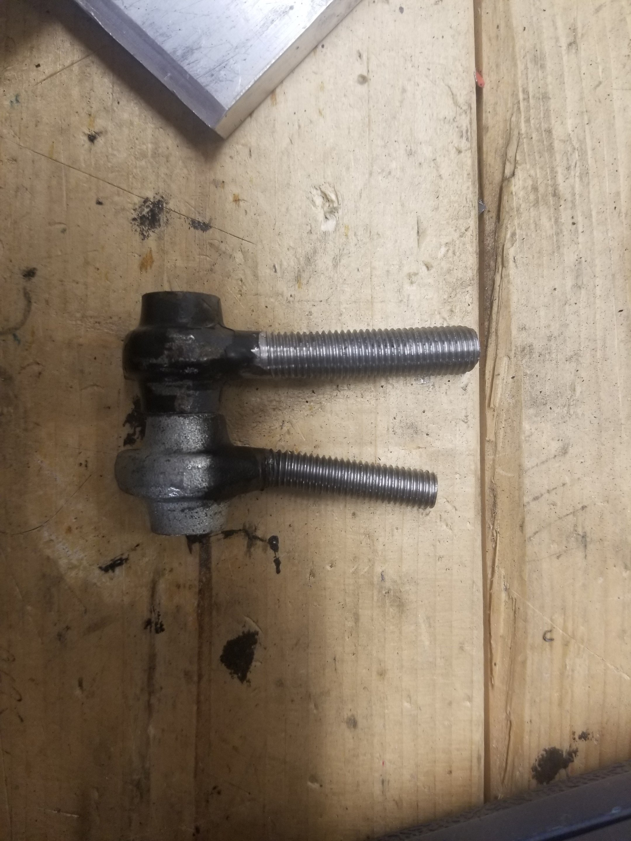

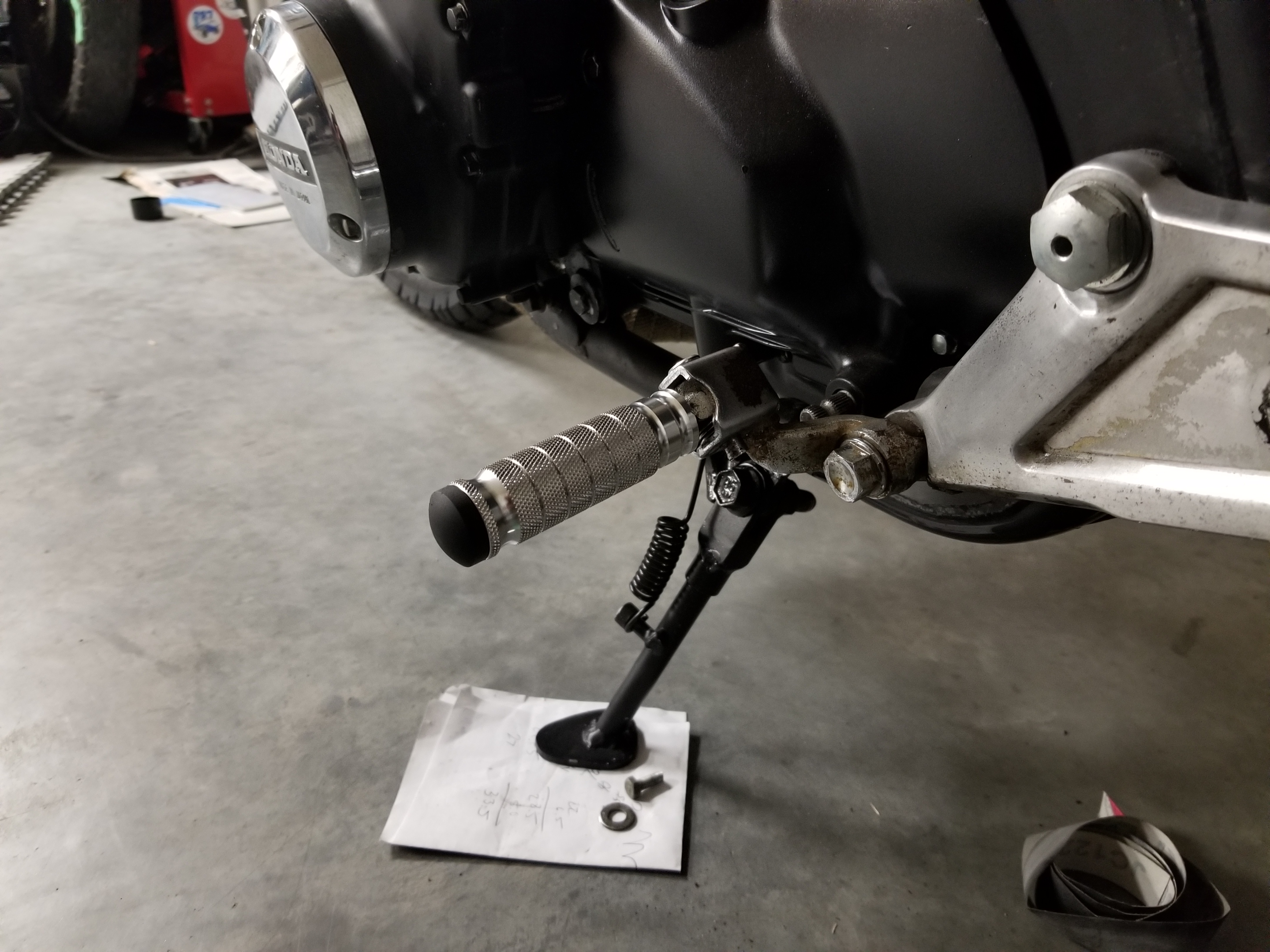

So, for anyone interested, I ended up trying these. They are not bad!
On the passenger side I cut off the original peg, ground down flat and drilled through the old weld where the arrow above is pointing. This was harder than it looks. The weld area was extremely hard to drill through. Looks like the heat really hardened that spot considerably.
The thread depth on them is probably 1" or 1.25" so should have plenty of hold.

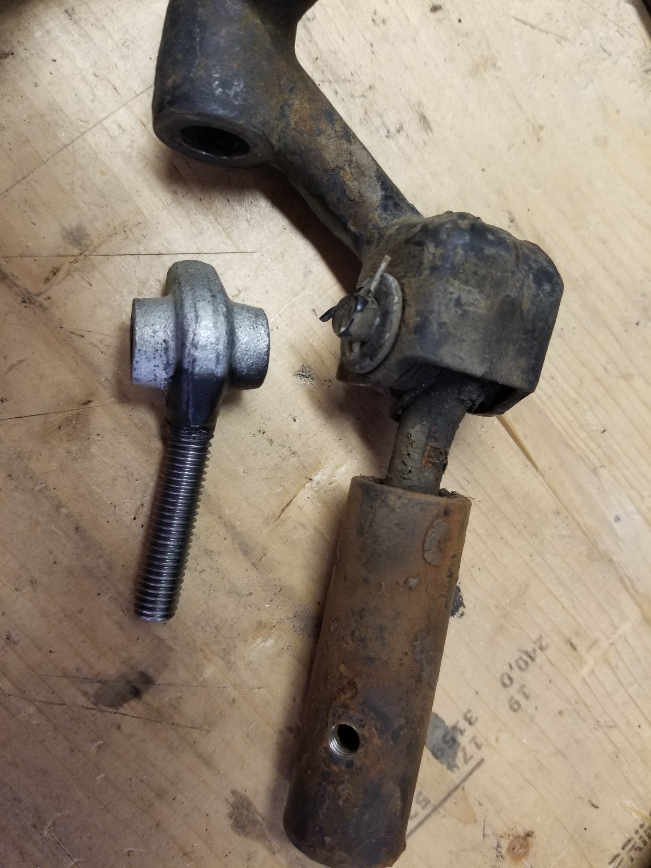

For the left side, I cut the peg, shaved it down to just over 8mm on the belt sander, and then threaded the piece itself.
The OEM setup has thick rubber outside and the pegs themselves are suspended in rubber , so I assume the new ones will transmit more vibrations but they look MUCH better

Granted, I did sand them down from ~10mm to ~8.3mm in order to cut the m81.25 thread I needed.
That cast piece is probably pretty soft and seems a bit spindly for this application. Have you tried jumping on the pegs?
I jumped once and they folded like they're made of butter lol!
I guess shaving it down 2mm did weaken it too much. Or perhaps the stock ones being suspended in rubber takes some of the shock away. Really didnt expect them to be that weak.
Heres a pic next to another stock one I have.
Back to the drawing board. Any ideas how else to make the left side work?

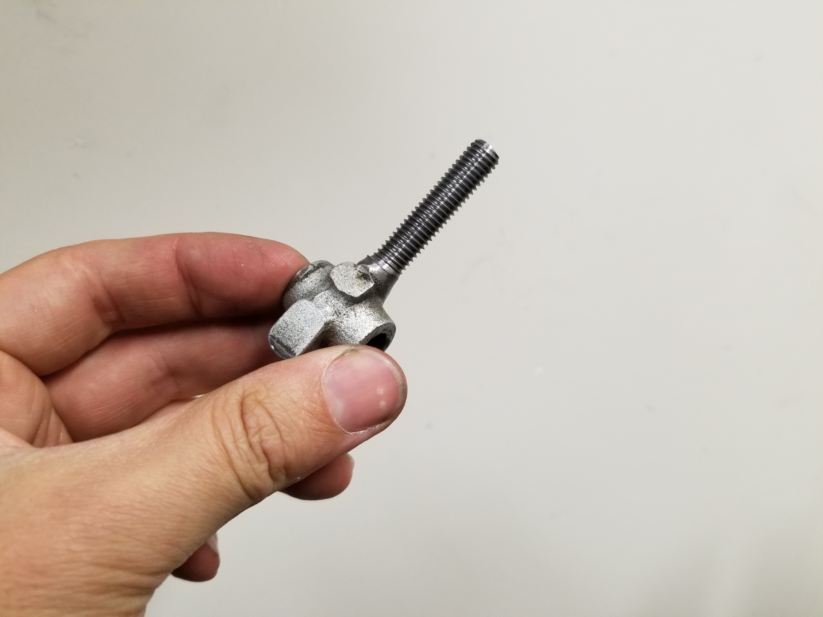

Since I already had another stock left side peg, I decided to try it again to M10 this side.
So, I will run it this way until I find a good OEM alternative to swap out on both sides.
These will do for moving the bike around and some test rides. I'll swap them out by the time bike goes on the road.
