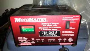

so i managed to get a hold of a motomaster battery charger (will post up pic) and decided to try the process on some small parts prior to giving it a go on the tank just to make sure it will work. after much research, I felt I had the set up correctly with the positive to some metal wire that was wrapped up to the parts to be cleaned. then the negative to separate steel in the water not touching any of the other metal in the water or hanger. set it to 12 amps and let it sit over night...this morning...hardly anything had been done...if any... so my question is am I doing this wrong and if I just hook everything up to the tank with this style of charger is it going to work?
my set up on the tank will consist of a hanger through a spray cap not touching the tank which the positive will attach to. the negative will then attach the the tail end of the tank while the tank will be filled with water and some Arm and Hammer washing soda.

You can't use straight water for this. You need an electrolyte (a liquid that can carry current). Put a couple of tablespoons of washing soda (aka soda crystals aka Sodium Carbonate) into the water before giving it a go.

Sorry forgot to mention that I did use Sodium Carbonate in the bucket of water.. my fault :)
Also sounds like you have the polarity wrong. Positive wire should go to your sacrificial anode (I use a bit of rebar because it's cheap and plentiful) and your negative wire should go to whatever you're trying to clean.

Exactly as I was going to say...............you had the cable affixed in reverse.
