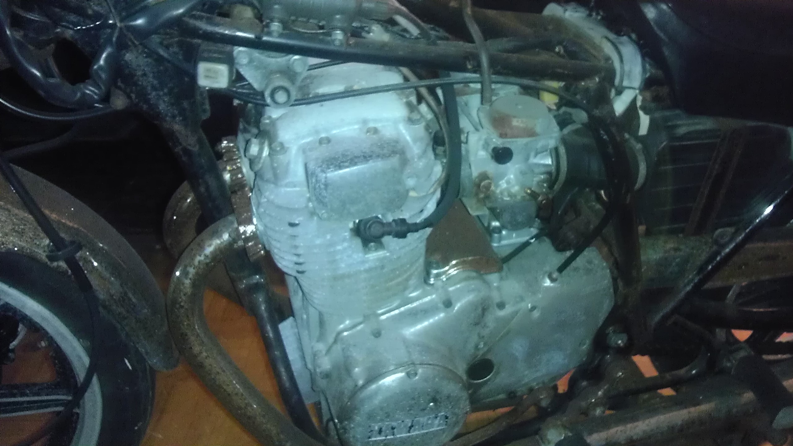

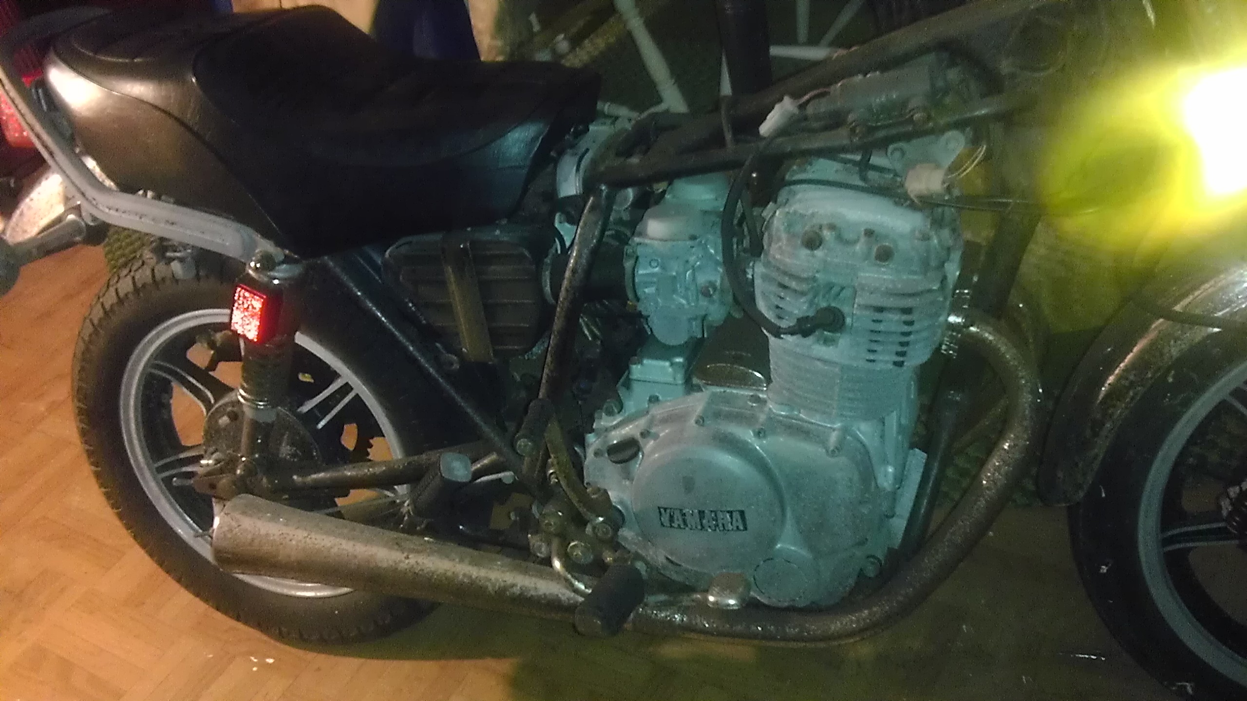

Alright guys, I went and got it. Little more rust than I thought.. :o oh well though. Wherever I read that it's a direct swap, is wrong. Lies lies lies. Those bastards. Now I have a decision, to go through with the swap the like other guy to the 400, or just fix this one and lower it a lil (it's just a little too tall). Anyway, here's the pics! Enjoy and as always any opinions are not only welcome but appreciated!

Rust? Where? Compared to the rust bucket my GS650G project started off as, your 400 is not that bad! I set up a soda blast cabinet for a few bucks where I can do both soda and glass blasting to get rid of the old finish with soda and the rust with the glass. Get some Evapo-Rust and start soaking the hardware in little cups (I mark plastic beer cup which parts are which) and it works wonders.
Build up the 400 while you're riding the smaller one.. hey next thing you know ya got two bikes in the barn ;) "But honey, it followed me home.. " Luckily the wife doesn't come to the shop often so she doesn't know what's in here.. ;)

Oh man I can't imagine a front tire blowout..must have been somethin else! Thanks, I like the looks so far! Started working on it, can't find any of my 10 mil sockets so I wait a few days..
