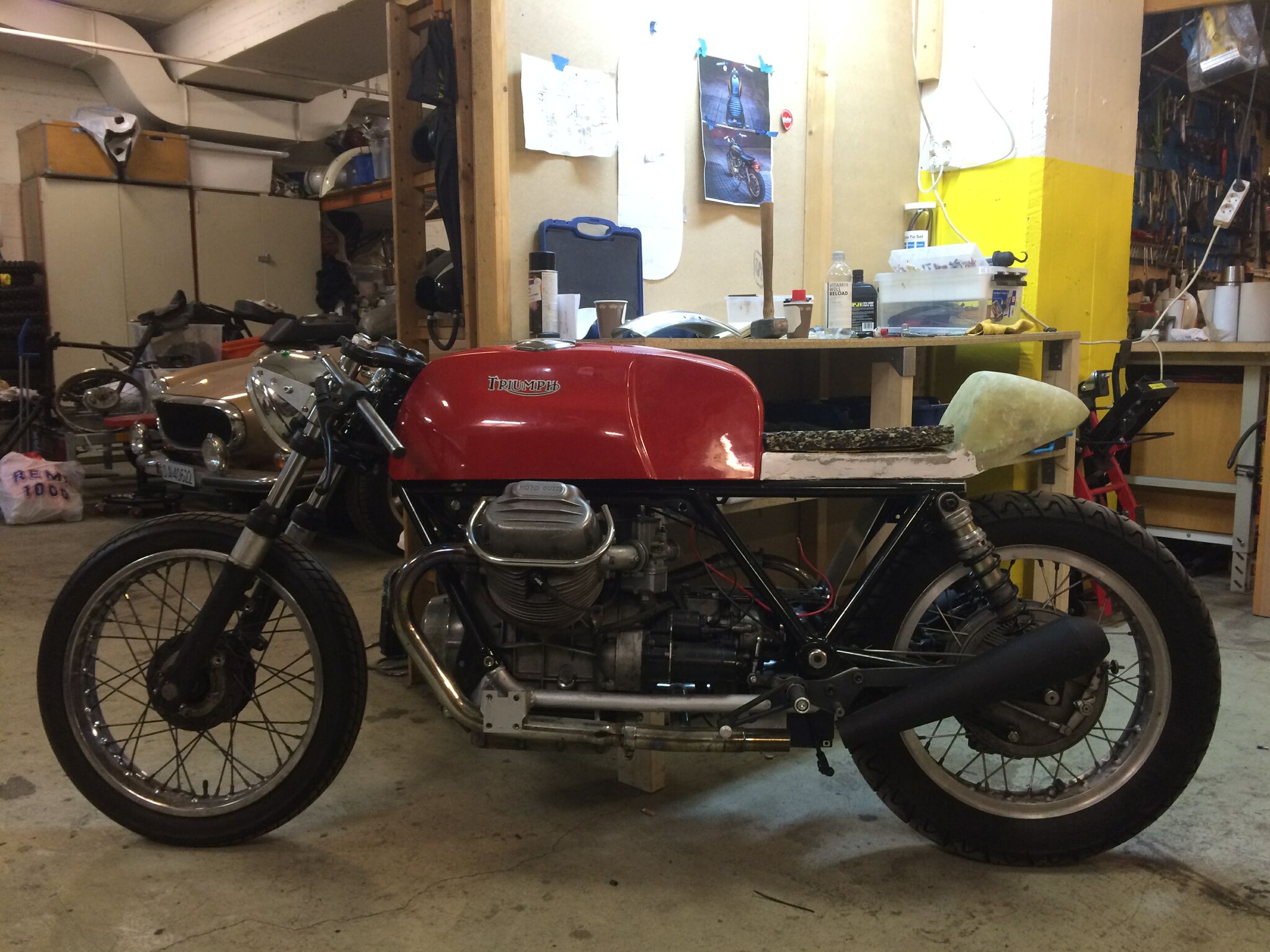

Ok. So I received a really nice Rickman fiberglass tank from a friend. The tank had been saved from the trash, but was complete and didn't leak. I cleaned it out, moved the petcocks and made it fit my Guzzi frame. Now, having almost completed the whole bike, I opened the cap and the smell had a note of not only petrol, but also something epoxyish.
Are there any chances of saving the tank? Or is it even damaged? Will a sealer even work? What to do?
This sucks major a$$ as the only thing left is to clean up the exhaust, paint the bodywork and drive.
