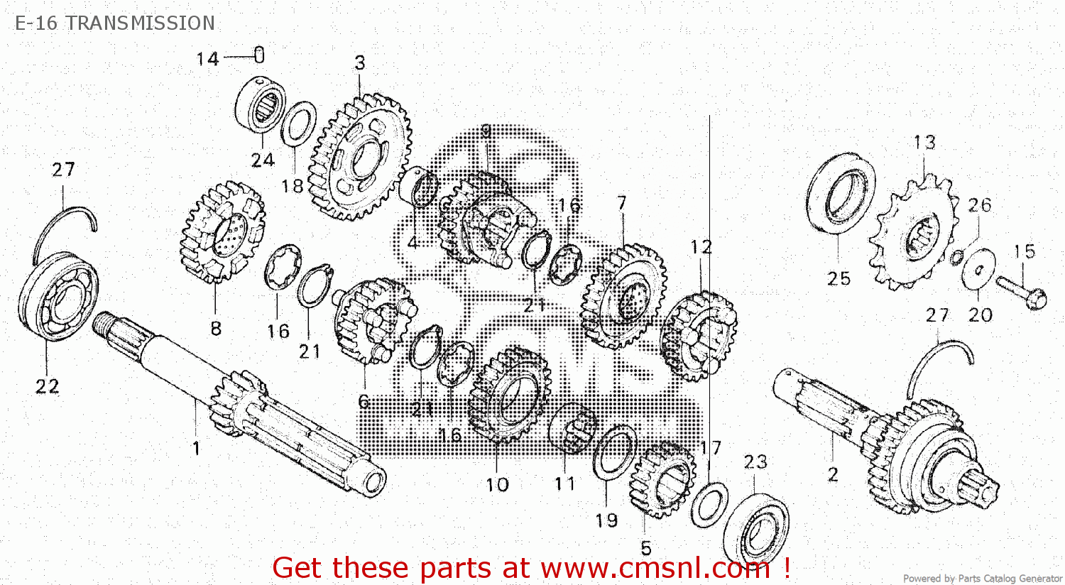

Near as I can tell this is the diagram of the parts. You sheared #15, it's still threaded into the countershaft (#2), but if you press on it, it actually moves further into the countershaft?
Not sure I understand this part. If it's threaded, it shouldn't of course be able to move in and out without rotating it.
