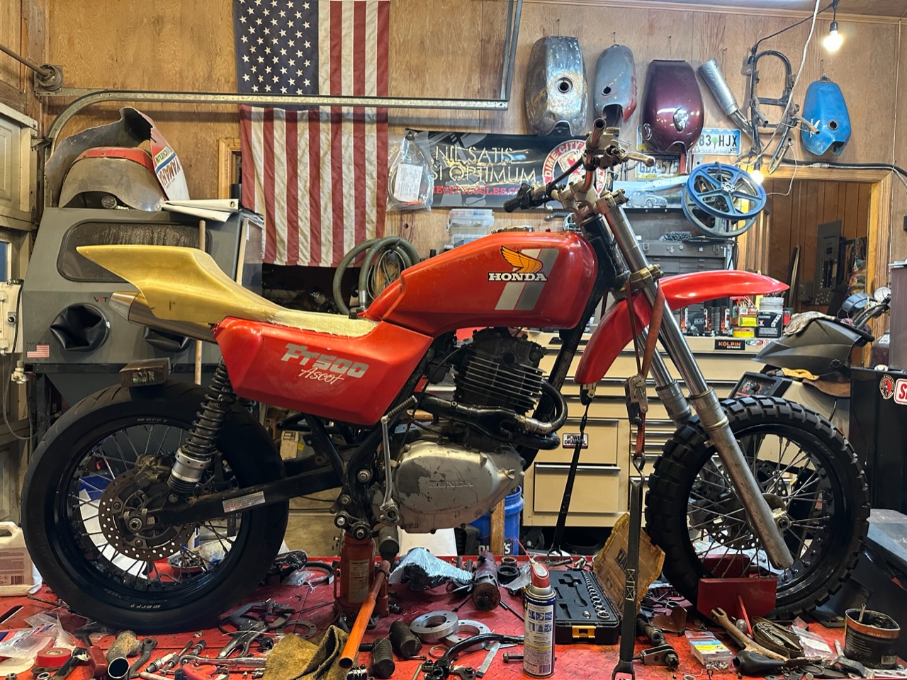

Some may remember my last FT500 that was stolen right as I was getting close to being done with it. Well, during that build, I dreamed of a kick only FT500 with a XR500 engine. Here it is.
I have a love triangle deal with @Hurco550 and @ridesolo for a pair of DR350 Supermoto wheels. The Ninja wheels are temporary until they come in via Barber.
The last pic is just the seat pad base I made this weekend. A proper glass tail will be incorporated. I also bent the subframe to get a higher tail.

I like it!!! The angle of the tail/trunk reminds me of the street fighters I saw in Europe. It aligns with the front of the tank very nicely.

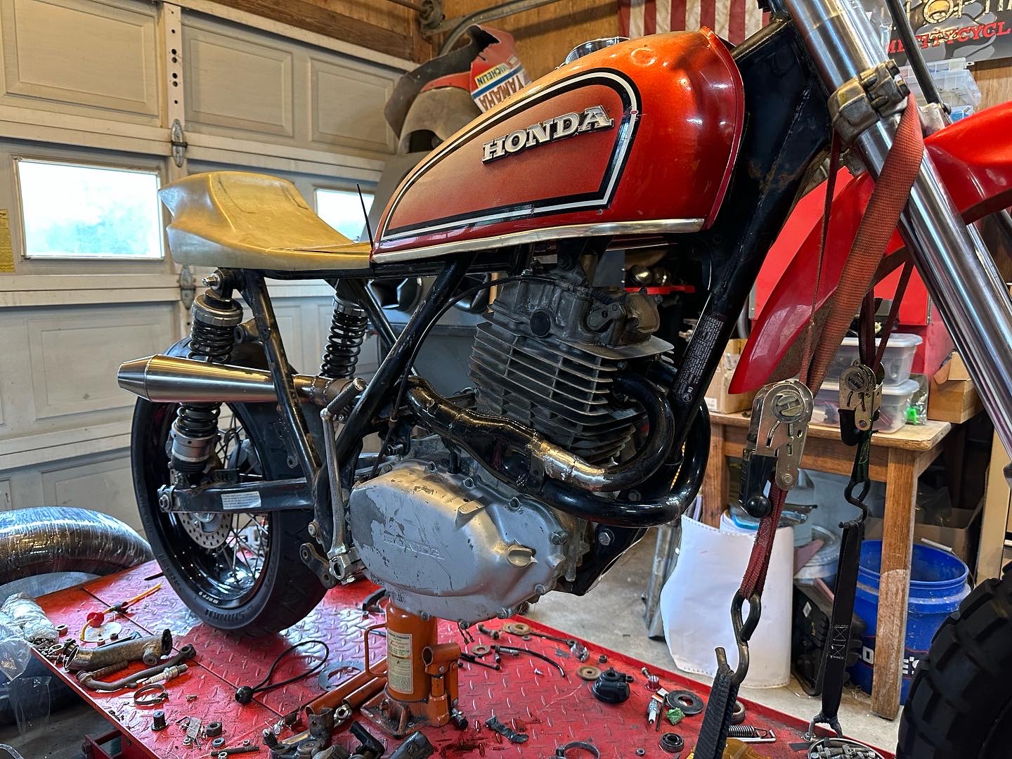

Instead of throwing out money for a first gen header, I modified an RFVC header to fit. The brackets are made by machining the center bore from GX390 brackets.
That tail section fits really well with that tank and side-cover setup, digging this one
