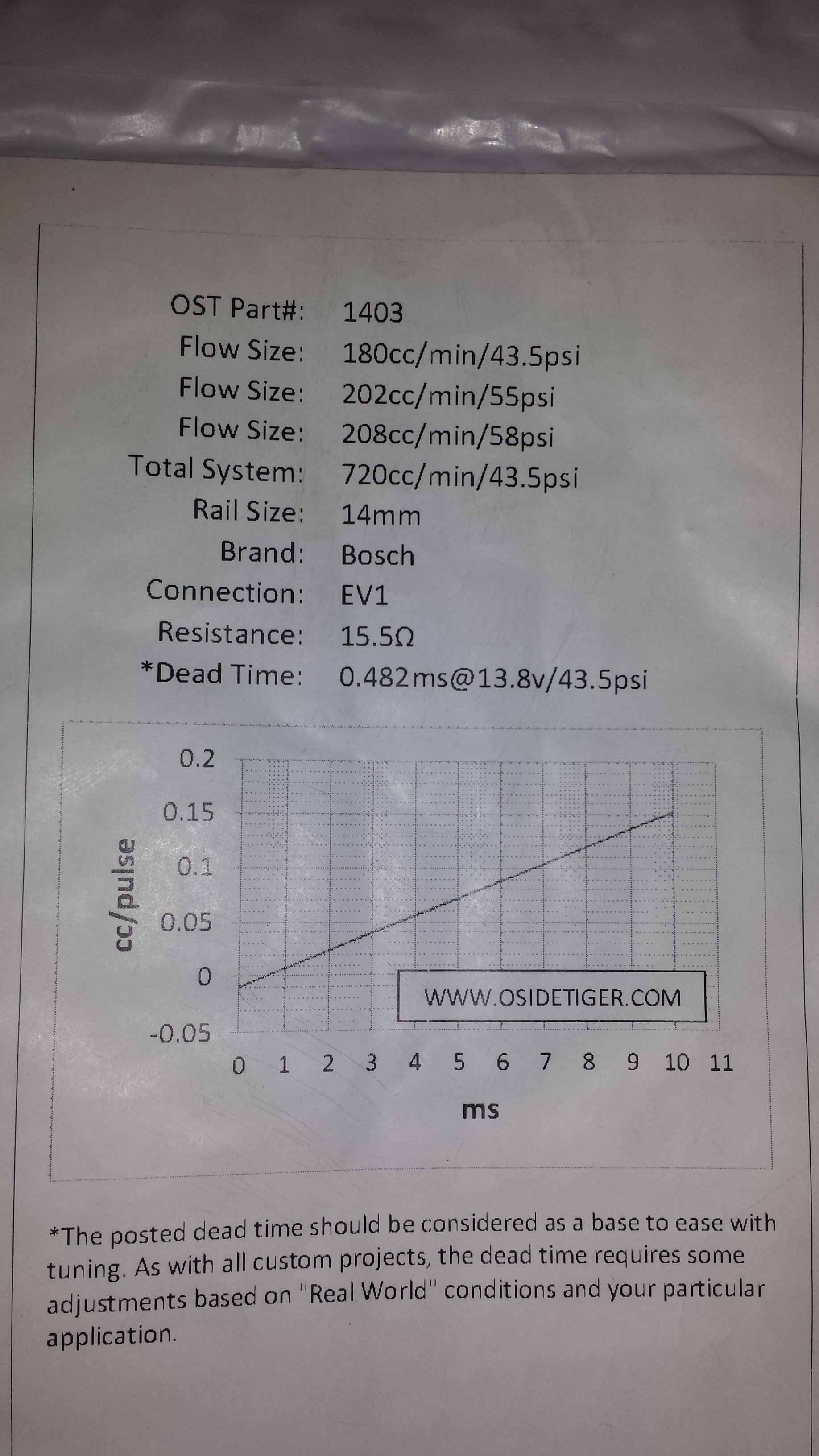

My best guess is that the new fuel injectors are just the wrong type and not delivering enough fuel but before I buy new ones I want to see what you all think. The pic is the info on the injectors I had bought. Thanks
