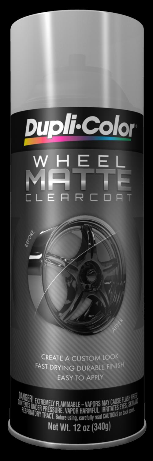

Ok - so I'm probably a little way out from clear now. Decided to do some stripes and lettering so it's going to be another week before clear.
Now, here's a question. To me the green turned out fine, not perfect, and there are some underlying issues with the tank that still show through but these are on the under edge and as mentioned this is not the perfect tank for the bike to begin with.
Anyway, I would really like the color to be a little darker so I was thinking about spraying it with of all things Duplicolor wheel matte clear... now I might just be completely bonkers here but I'm thinking this should darken the green however I don't know if I can then spray 2K over this and still get a gloss without a bad chemical reaction or the creation of a gravitational singularity... ;)

ok - it was just a wild idea after 3 beers - usually this is a 5% hit on brilliance.. with the rest either dumb or dangerous. ;)
So is there anything i can use?
The easiest thing you can do to darken it is shoot a darker color. To ensure adhesion, you can wet sand with 600 or 800 just to scuff it up and then shoot a darker color.
