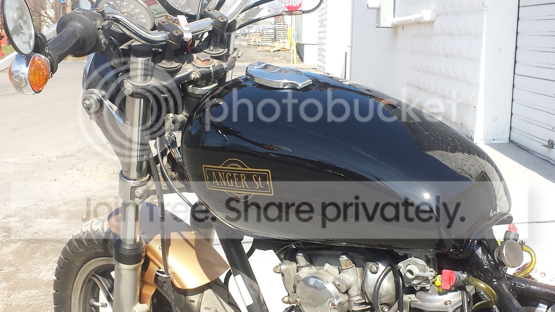

for what it's worth, I painted this tank with dupli-color universal black and laid 2k clear over it. this has zero wetsanding and no polishing done.
Not looking too bad.. still need to polish and will probably give it another fine-grain compound before in a weeks time.

I'm shocked at how the 2K reacts to sunlight - really - I know it says to IV cure but it's amazing how much tighter and glossier it is just after two days in the sun.
