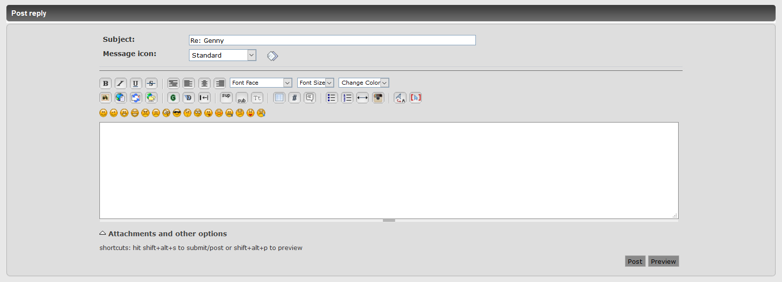

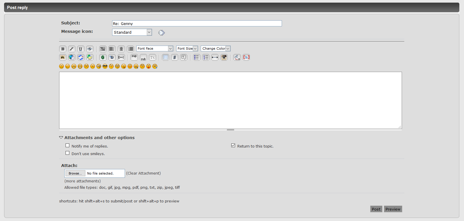

When you post a reply click on Attachments and other options and load your photos there.
