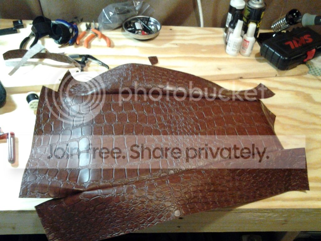

Work on my loop stitch while watching Star Trek...

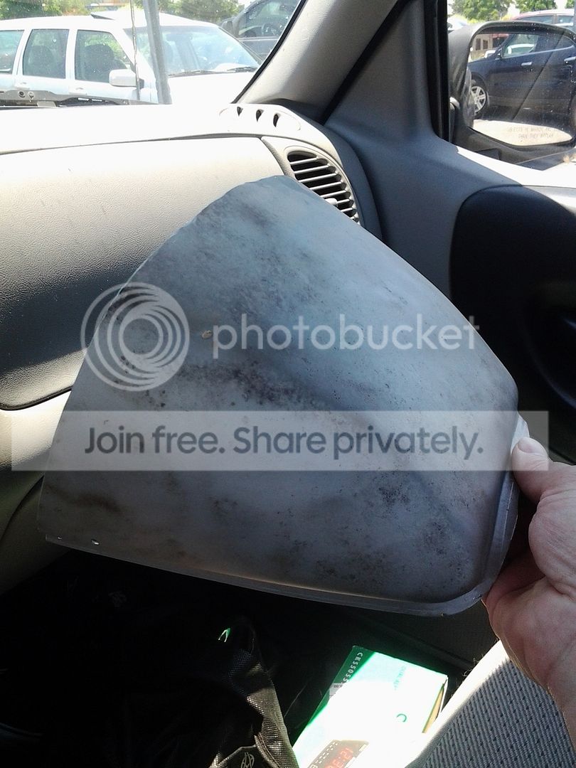

Had my buddy sandblast the cowl:
