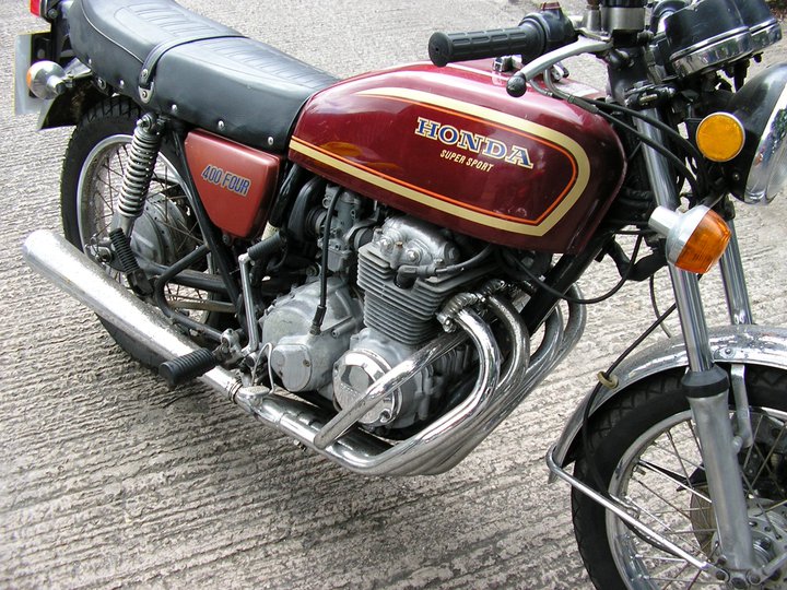

With a new battery, oil change and fresh petrol, the Honda fired up straight away, and idled quietly.. I was a happy man. Those old Hondas are lovely bikes, it felt so small and slim compared to modern stuff. It wasn't very fast, but sounded cool at high revs with that old Dunstall exhaust. My plan was to slowly restore it, just doing small jobs over the summer but keeping it on the road. It needed a cosmetic restoration, the engine ran fine. Well, that was the plan..

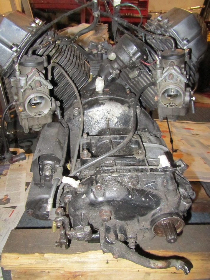

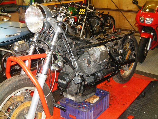

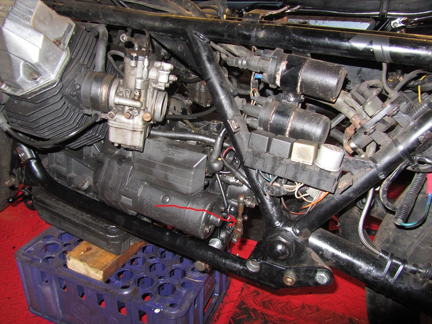

The plan was to strip the bike down, get the frame powder coated, clean and polish everything, hopefully the motor wouldn't need much work.. rebuild it with minimum wiring, a single seat, a few upgrades here and there. such as delinking the brakes, braided hoses, make it lighter....and ride it. The engine in the Cali is tuned for torque rather than HP like the Lemans.. should make for a good everyday bike.
First step, strip the bike and lift the frame off the engine, a lot easier than lifting the engine from the frame. I took lots of photos along the way of every cable, wire, pipe, nut and bolt, all worthwhile when it comes time to put it all back together..

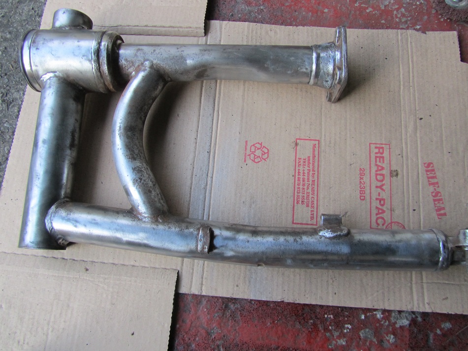

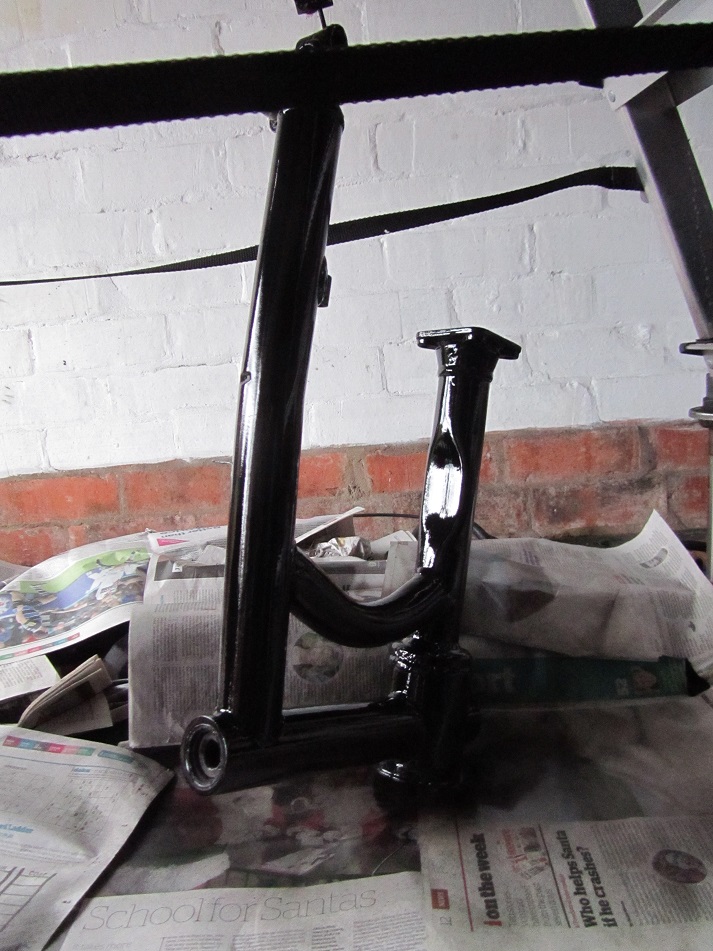

Start with something easy and cheap. Strip the rear bevel box and paint it..
Ditto for the rear swing arm. I was going to paint the frame the same way, but it turned out cheaper to get it powder coated, given the cost of materials these days..

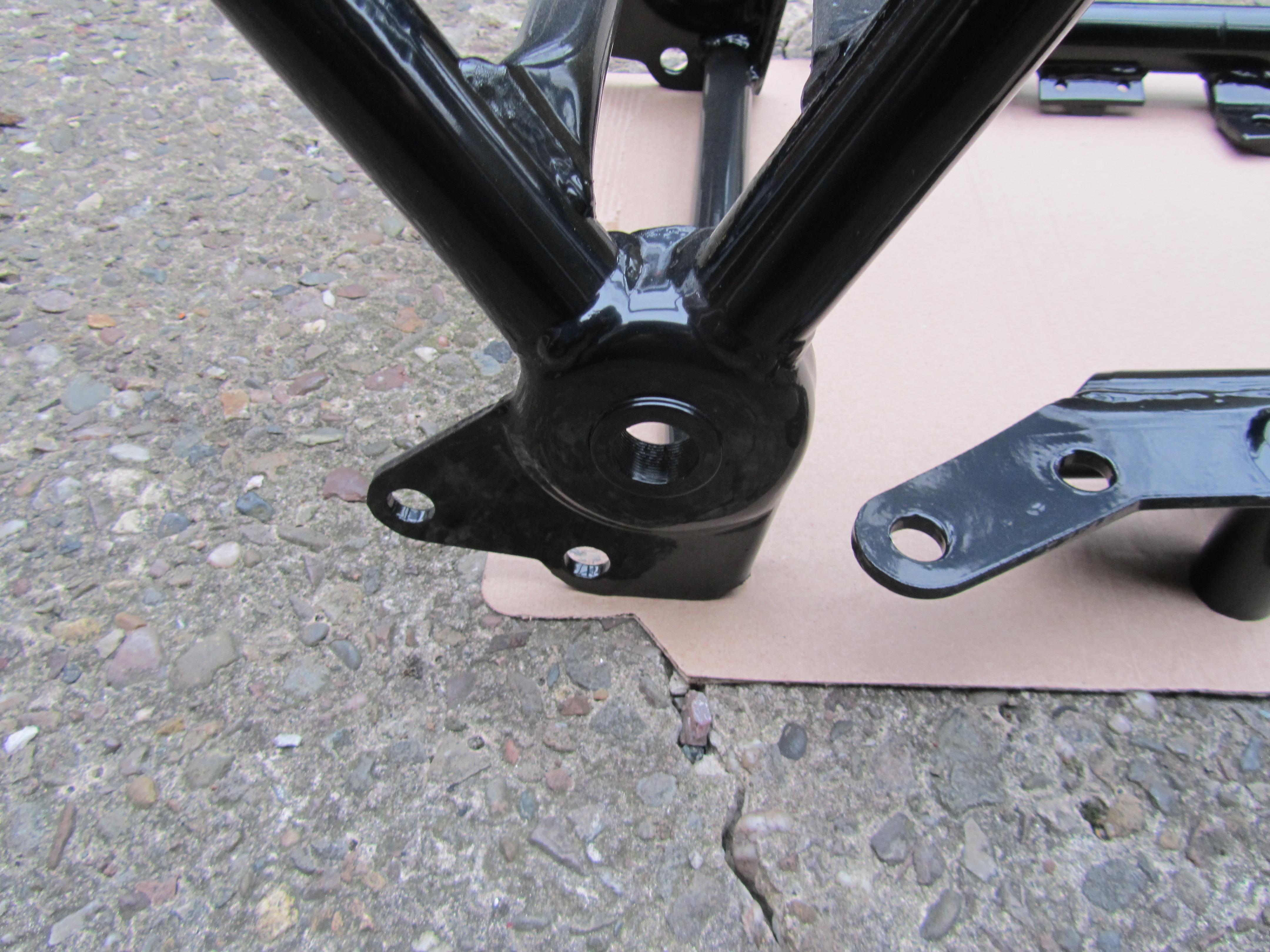

The rear shock mounts were damaged, so had to grind them out, make new ones and get them welded into the frame..While the frame was being welded, I also took the chance to cut off a lot of tabs, I went a bit far, as later I wished I had kept a few of them ::)

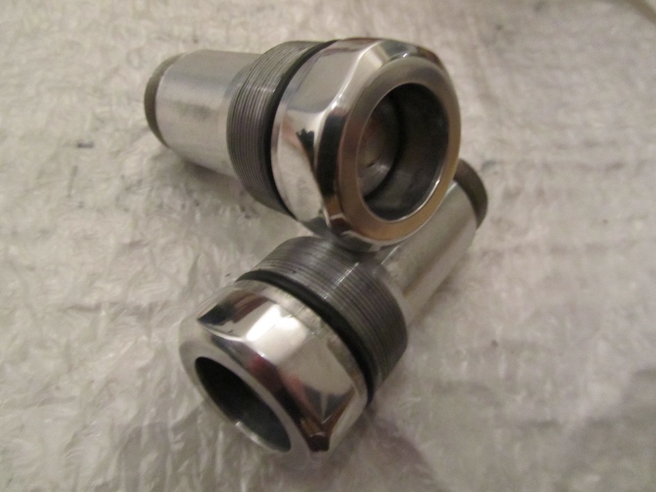

The fork tops were looking very tired, so I skimmed them in my mates big old lathe and filed and polished the sides by hand..
Multiply the work in those fork tops by the rest of the bike, and it takes hundreds of hours..but that's ok, keeps me occupied..

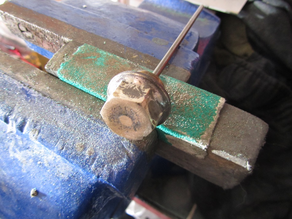

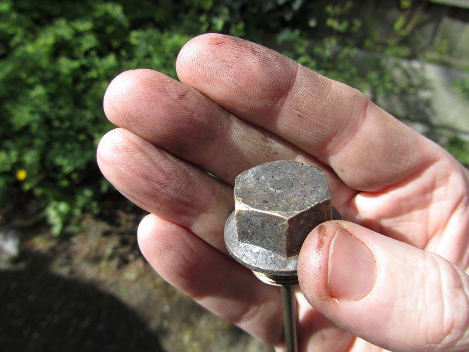

Guzzi still fit some brass parts, such as this oil dip stick. Using various grades of wet and dry it came up pretty well..
I cleaned up and polished the alloy carb manifolds, valve covers etc the same way. I'd love to have a big compressor and a blasting cabinet, but got no room for such luxuries..

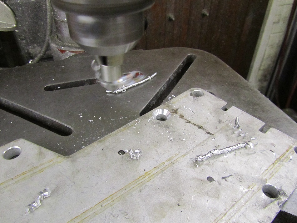

The bike came with this aftermarket alloy battery tray, which didn't fit. By the time I'd got it to fit, drilled it and bevelled all the mounting holes it would've been quicker to make one from scratch..

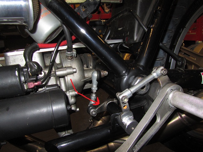

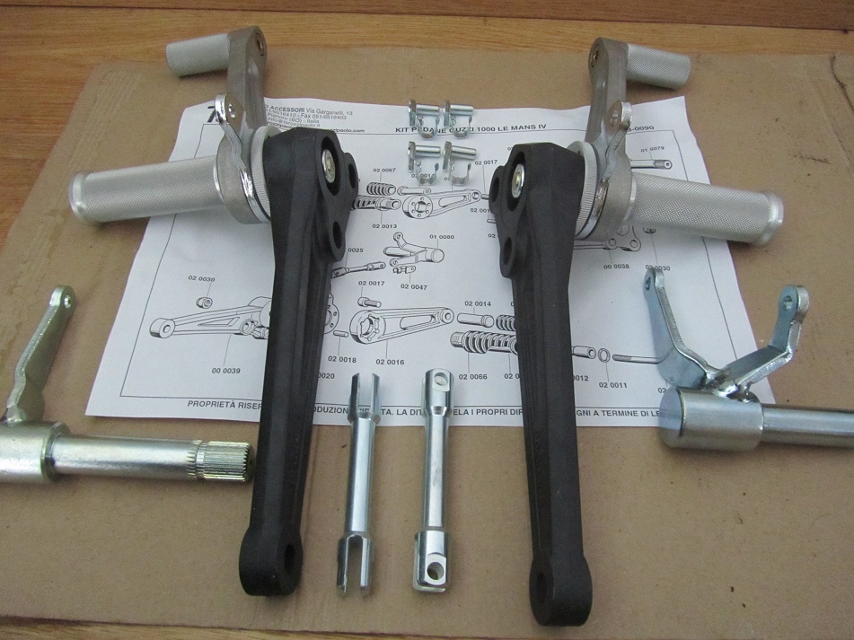

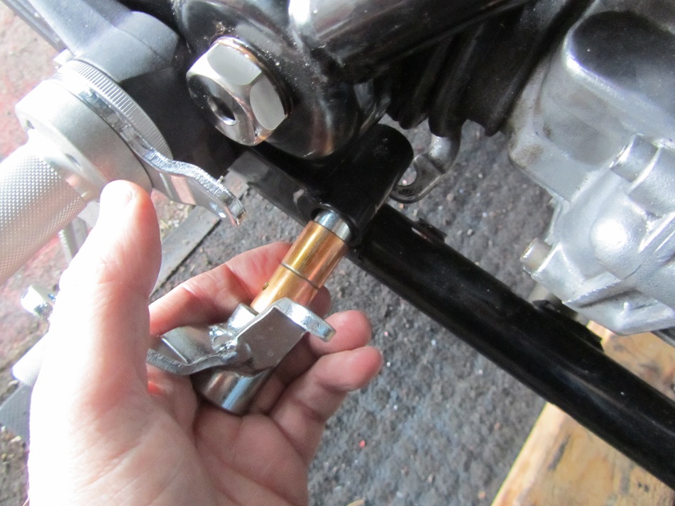

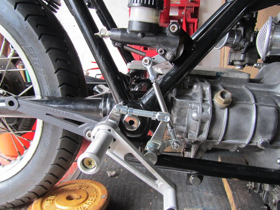

Thanks all, now its time for the rear sets saga. I'd left them in their packaging till it was time to fit them. Checking all the parts, there seemed to be some missing..
And there were, quite a complex linkage for the gear change, a simple link rod for the rear brake and some kind of bush where the levers pivot through the frame rails. Since the kit was designed to fit a Lemans, I guess they assumed I already had these missing parts, as they'd be OE on a Lemans..
I checked the photos I'd taken of the Guzzi race bike owned by the previous owner, and saw I needed this linkage..

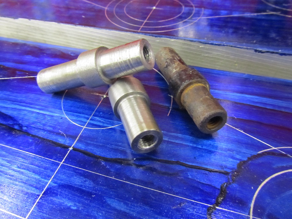

Need some kind of bush, where the rearsets pivot through the frame, a Guzzi dealer wanted £7 for each bush, sod that!,I got mine for 0.79p from an online bearing shop..

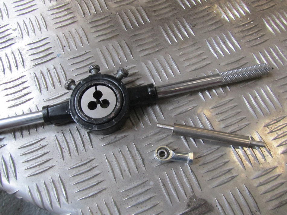

On the brake side, I used a pair of stainless rose joints, measured how long the link rod needed to be, and went over to my mates workshop to make it.. this is about the limit of my machining skills..
Cut a piece of stainless rod..
Machine down each end, cut a thread for the rose joints, looks a few mm too long, but can always shorten it if needed.
