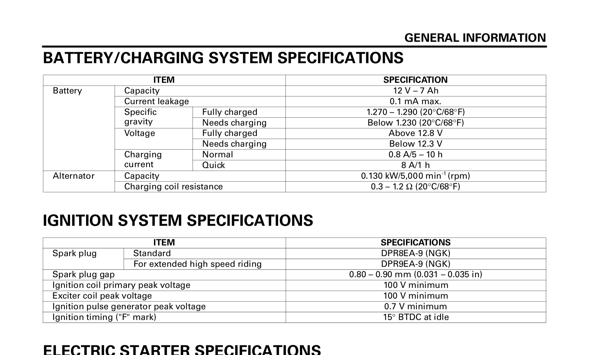

I have 8ohms between the two wires from the stator and both have “ground” to the bike, what I can find on YouTube, suggests that it’s the stator that is broken???
No ground between the stator wires is good. If you did have ground, it would mean the stator is bad.
Unfortunately, 8 Ohms is very high for a reading between the stator wires. Generally, you want 1.0Ω to 2.0Ω (with a preference to the lower end of that scale).

Do you have a service manual to confirm my guess on the stator? Usually the manual will have electrical specs on the stator and the testing procedure.
Yes i have this! See picture. As I read it, the resistance should be under 1ohm and I had 8.
Does that mean, a new alternator ?
