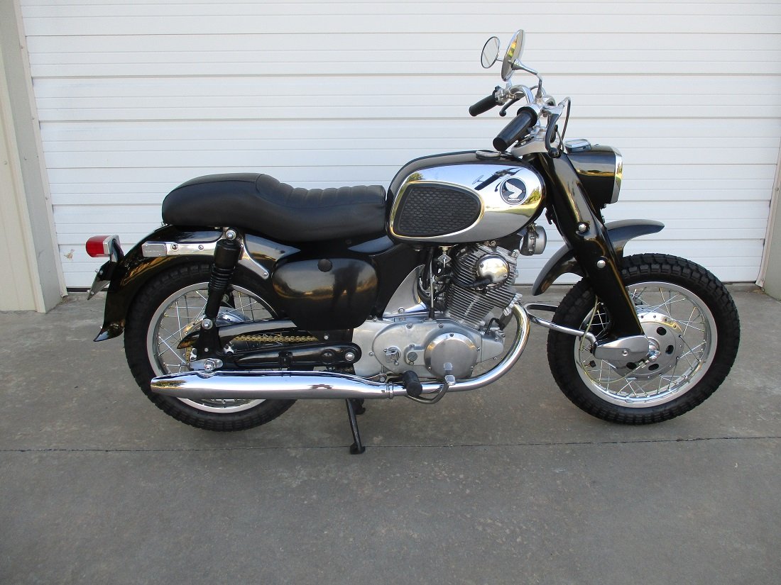

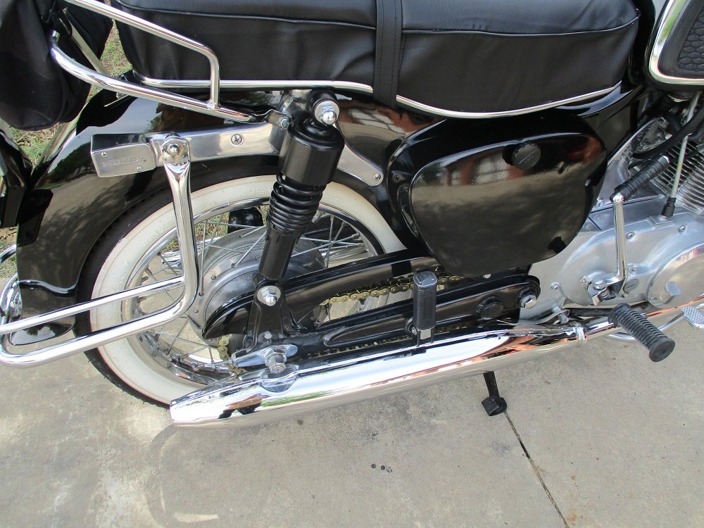

I have removed 50 pounds from this Dream to include 10 pounds of rotating mass.
The bike was formerly know as "Slow to Go and Slow to Stop". It's now known as the "CB Killer".

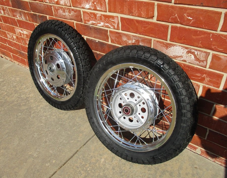

Stock wheel, Coker Firestone whitewall tires - 43 pounds 9 ounces.

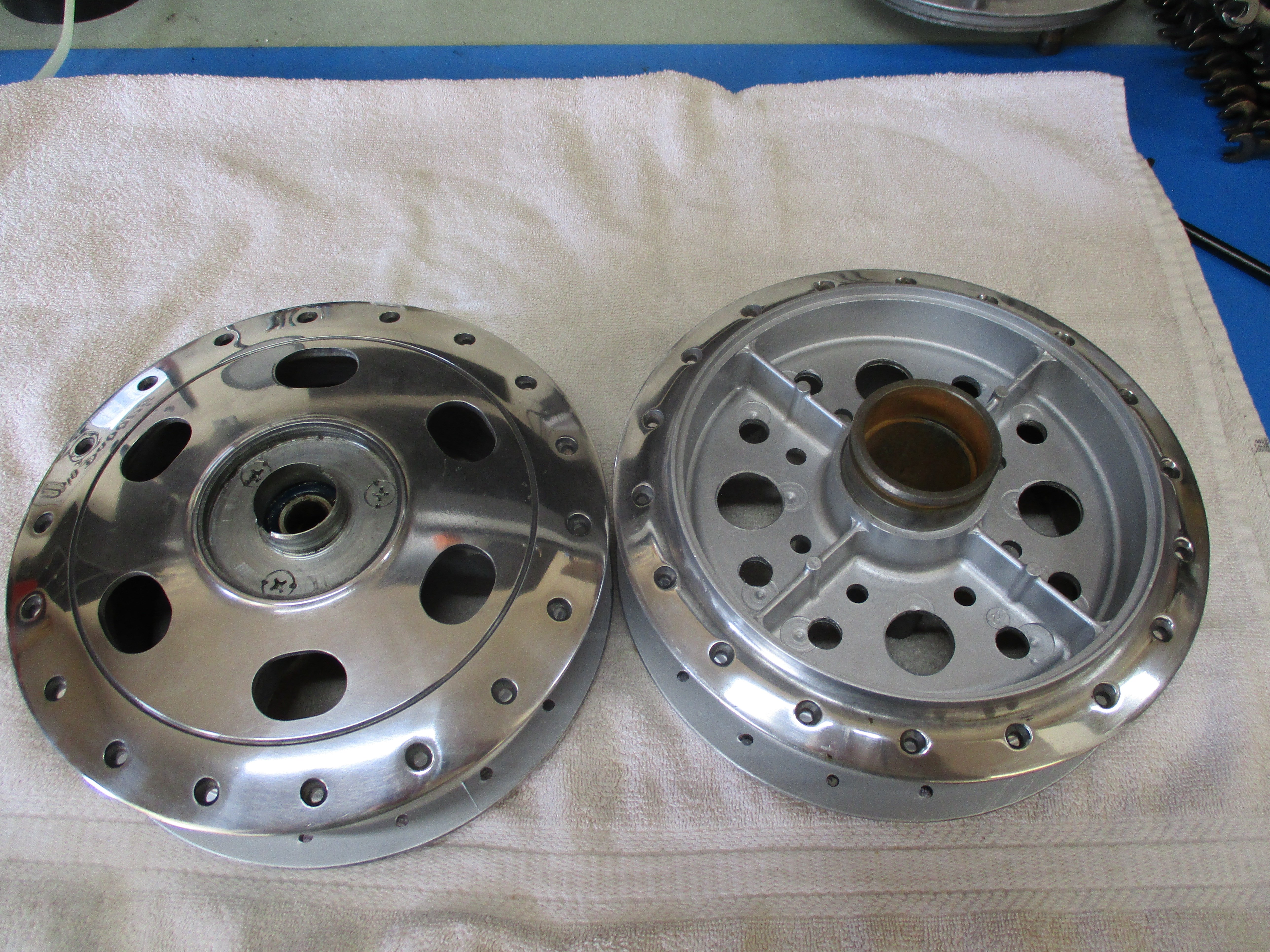

Aluminum rims, Duro 308 tires, lightened hubs - 38 pounds.

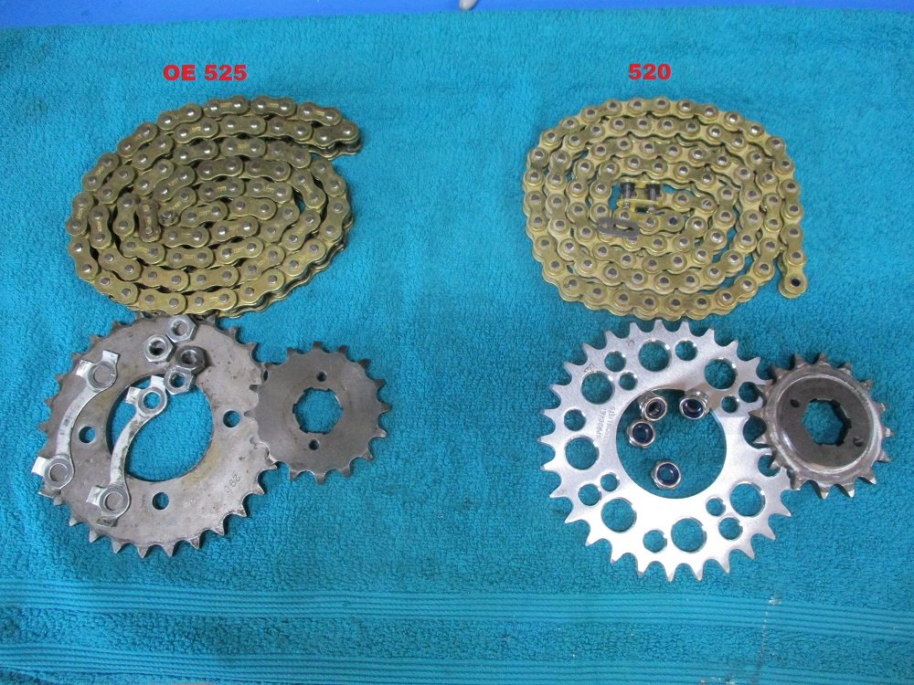

So with the chain conversion and the rear sprocket carrier mod that's over 9 pounds of rotational mass removed.
Replaced air cleaner and tube with a velocity stack - subtract 1 pound 4 ounces.
Modified chain guard - subtract 2 pounds 2 ounces.
Lithium battery - subtract 6 pounds 9 ounces.
Removed rear fender and engine guard - subtract 8 pounds.
Removed front fender and guard, replaced with a carbon fiber shorty - subtract 4 pounds 12 ounces.
Replaced side panels with carbon fiber subtract - 2 pounds 15 ounces.
Replaced the seat and rack with a lighter seat - subtract 7 pounds 2 ounces.
Removed baffles, tool kit and tray - subtract - 2 pounds 14 ounces.
Passenger pegs (pair) – 1 pound.
Side stand - 1 pound 1 ounce.
Air Cleaner Cover – 4 ounces.
Backing Plate (pair) 1 pound.

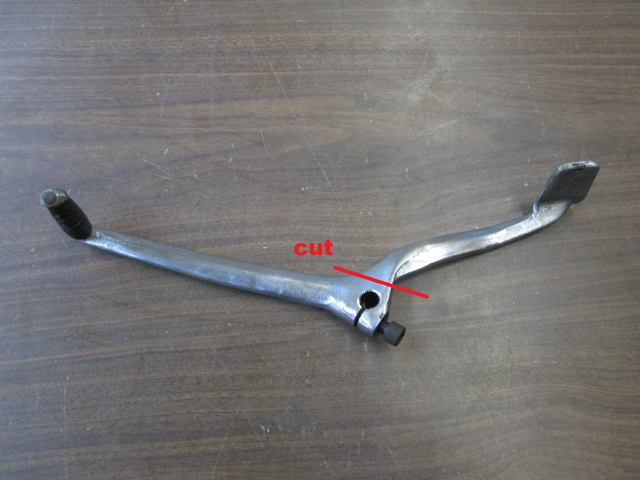

Kick Start lever – 1 pound 5 ounces.
Modified shifter – subtract 5 ounces.
Lightened main stand – subtract 4 ounces.
Lightened the backing plate a bit mote – subtract 2 ounces.
Total of 50 pounds removed from the bike. It’s so much more fun to ride now!

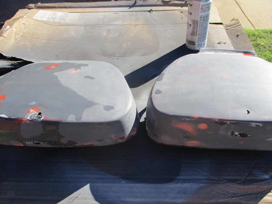

I tried to get used to the look of my carbon fiber parts and it wasn’t working for me. So I went with black. Almost done just need to sand, buff and polish.

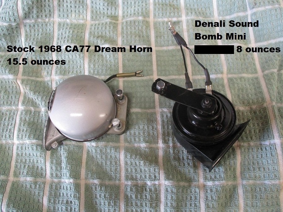

Stock horn -15.5 ounces, Denali Sound Bomb Mini – 8 ounces. Subtract 7.5 ounces.
It's not as loud as advertised but it is louder than stock.

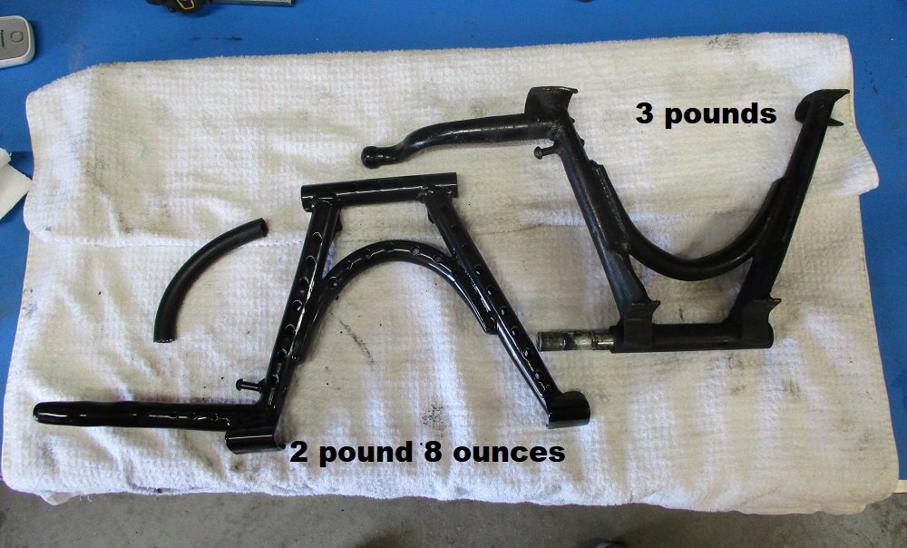

Main stand – 3 pounds, lightened – 2 pound 8 ounces, already reported 4 ounces. Subtract 4 more.
Round Mirrors 1 - pound, rectangular mirrors 12 ounces. Subtract 4 ounces.
Changed front fender nuts and washers for stainless self locking. Subtract 1/2 ounce.
So that comes to one pound and added to the total I've removed 51 pounds. This has been a fun project for me.
A few more pics.
The reduced weight helps out with stopping power but a longer front brake arm placed on the rear helps a bit more.

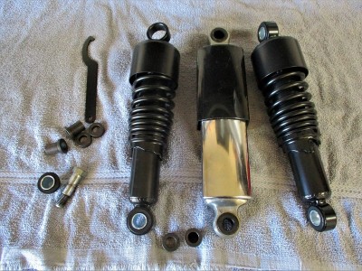

The lowered weight helps out the suspension but an adjustable Harley Sportster Shock is also an improvement.

Never did care for a heel/toe shifter.
And a pic of the velocity stack.
Finished up a carbon fiber license plate bracket.
The new weight loss total stands at 51 pounds 14 ounces.
