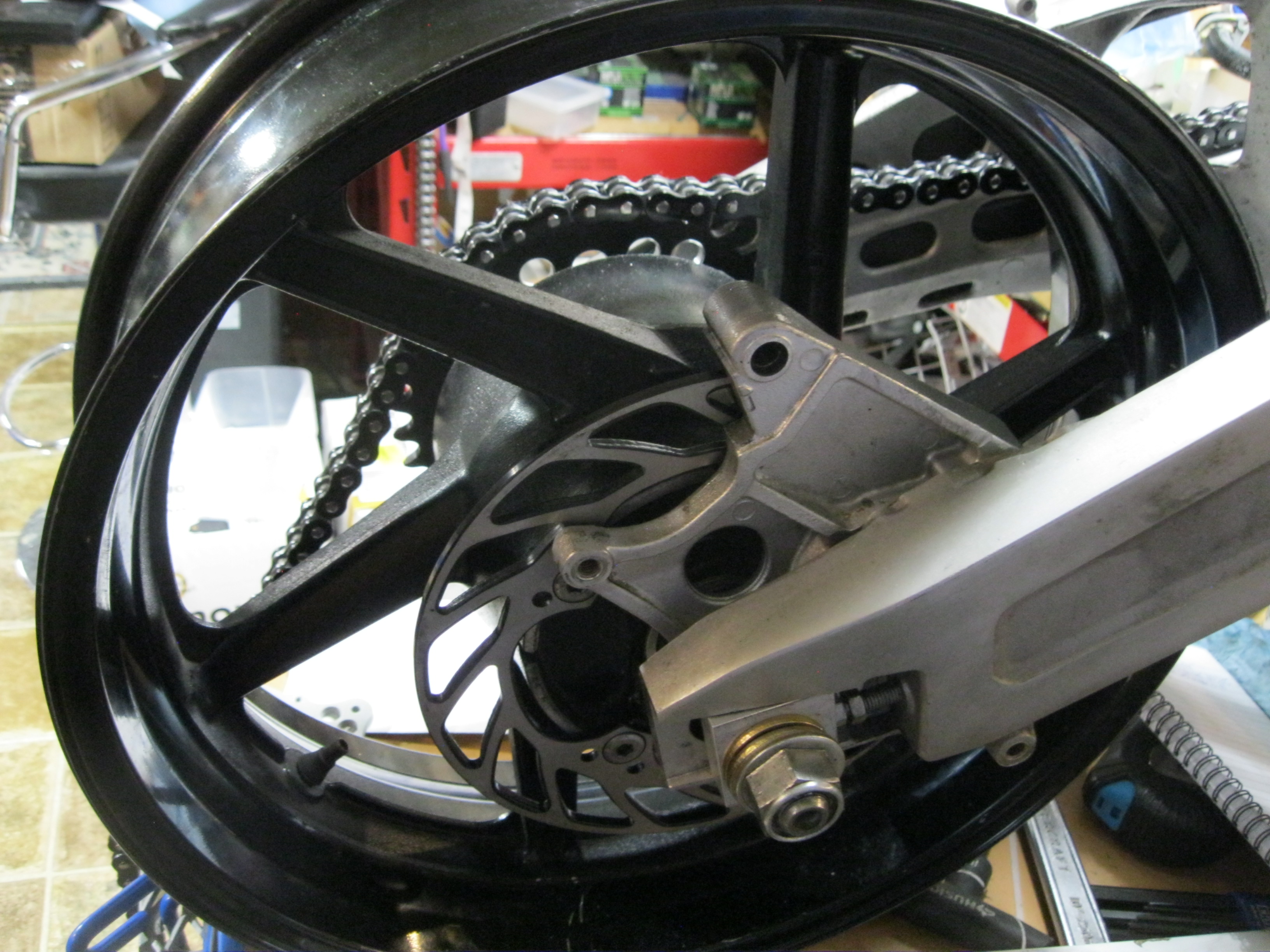

Nissin radial calipers, GSXR-750 rotors CBR600F3 wheel.
The GSXR rotors needed adaptor plates machined to match up to the CBR wheel.
New disk, CBR600F3 rim and brake carrier, NC29 swingarm
After a lot of screwing around with the CBR600F3 cush drive, I happened across a VF500 Interceptor cush drive in a box of parts and it uses the same drive lugs and rubbers as the F3. A bit of machining to line up the sprockets and we had a winner! New 520 chain and front sprocket, and a leftover rear sprocket from my old turbo 400 build and that was one headache taken care of.

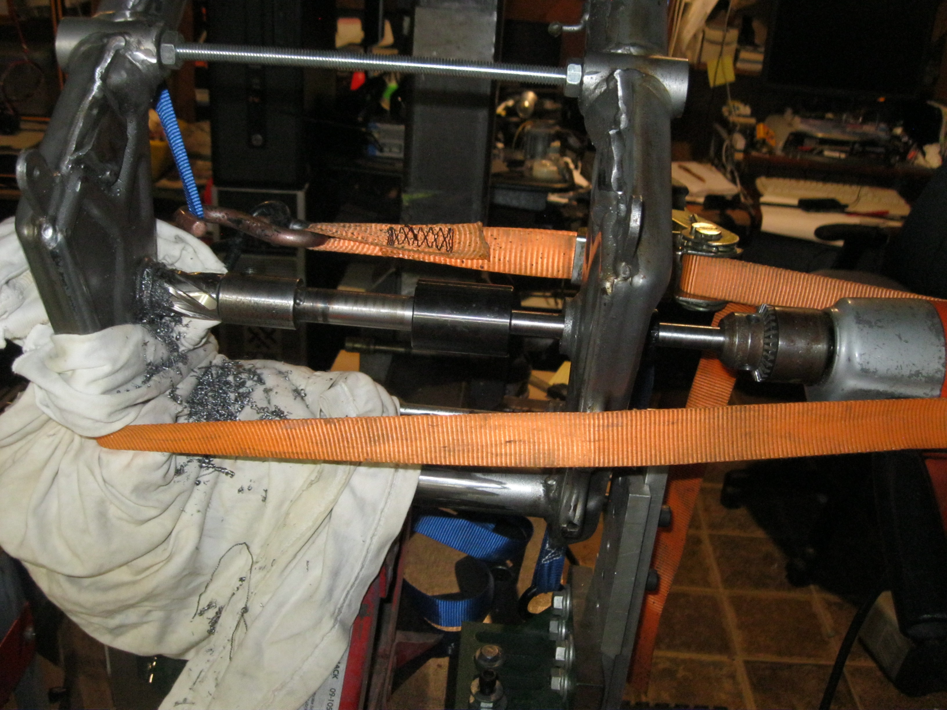

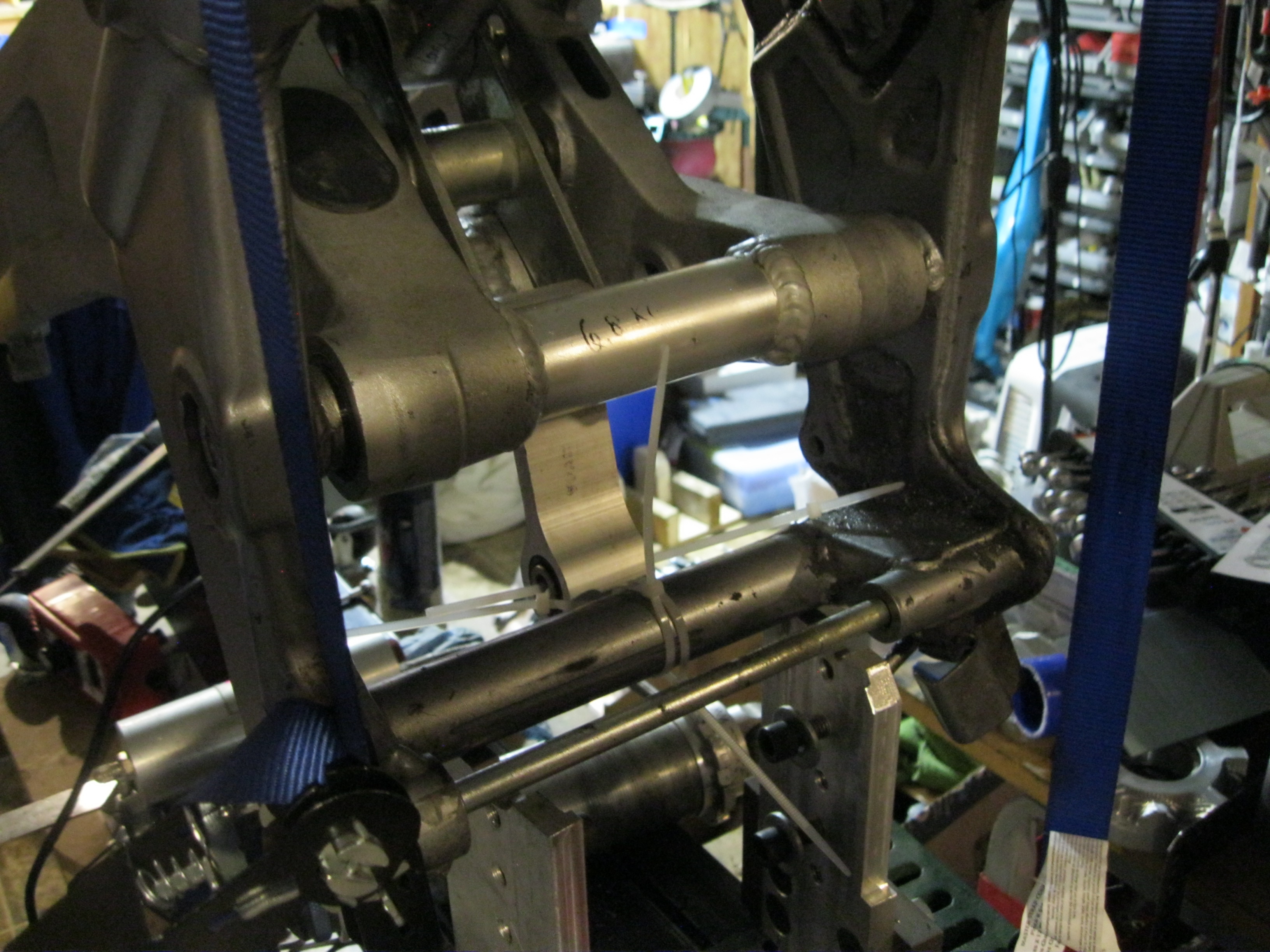

Mounting the CBR400RR swingarm turned out to be a real nightmare, mostly of my own doing. For starters the swingarm was too wide at the pivot tube to fit into the frame, and the CB-1 only uses a 15 or 17mm pivot bolt, whereas the NC29 uses a 20mm bolt. I realized that the easy solution was to use the smaller pivot bolt and make up some inserts for the swingarm bearings, but I really wanted to use the 20mm bolt. That meant I needed to bore out the pivot holes.
I set the frame up on the mill but the setup wasn't solid enough and rather than cutting the boring bar was just flexing away from the cutter. I switched over to drilling out the holes and they drilled really easy, but not on center. The holes were visibly off center. SH*T!!!
I needed to get the hole back on center. If I couldn't get it set up in the mill the only other option is to try and line bore it. I made up some spherical spacers that mounted in the swingarm pivot cups on the frame and pieced together a line boring set up that used a 1" annular cutter.
After the holes were opened up and enlarged I made up inserts to bring the inside diameter back to 20mm. After much faffing around the swingarm was mounted.

I agree that there were multiple ways to tackle this. I picked one path that I wouldn't follow again. I'm beginning to think that this will be a temporary frame build, and once the bike is complete and running I will likely pull it off the road and over the winter completely redo this section of the frame. I have lots of experience with "Bimota" style frames using machined aluminum side plates mated to a welded tubular frame, and I think I will go down this route at a later date.

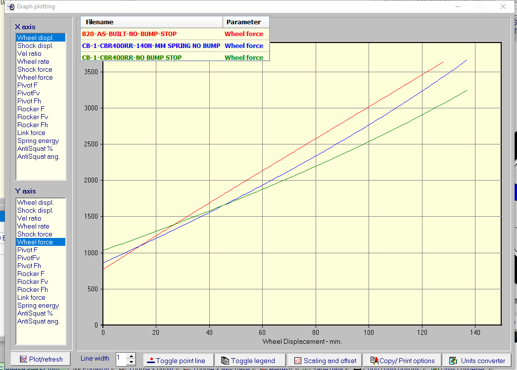

I entered all my measured data into my suspension software to position the lower link mount, and upper shock mounting locations.
I compared the results to my other build, labelled "B28", which was designed to mimic a CBR600RR. With the 108N/mm spring that comes from a CBR600RR shock I think I might be a little soft. I recalculated with a 140N/mm spring and that got me back to being comparable to the B28 line. I also have a stock CB-1 spring that is progressively wound being force tested right now. Once I get the results of that I'll plug those numbers in too.
Using these dimensions I located my upper and lower shock mounting points for a CBR600RR shock. I was planning on converting the CBR600 sock to a remote reservoir, but it looks like a CBR1000RR shock might fit without moving the reservoir.

Is that Tony Foales software that you are using to calc the wheel force?

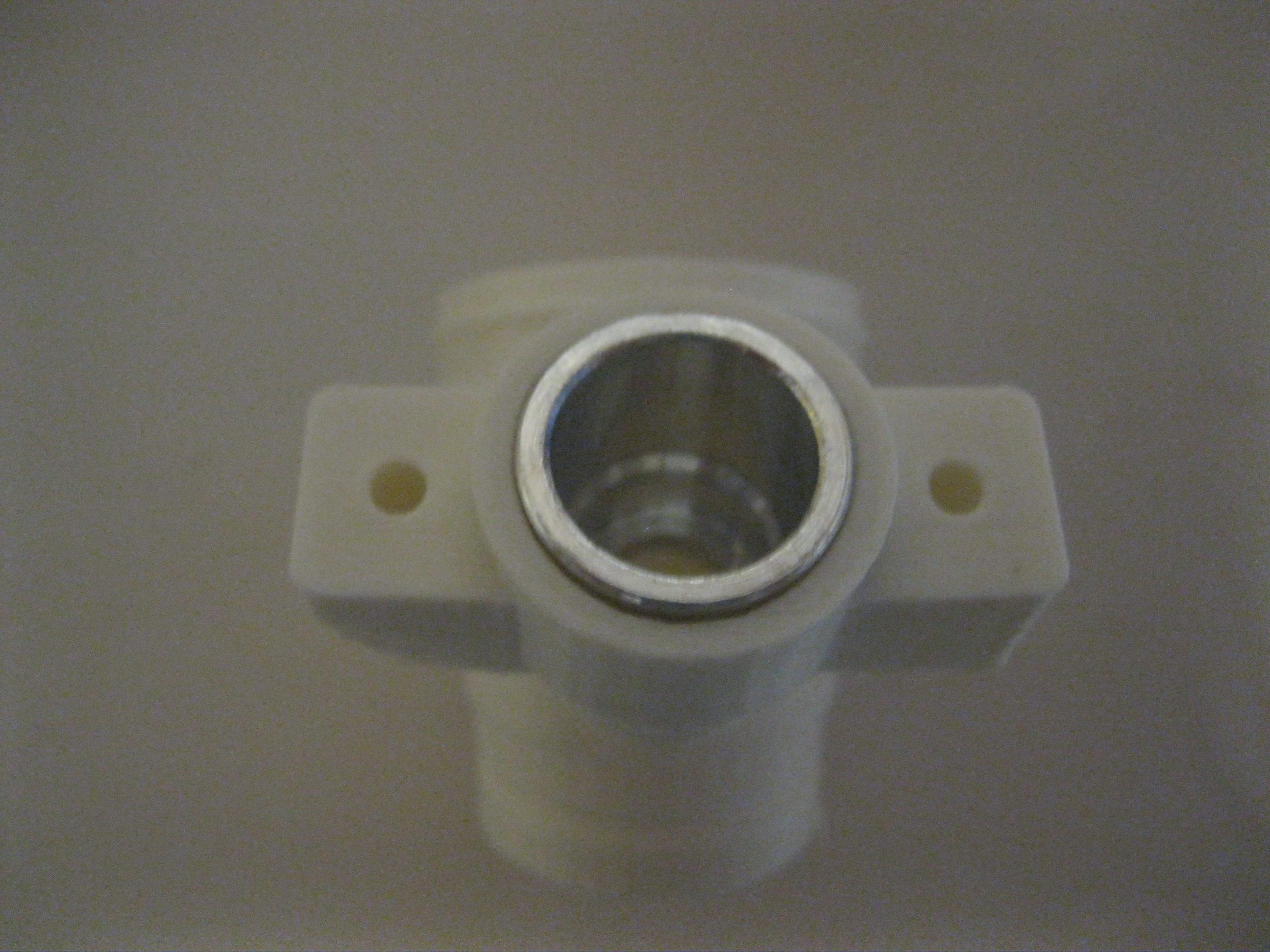

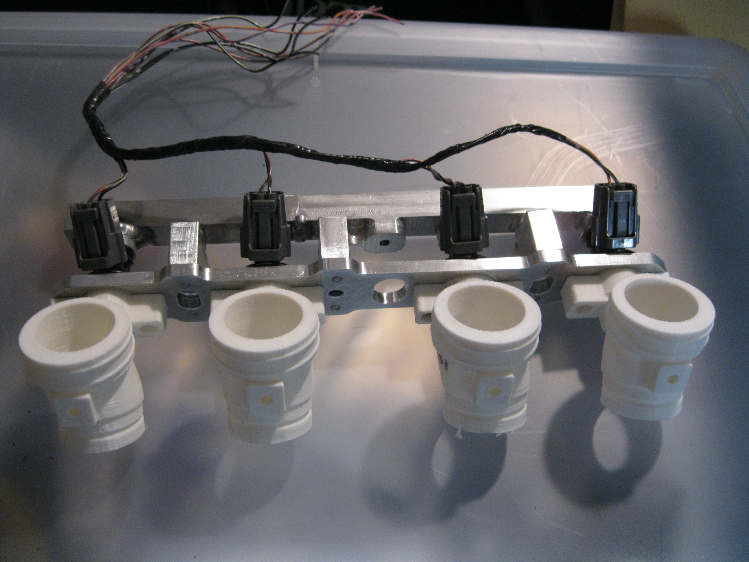

Another milestone today, but not without some drama. I got the intake plenum basically finished, just need to add a snout for the intake tube to attach to, and fill in the sides and the rear cutouts. I am going to run stock CB400FS 140cc injectors in the throttle bodies, and then CBR600RR 190cc shower injectors in the mounting bodies.

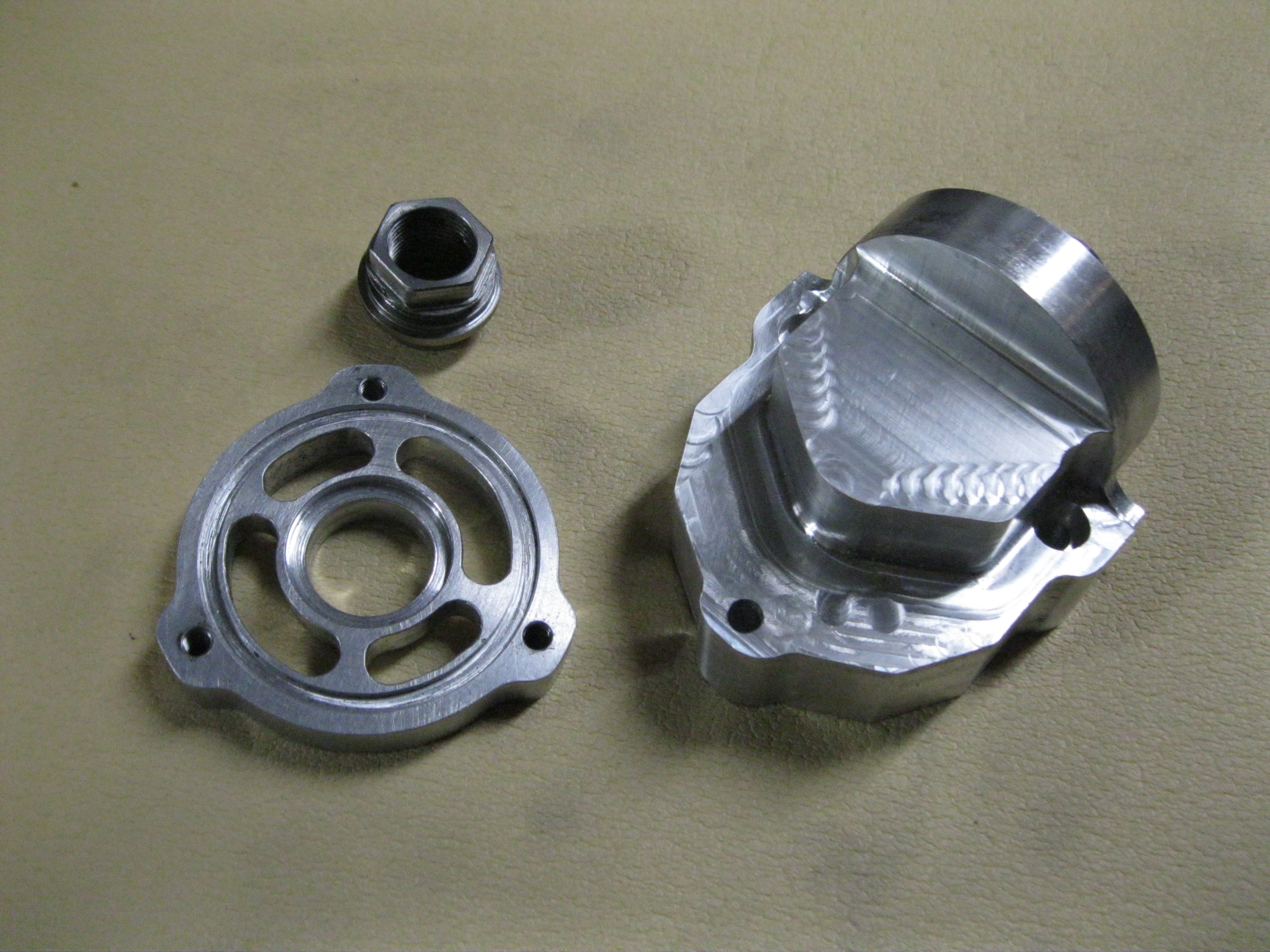

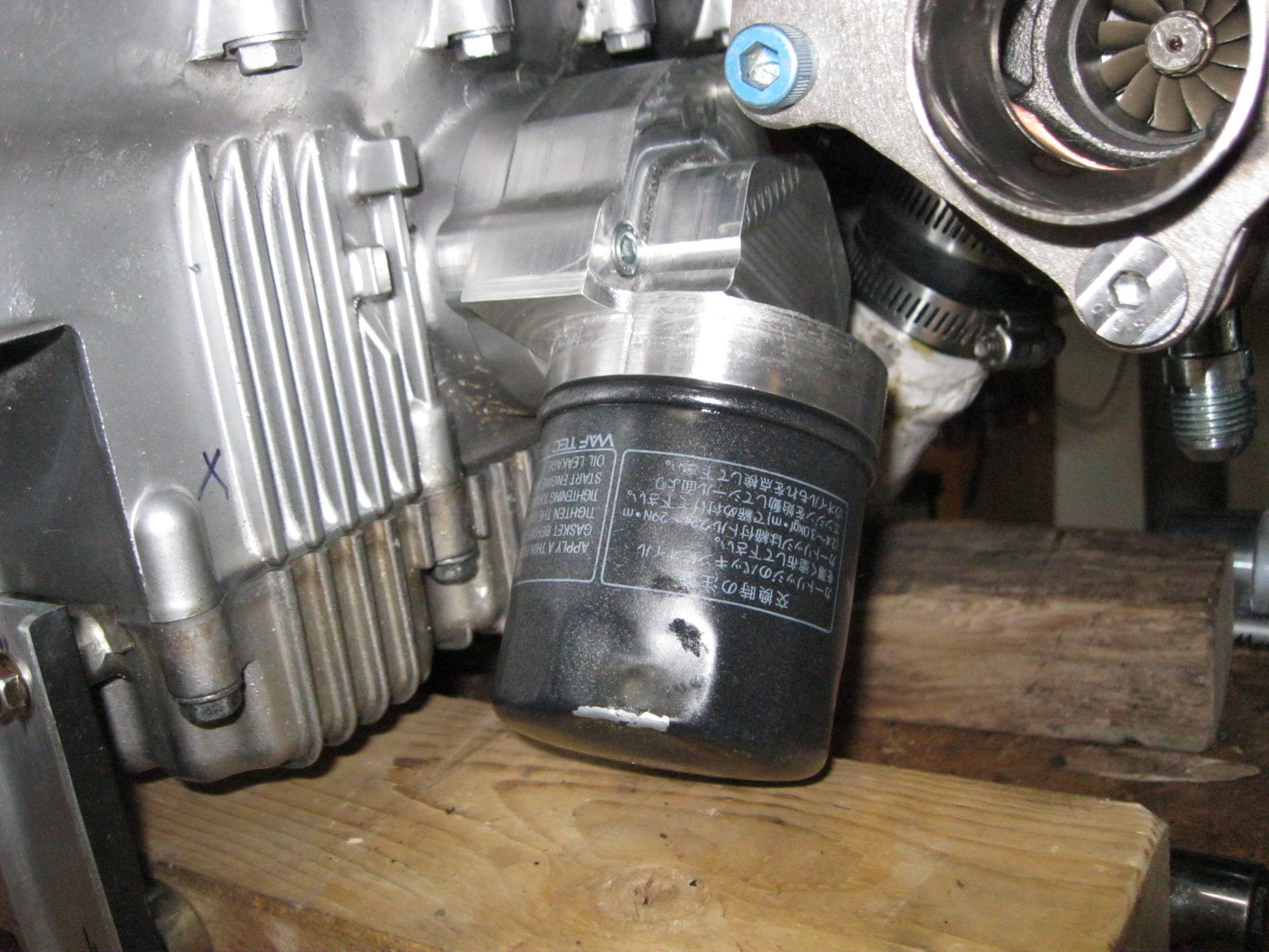

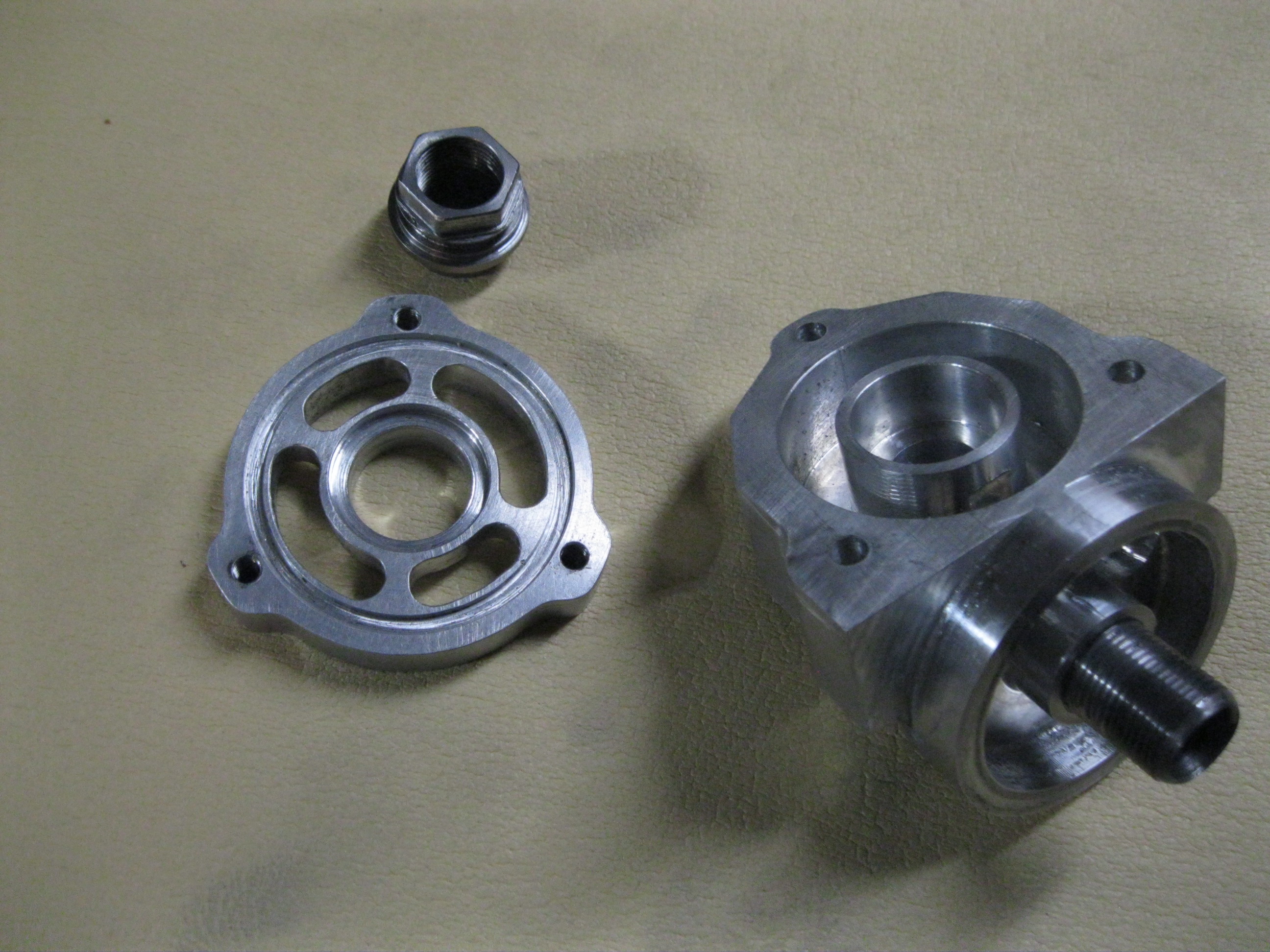

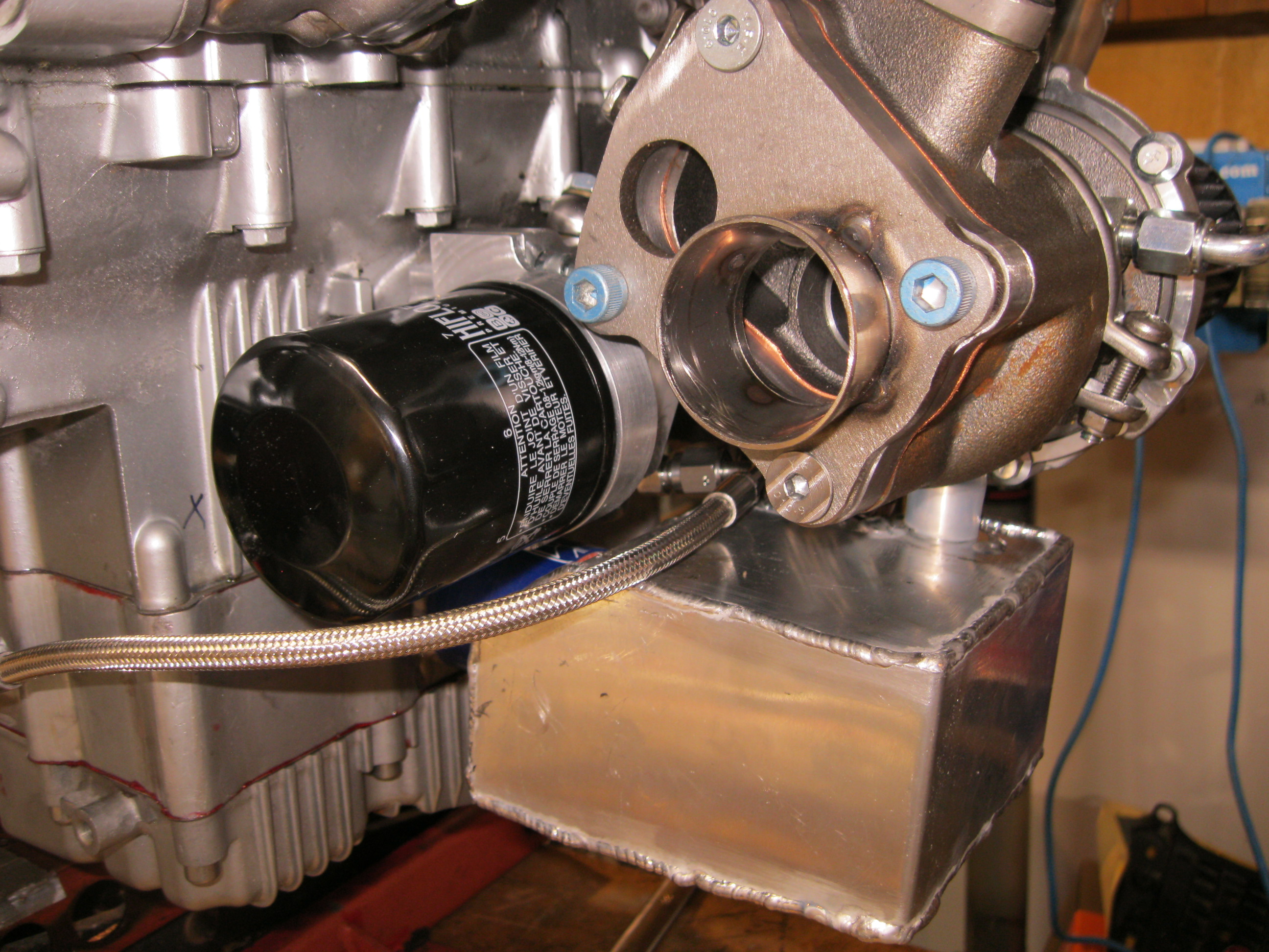

You can see from one of the above photos that I had just enough clearance from the oil filter to the turbo to remove/install the oil filter that came with the bike when I got it. I ordered up a new filter and when I went to install it, guess what? It was about 1/2" longer than the filter that was on the bike. I did some research and it seems the two filters have different pressure relief valves in them.
1. I didn't want to take a chance with the wrong filter.

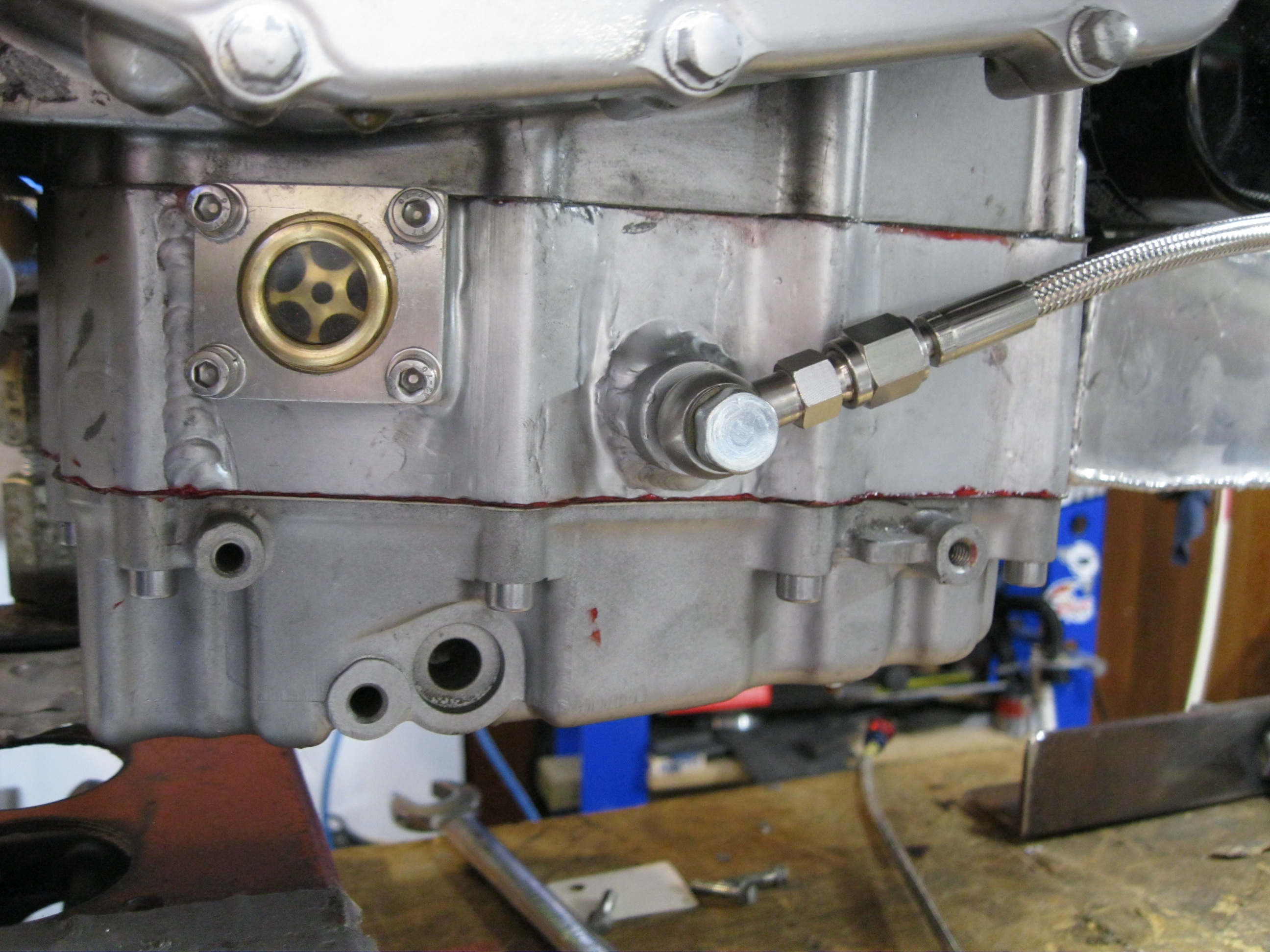

2. I needed to take off some pressurized oil to feed the turbo and feed an oil squirter. (More on that later)
So I decided to build a remote filter housing. These are common on Turbo Hyabusas so I looked at a few photos online and designed my own. Quite a bit of machining but it all went fairly smoothly.
Everything proceeds at a snail's pace. Sometimes you spend weeks working on a few items and when you are finally done you look at it and think "This should have taken a few days". And you probably could do a second on in a few days without all the thinking, fitting, rethinking, refitting.

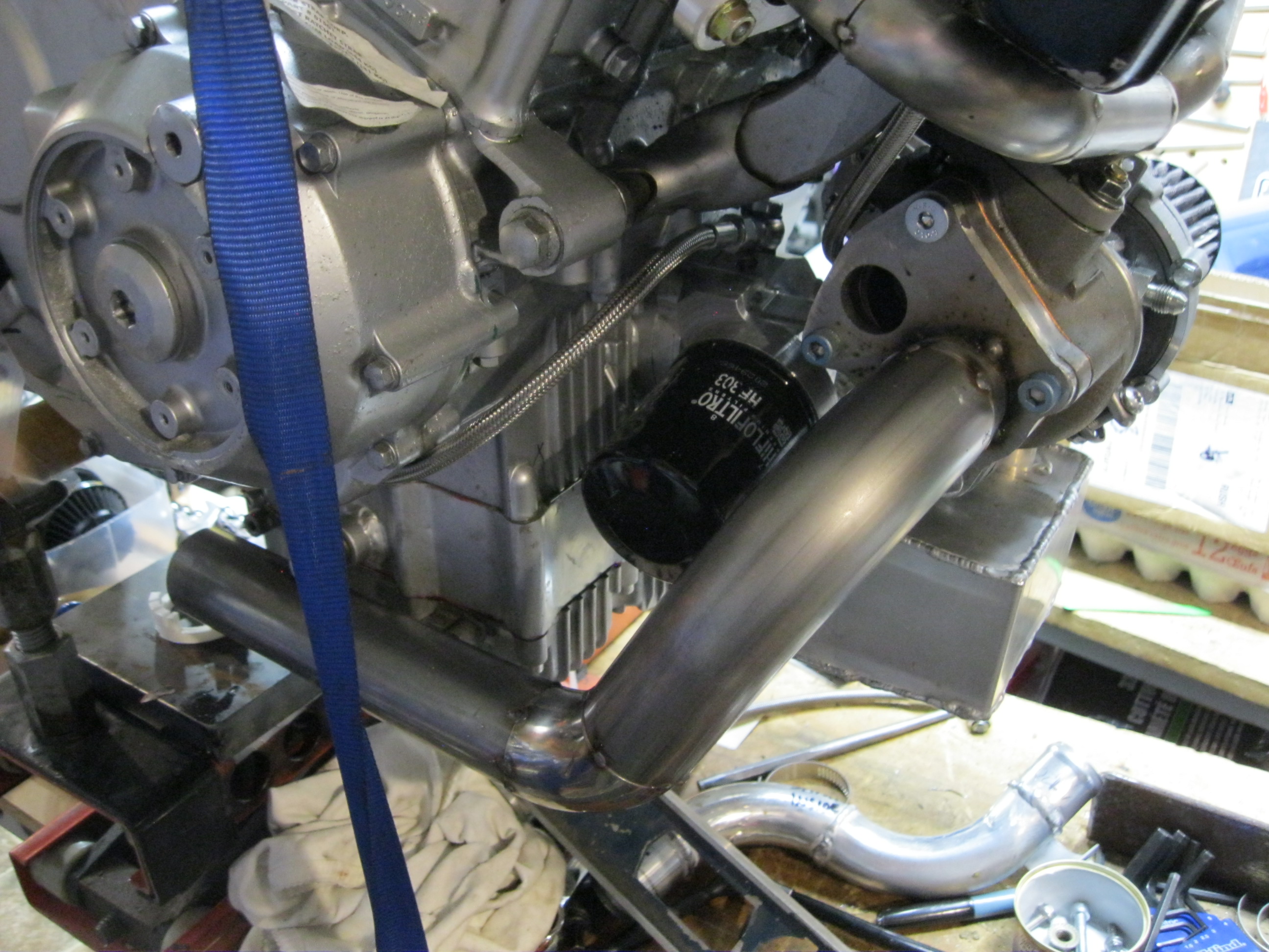

The turbo needs a straight drop out of the body for the oil, so a small tank allows for that, plus adds another half litre or so of oil capacity. The oil pan extension drops the oil level by 55mm to work with the tank. The oil pump is chain driven and actually ran partially submerged in the oil. With the drop in oil level I had to add an oil line feeding a squirter to spray oil on the chain.
I got the preliminary exhaust fitted too, enough to give me a mating location at the rear to mate up with the muffler.

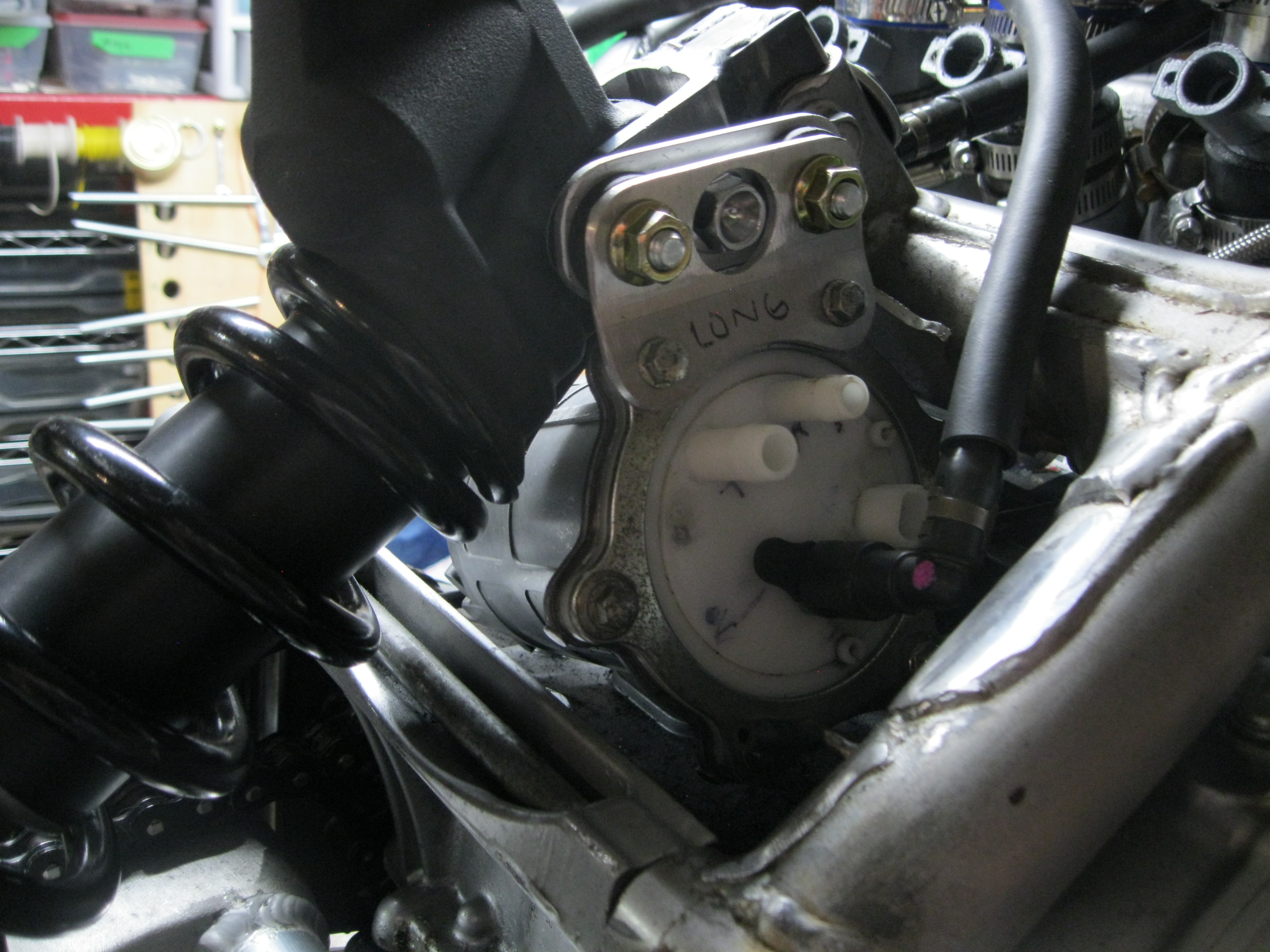

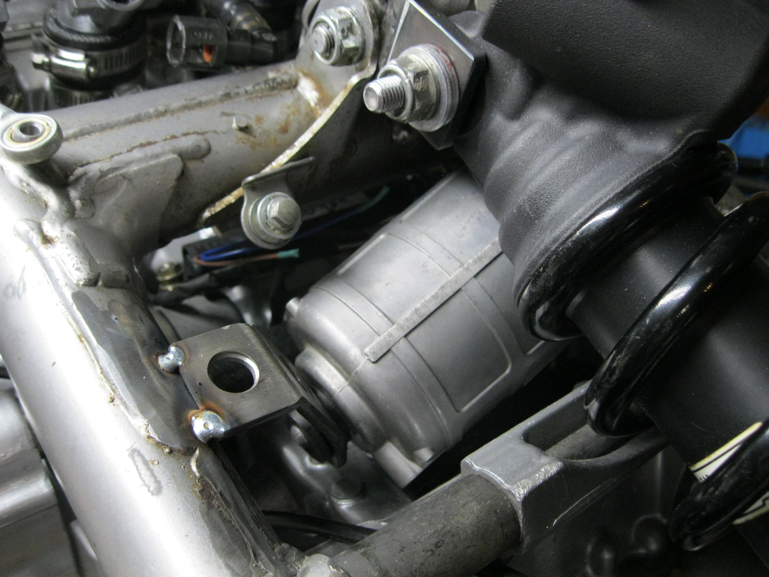

For better or for worst I decided to go with an external fuel pump. This style of pump is used on the larger Honda Foreman ATV's and the CTX1300 cruisers. It was a major pain to find a place to fit it that was low enough to allow for gravity fill from the gas tank. This location might be less than ideal because it is right above the hot engine. I am going to wrap it in heat insulation. This spot is where the factory coolant overflow tank went so I will have to find a new spot for that too.
