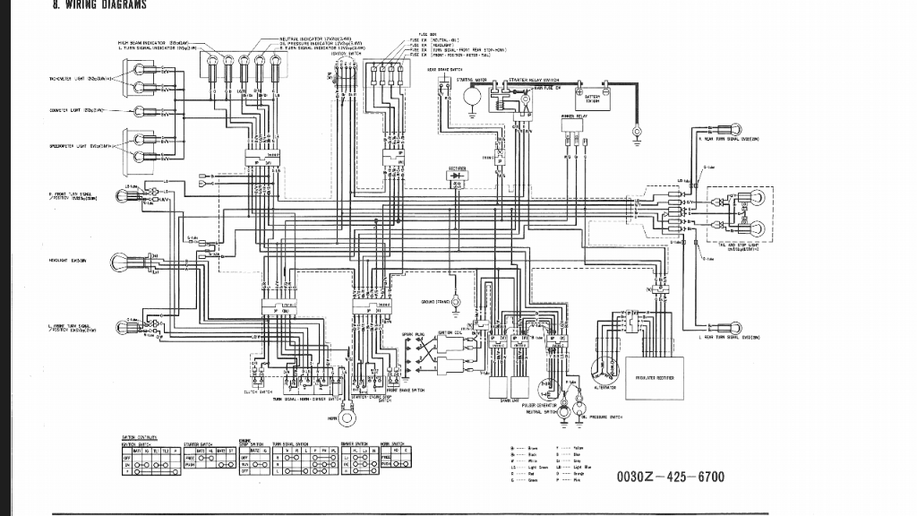

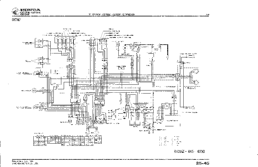

I should clarify i am using the stock Honda right hand switch (start & kill) so all the wire colors on the schematic are the same as what are shown, the left hand switch is aftermarket (turn, hi/lo, & horn) all of those function properly. Here is the schematic, the black/white coming from the switch I have hooked up to the black/white of the ignition coils and both spark units. The blue/white I had going to the white on the headlight (I guess I'm not sure where this goes). Black/red going to the aux output. And the black goes to... a headache
