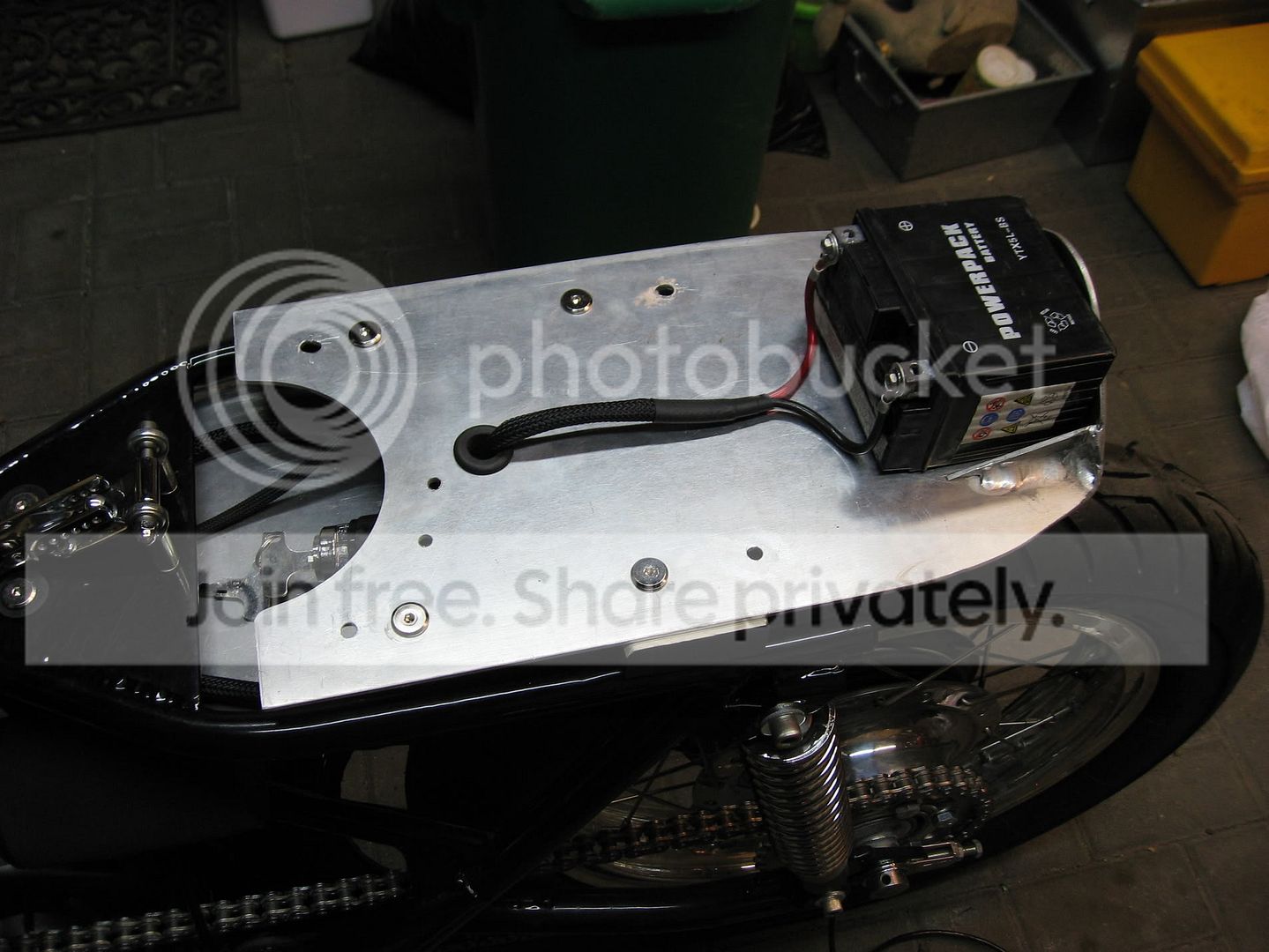

Yeah - I don't know much about charging, but I seemed to be 'over charging' my last battery - the one in the pics. It boiled over, acid out of it etc. even though it was sealed. Ran through 2 of them.
Then got a newer better AGM battery of higher capacity and no probs since.
