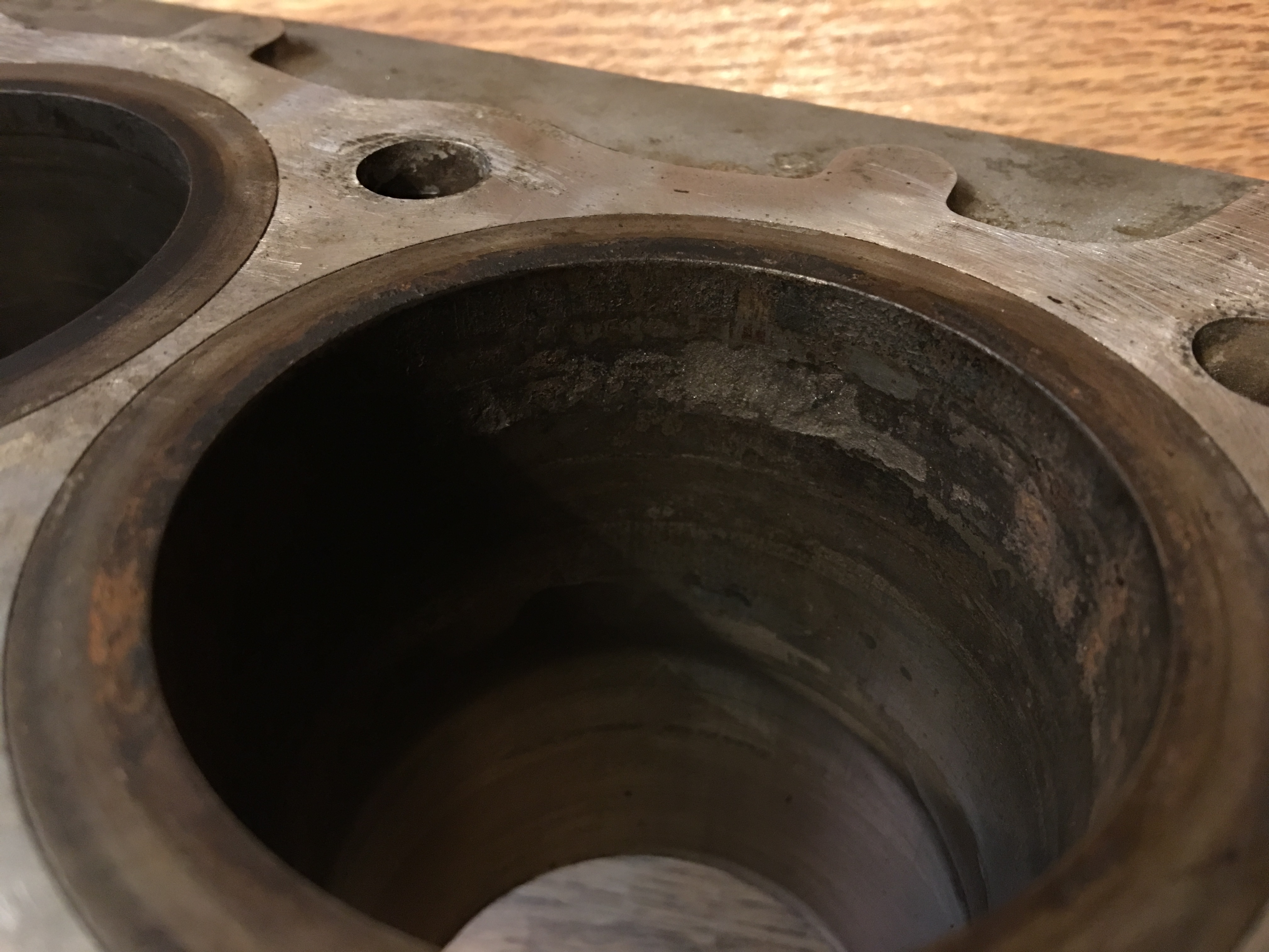

another question. after inspecting the cylinders it looks like im gonna need to get my hands on a new cylinder set. the rust from the seized piston ate away at the cylinder wall. its not just buildup. i have a picture to show for it. my question is do you know if multiple years of kz650's have interchangable cylinder sets?

Personally, I would bore it to 720cc. 8) ;)
Alternatively, (cheap option) find a 650 cylinder with one, two or even three damaged bores, clean it real good then put it in oven at 400f. The liners don't expand as much as the alloy so slide out. (sit spigots on a baking tray, the block will drop when it's hot enough)
Do the same to the 'good' cylinders you have and swap a good liner for the rusty one. You will need something to stand cylinders on to re-fit liner. If you do both at the same time you can use some wood blocks to hold cylinder up and spigots 'free' (at least 1/8" under them). Cool baking tray, put it on top of cylinders to hold liners down (use some weights, whatever you have lying around) then, pour iced water into tray. This causes top of block to contract and grip top of liner. You can always let things cool down without weights but then you'll have to press liners down about 0.010"
Couple of people on here have done various liner swaps, it really isn't difficult (CB360 liners into CB750 needs some work, block has to be bored before 'new' liners can be fitted to your CB920 ;D )
I'll probably be fitting Suzuki GS500 liners into Honda CB360 in the next few months, gives 420? cc)
As far as I know all 650 cylinders are the same although the seal around cam chain may be different. AFAIK, Kawasaki used a couple of different head gasket combinations over the years.
I mostly do Suzuki and Honda (pus some Yamaha) as I worked for all of them at one time or another. You will probably be better off asking on a KZ 650 specific site, someone may already have a good liner you could pick up cheap LA Sleeve used to be reasonable for new liners but I've heard they got real expensive ($120+)
