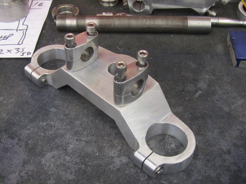

An alternative would be to fit a stepped top yoke, the one in the pic is on a Z650 using ZXR6 forks..
thats hot. Tad bit more expesive but hten you could correct the offset to be better at the same time.

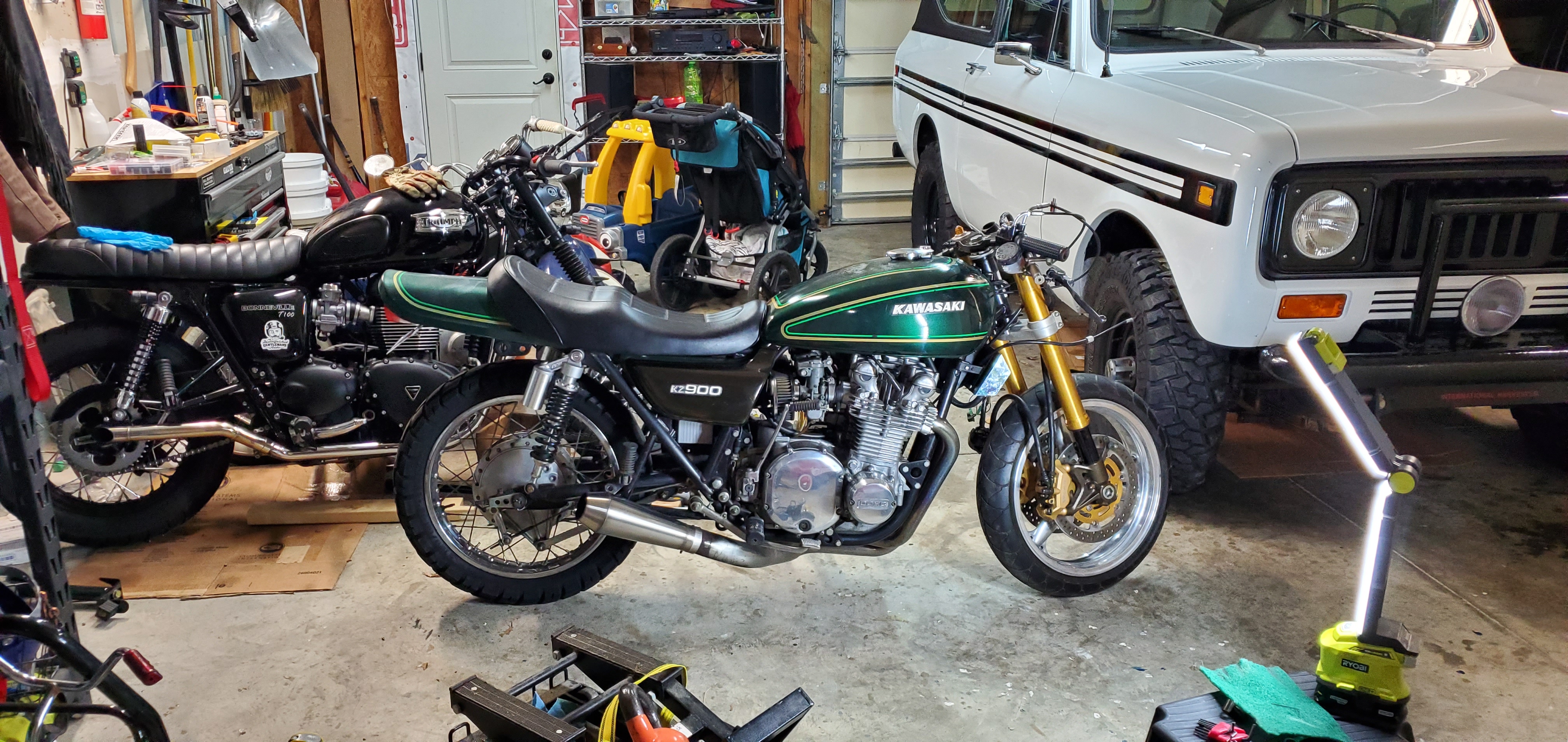

Took a look at the prices on the drop triple trees, wow that's some serious $$$$. Here is where we sit as of now.

The top yoke in the pic was made by a mate of mine, in his home workshop. Not sure how much it cost, but it wouldn't have been silly money. That said they are never going to be cheap, as you have to start with a thick block of alloy and then a lot of machining labour to get to the final shape.
Here are some pics of it being made..

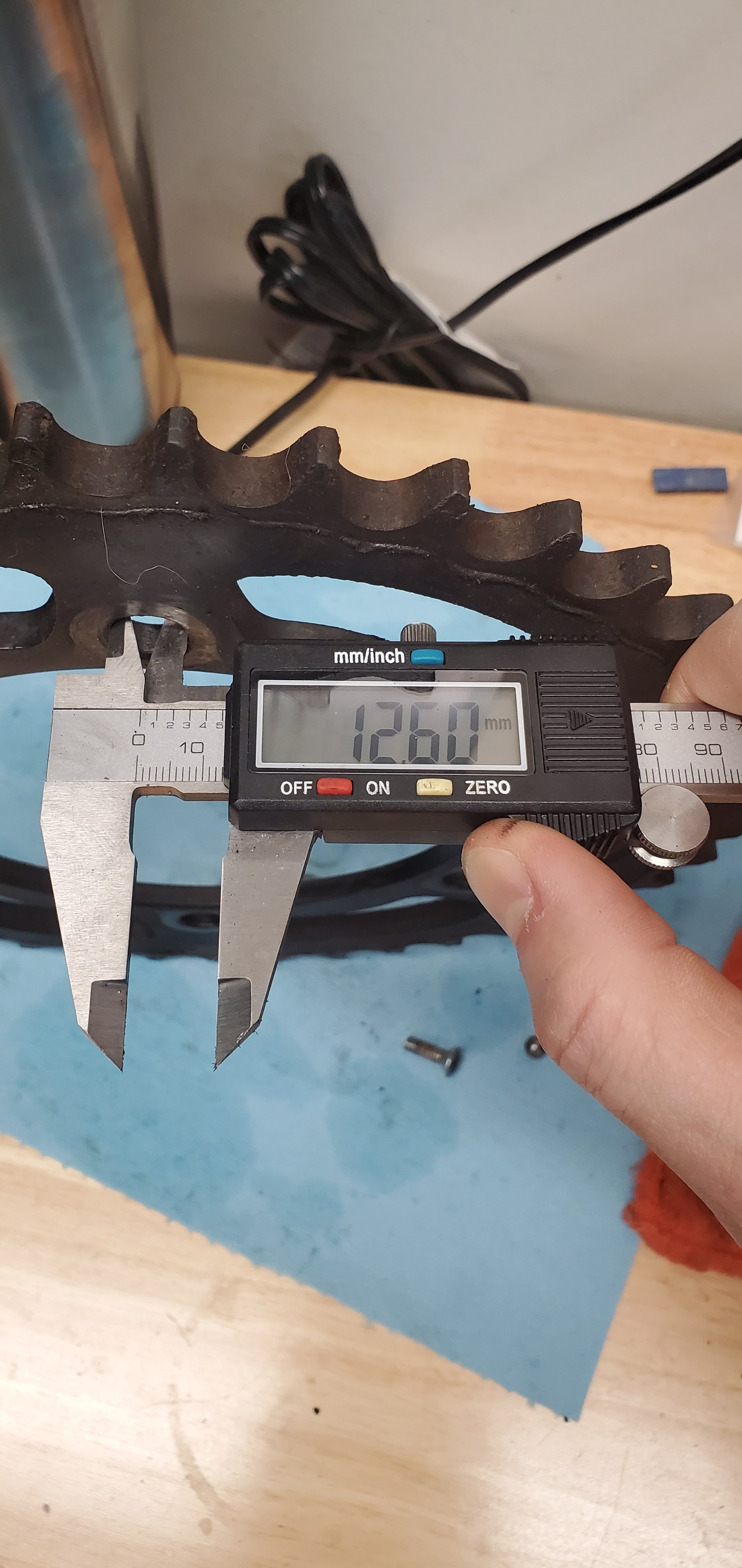

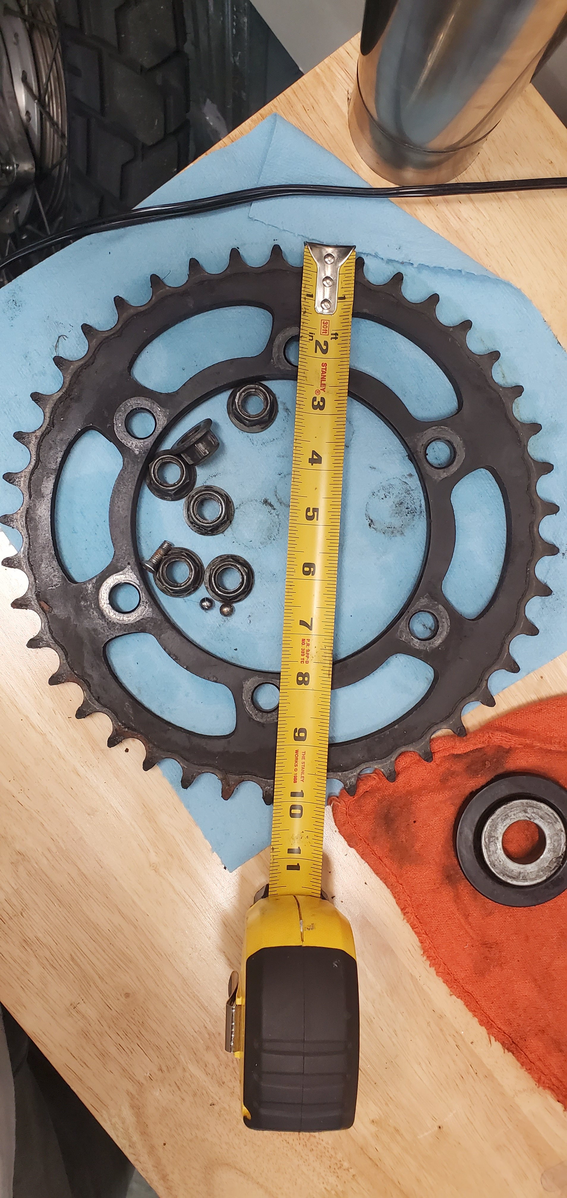

Have gone ahead and fitted a GS1100e swingarm with a 88-90 ZX10 rear wheel as well. The problem I'm dealing with now is trying to make sure my hub is actually from a zx10. The stud size should be 10x24 (when looking at the kawasaki part online), but when I measure with a caliper I'm looking at 11.8mm. The rear sprocket it came with was for a 630 chain and I'm going to a 530, and will also need to have a custom sprocket made in order to get the correct number of rear teeth to keep with the gearing I want.

My work around is I am sending my old sprocket off to Sprocket Specialists to make me a new one and to make sure the new sprocket will mate up with the hub. Once that is finished I need to install the rear caliper and make sure to get the wheel centered.

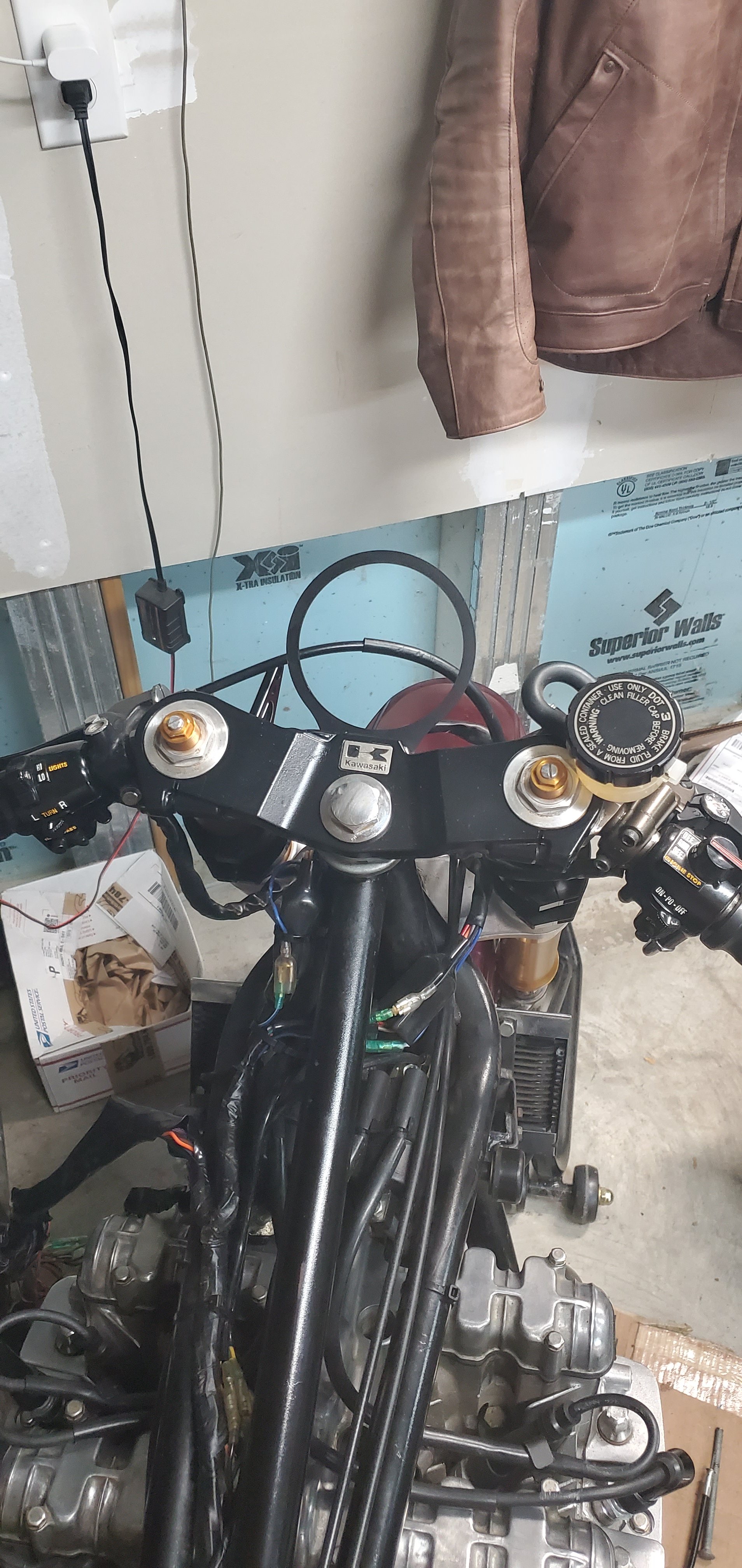

A few other things I have done is I cut off the key location on the upper triple tree and drilled/tapped holes on the underside for my gauge mount. Hooked up motogadget M-lock instead of moving the key location, which is pretty sweet. It is behind one of the side covers. Got the rear caliper rebuilt and sorted out, now just trying to work a location to mount my master cylinder. I was going to use the 2 bolts for the engine case but it will interfere with removing my battery. Also got the Tarozzi rearsets put on and they look great.

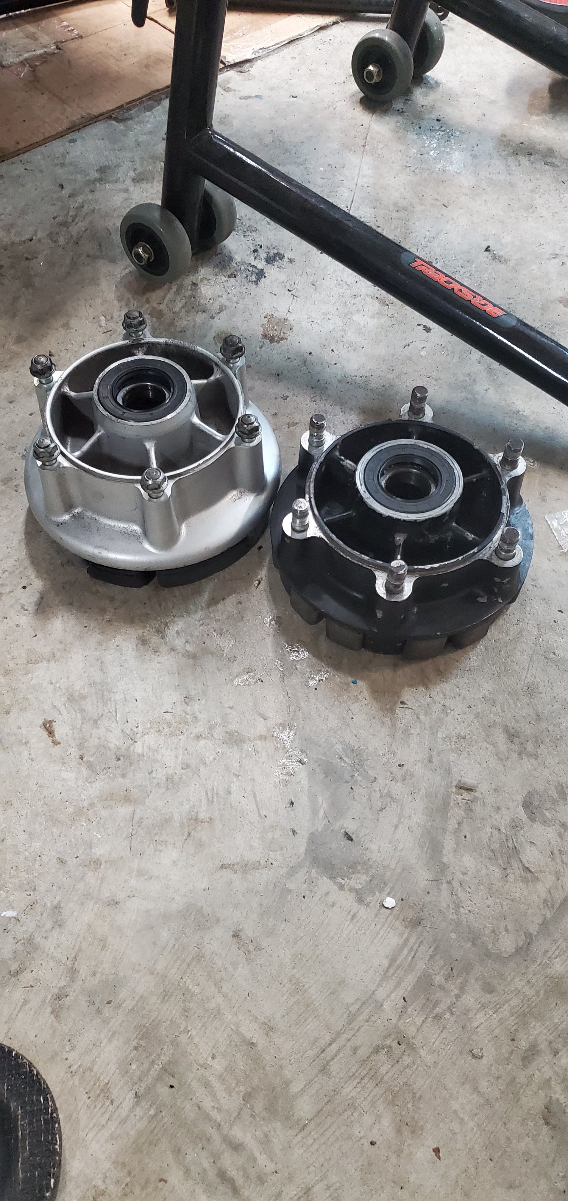

I would guess your wheel is not centered correctly or not straight in the swing-arm because the chain should clear the tire if its the stock hub and stock tire size. however you did mention there was some confusion with the studs on the hub of your wheel. Is it possible you have one from a different bike?
The wheel is from a 88-90 zx10. Is it possible the hub is not, yes. I was looking last night and the hub does not sit flush in the wheel, I can see less than an 1/8" through to the cushion drive. I did not notice this before. Will have to do some investigating.
Doc you were correct. The new hub is the correct one, huge oversight on my part. The chain for sure clears the tire after a quick mock up, now I will just have to measure the correct offset once I get the correct rear sprocket, again. The black hub was the hold one.
