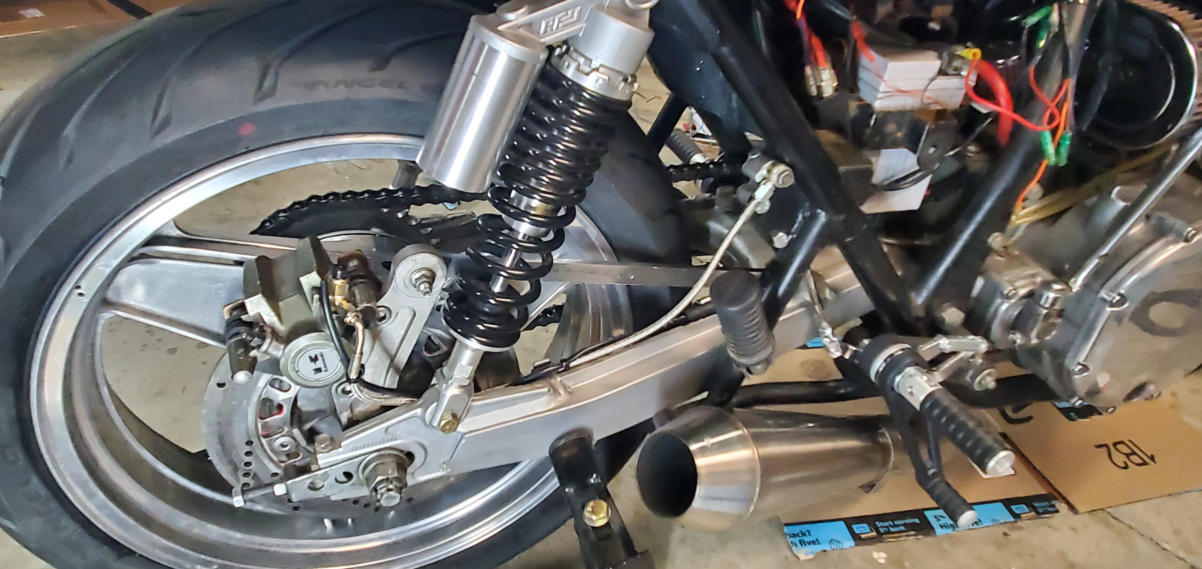

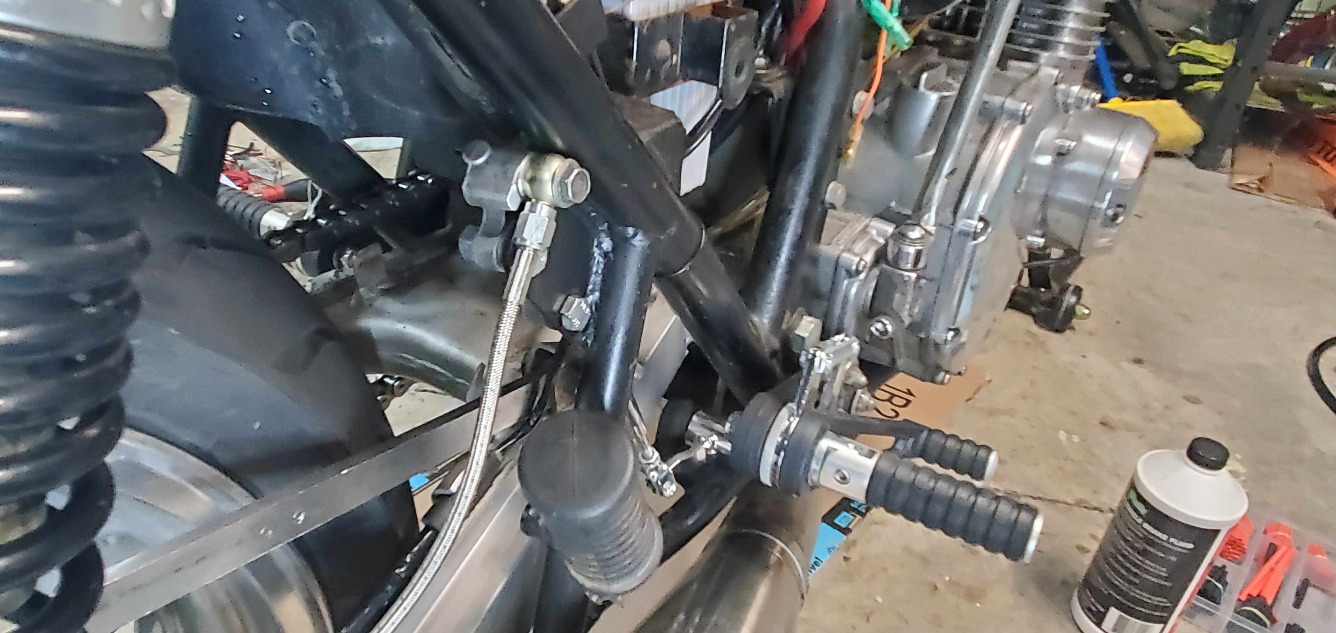

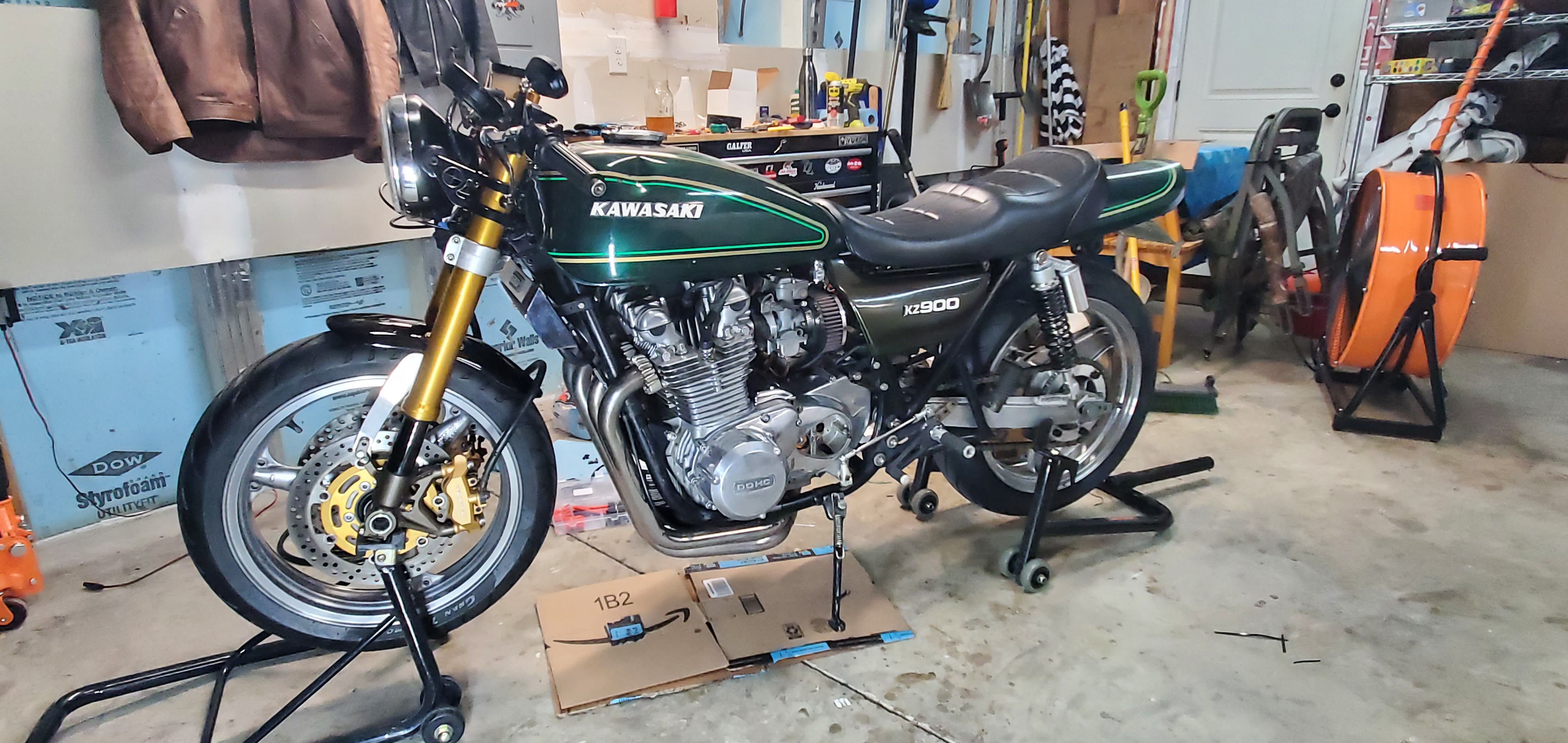

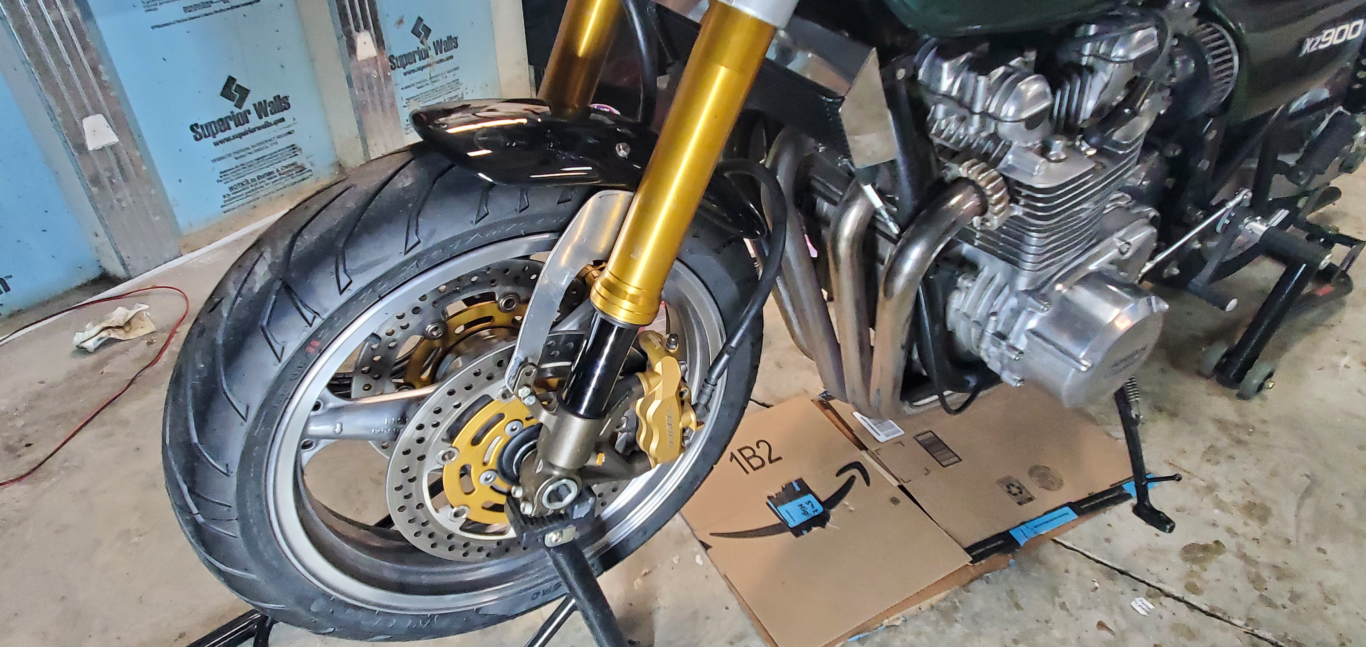

Made some progress and almost have it all finished. Got the speedo/tach wired up, front fender mounted, rear tire centered and a bracket made for the rear MC. I had to fab out the centering of the tire since I had to have some spacers machined up. Took it out for a spin yesterday and I'm really happy with how it rides.
I do have a leak with my rear MC, so I have a rebuild kit on order and that should fix the non existent rear brake problem.
