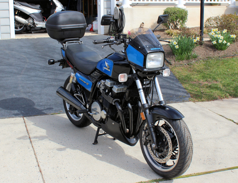

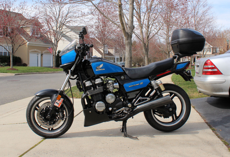

Here's mine, a modified Honda VTR1000F fork on a 1984 CB700SC (Nighthawk). I had to use custom length stanchions on the VTR fork lowers as the NH has very long forks. To get the steering geometry in the right ball park I had to slip the forks up, but it got a little complicated when I used slightly lower rear shocks (oem KYB shocks for the Kawasaki). I had to rejigger the back shock mounting points to raise the back.
It turned out greeat and the bike has proved to be a real hoot to ride.
Jerry
