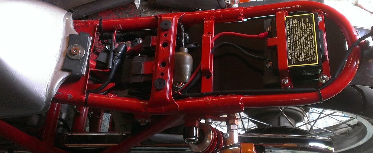

I got a used KZ200 Kawasaki which has been done cafe racer style. It came with the battery box removed and a small lithium battery under the seat. It's a 2.3AH one:
It seems the company that makes this no longer exists. I think the battery is a few years old now and was struggling to start the bike. The other day the bike dies while idling and the starter wouldnt start it. The kick start wouldnt start it either so I guess the battery was acting as a parasite and stealing all the ignition power. I disconnected the battery and it started right up on the kick start. The engine wouldnt rev smoothly above about 3000rpm with the battery disconnected though so I had to reconnect it once the engine was running.
Now I'm looking for a replacement battery as I think this one is done. Given that there's no battery box any more I need something else small that I can put under the seat. Any recommendations? Doesn't need to be particularly powerful as I have the kick start and I'd also like to avoid spending too much money, just need something to get mobile again.
Thanks
+1 for the antigravity battery..Ive had one of the above for 2 years now and its never not started my electric starter only 250....

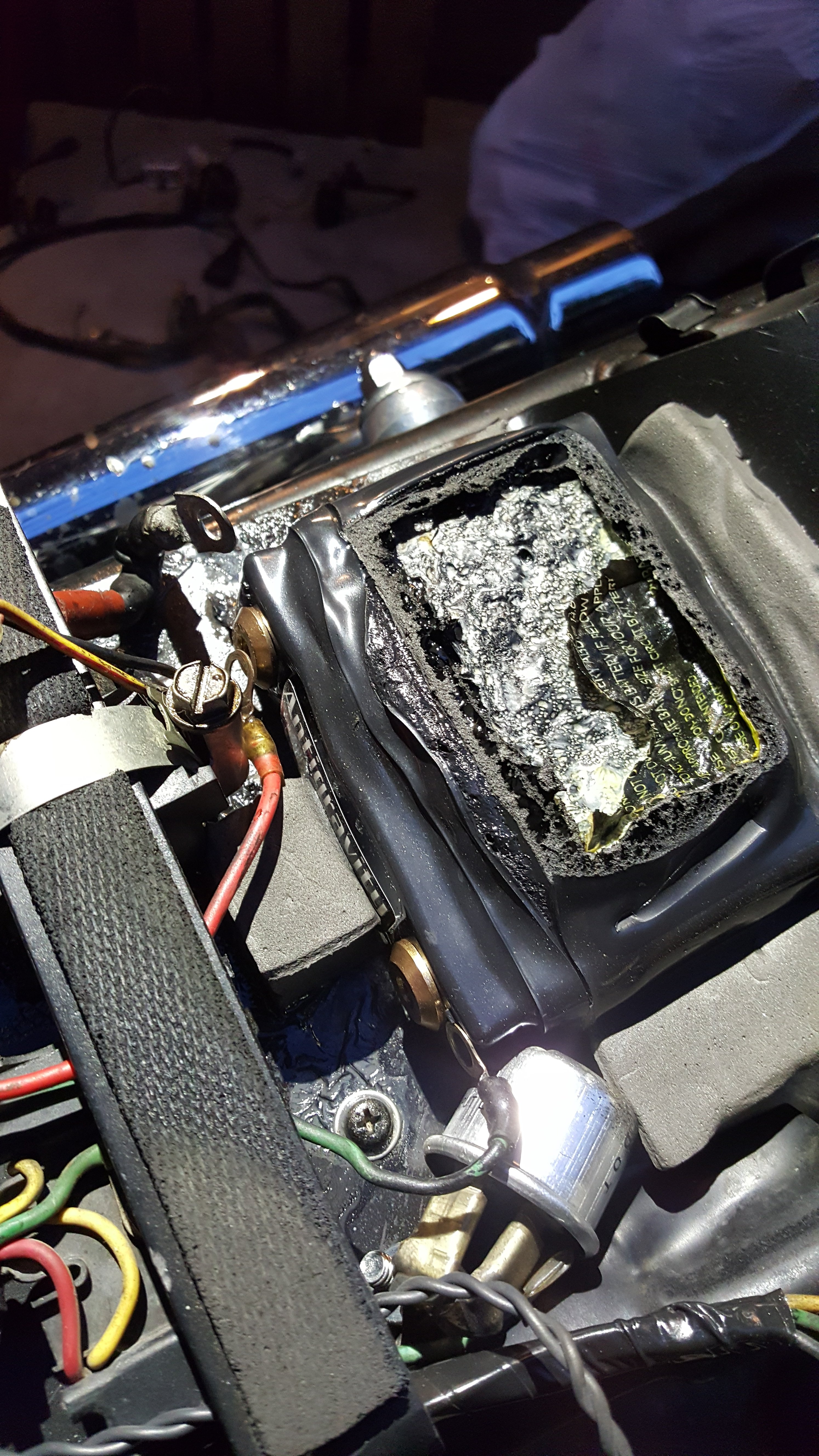

regarding the antigravity batteries - they are Lithium-ION batteries - which basically makes them bombs unless treated very carefully. They do not like to be overcharged (anything over 14.2). they do not like to be discharged below 11 volts. they will melt down and catch fire if you do what you did to your bike (let it discharge, then kick the bike over and attempt to ride home)
antigravity will ignore all warranty claims. no matter what. I had one DOA - never installed. no warranty because I couldn't tell them what bike I was installing it on (because it didn't have a home yet!)
I still have one in my bike, because it would be impossible to find another battery even close to the size that would still work. but I check voltage religiously, I have a little Battery Tender Voltage Checker
I have a charger specific to Lithium Ion Batteries, and I have a Rick's charging system specific to lithium ion batteries.
just beware - these are not lithium poly batteries that have their own voltage protection circuits... these are just chunks of death waiting to happen.
They're all LiFePO4 batteries. There is no actual Lithium Polymer batteries on the market yet. The ones listed as such are LiFePO4 packaged in a polymer casing. The differences are in whether they have the electronics to manage charge or not. Antigravity may not, which may be what happened. I don't know for certain. I have tried several brands and designs besides the Antigravity, such as Shorai and EarthX. Personally, I prefer EarthX over all others. I have had zero issues with them, and I haven't been good about tendering the one in my BMW. I have killed two Shorai LiFePO4 batteries with my chopper.
