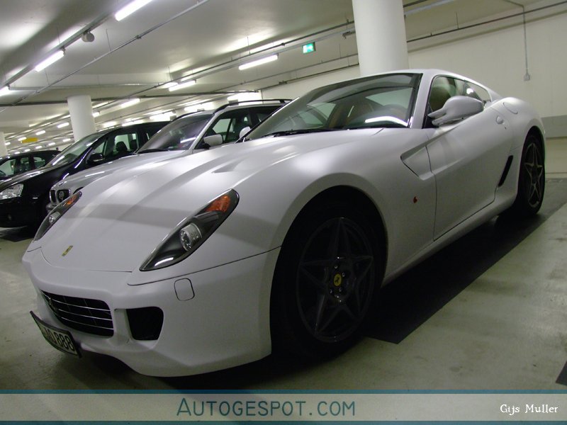

I was hoping to do a matte white tank, does that exist? lol
I had a can of AMP energy drink the other day and it has that slightly rough but smooth matte finish, and i loved it. I want my tank like that. not a fan of the super shinny look.
any ideas? links? images?
