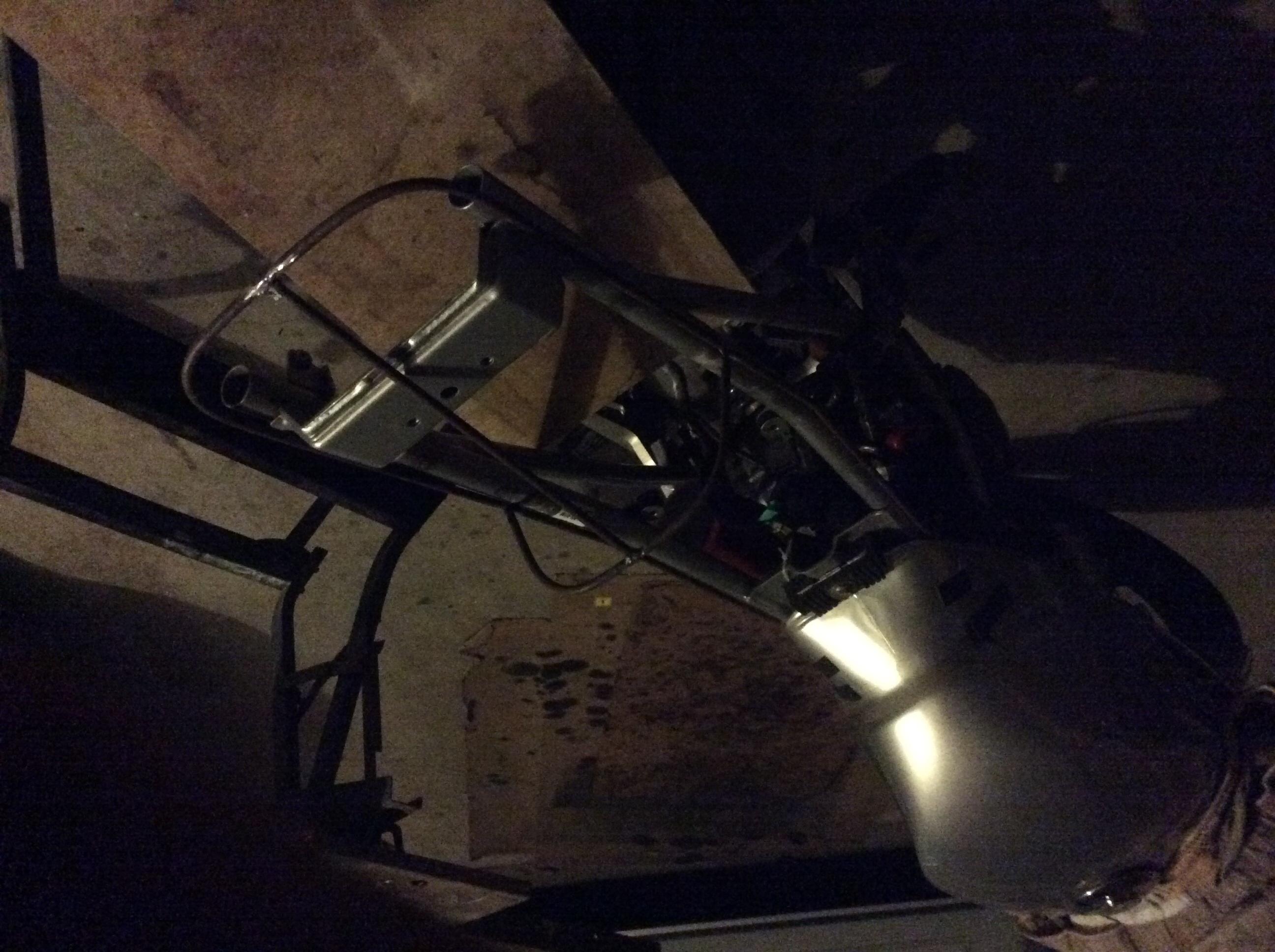

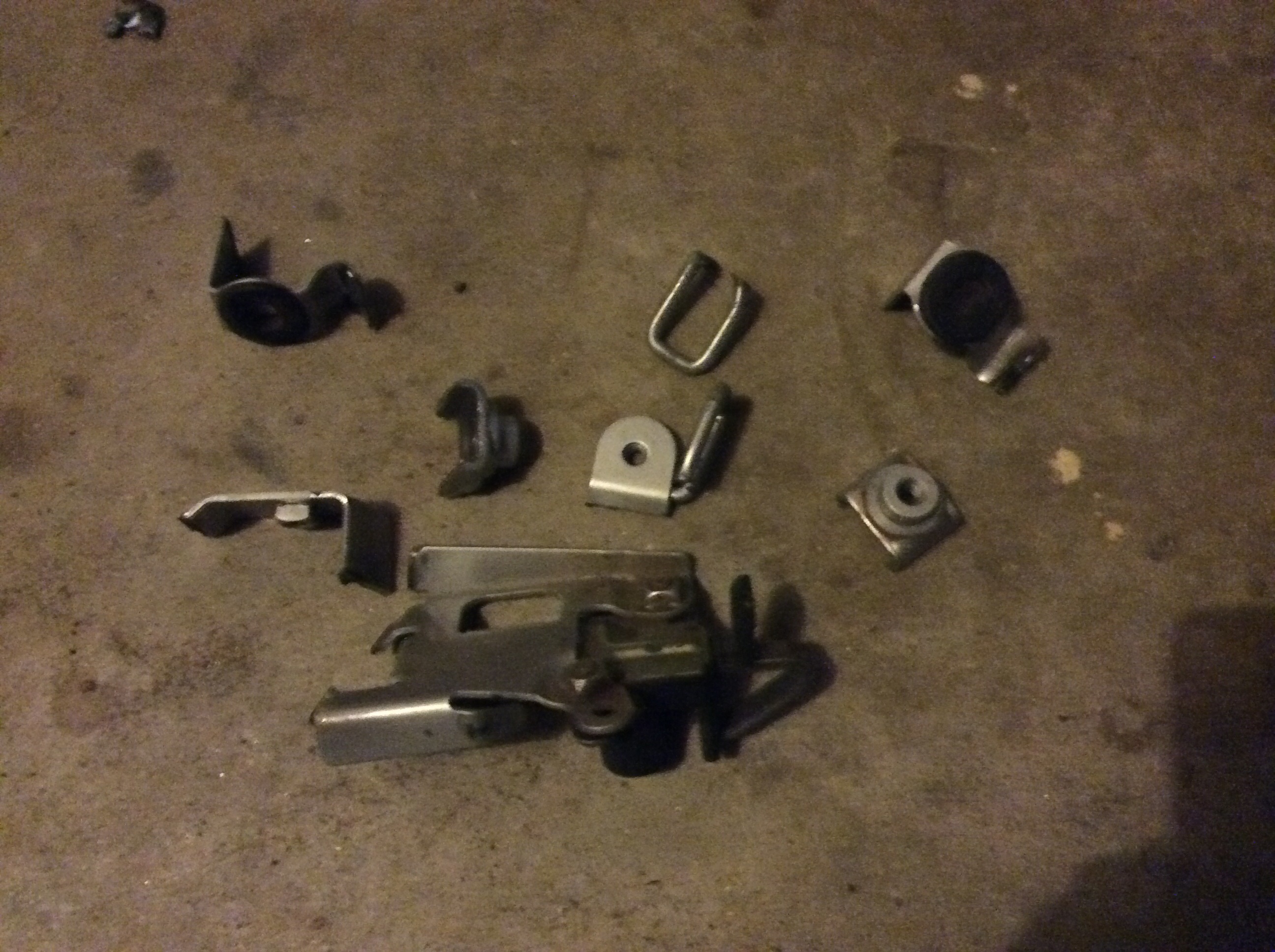

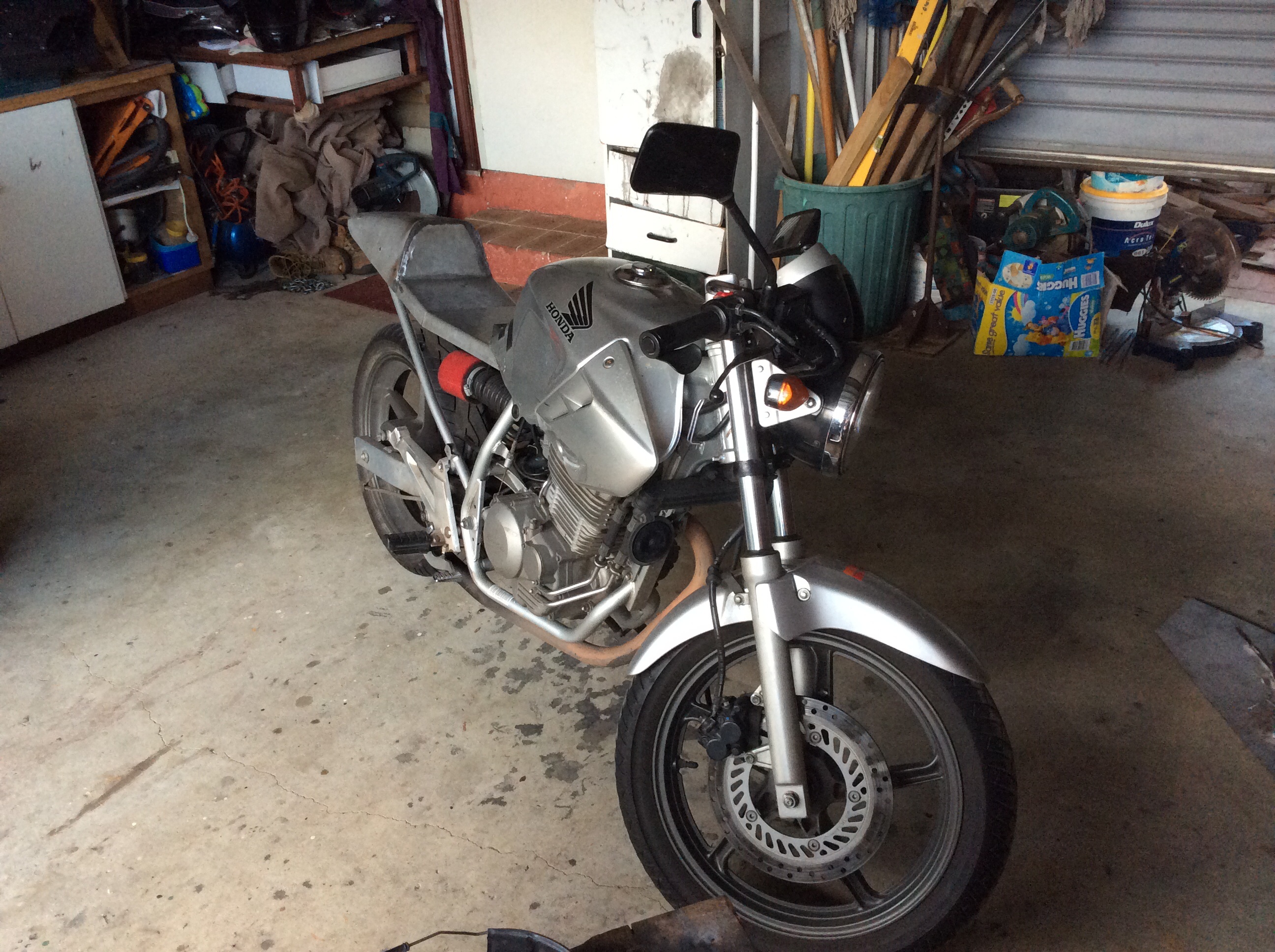

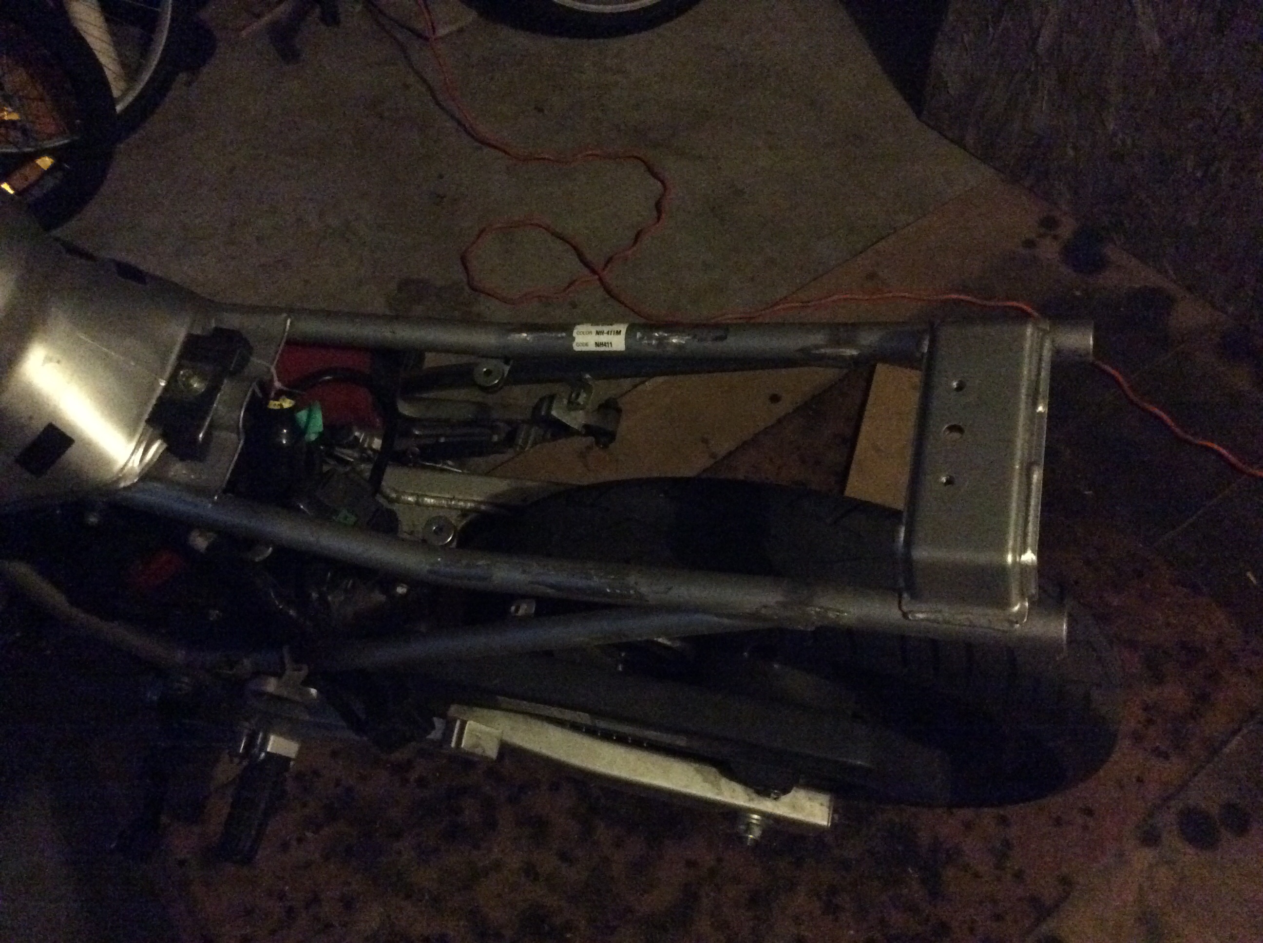

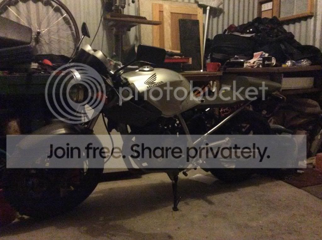

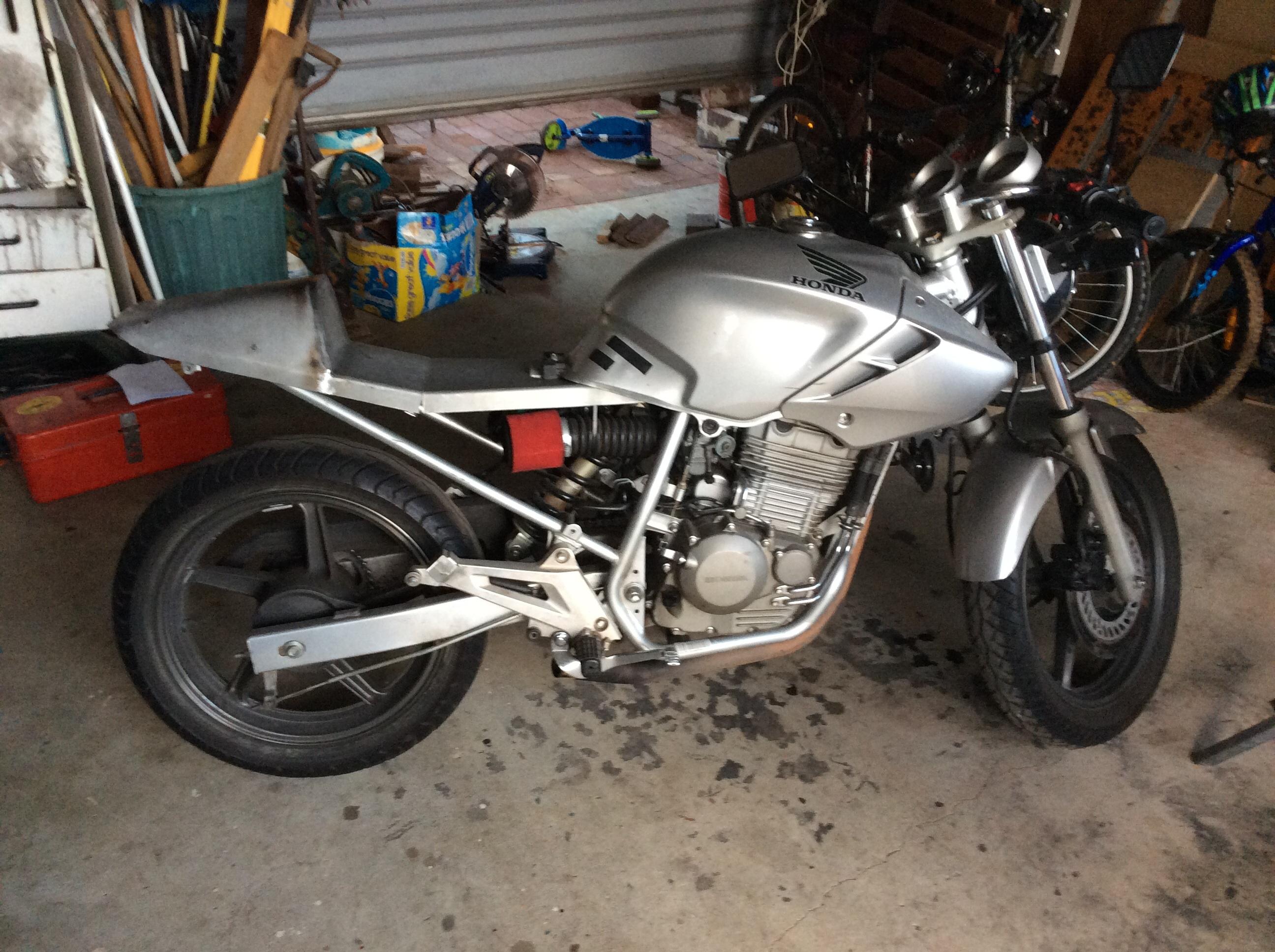

Been some time since my last post however finally got round to creating something new for the bike. Enjoy the photos.

Just made the rear light unit today. Light is from a XR250. Looks a little plain on the whole but hopefully blends in with it being painted.
Talking of paint picked some up today from the auto paint supply shop. Going to go with a satin 1942 army green colour replacing the silver with a bit of black here and there. Looking to add some Aussie army graphics to it as well. Bit of internet hunting might bring up something interesting.
Did some weighing of the parts that have been removed. 16 kgs all up. All that has been put back on is 4 kgs plus some seat foam yet to go on which will weigh F.A. so total weight reduction has been 12 kgs so far.
Can probably find a bit more with swapping the battery when it dies for a lithium one, smaller/lighter tank and slimming down the peg units. Perhaps a bit of drilling here and there could also free up a bit of weight but probably not much. Pretty stoked with that.
costs of all this. 20 bucks for steel, 2 for aluminium, 50 for paint (will be enough for whole bike), 10 for light unit, 10 for electrical sockets and replacement bulb, 10 for fasteners and about 30 for tools. So all up now 400 bucks spent and all good too.

Did a little spraying today however and the colour is right on.
Graphics so far will be oz army red kangaroo and " danger ejection seat " you see on fighters. Going to find some more down the local military museum.
