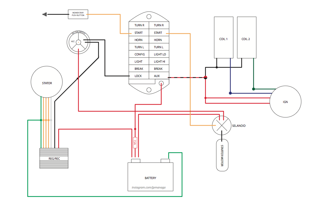

I ended up figuring out the issue on my own by removing the ignition switch and metering for continuity between the Red and Black wires. When the switch is in the off position there is no continuity and when it is in the on position there is. I also came across a simplified schematic on the sohc forums. If the wiring is essential the same, which it looks to be, can I go just go by it?
Also, in the schematic, which i have attached, there is a black wire from the regulator/rectifier that is spliced into the black wire from the ignition switch. It then also goes to the lock input of the m-unit. That said, my next question is what purpose does it serve? I read that it is a sensing wire, but what does it sense?

That's more or less correct, but your wiring for your ignition system will be different. You should have two spark units on your bike. Each will need to get power, go to their respective ignition coils, and also connect to the pickups inside the engine.
I would also add a fuse between the battery and the ignition switch. A ground wire should also exist between the battery and the frame and possibly a redundant wire directly to the m-unit as well.
The black wire on the R/R is the voltage sensing wire and the power wire for the R/R. It's used by the R/R to know when to start regulating the field coil as well as providing a power source for the field coil. On your bike, there will be two black wires, but no green wire. One of the black wires should go to the AUX output (not the ignition switch) and the other will go to the alternator. Going directly from the ignition switch to the R/R bypasses the internal circuit breakers on the m-unit: not a good idea.

The spark units and the coils will both need power, preferably fed from the AUX port on the m-unit. For the regulator/rectifier, the black wire that's in the four pin connector along with the red and green wires is the one you'll want to use. The other black wire should connect to the alternator.

1.) The solenoid for most of the DOHC bikes has a four pin plug. One is ground, one is to activate the solenoid, and the other two are always on. Skip these last two, no longer needed. The green/red wire can be grounded. The last wire, yellow/red goes to the output for the start on the m-unit.
2.) Doesn't really matter too much so long as the output from the kill switch goes to the coils. Leaving the spark units with power when the coils are off won't hurt anything.
