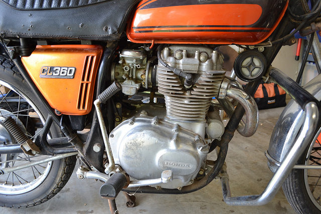

This is my first bike, and i really do not know much. I just bought it a few days ago. I plan to cafe it out.
The bike starts up but will not idle for longer than a few minuets? I drained out the old gas and put in fresh gas as well as put on clear fuel hoses and fuel filters and it seemed to flow smooth and clean with no muck and dirt but it still died out after a few minutes. The guy that i bought it from said he sort of cleaned out the carbs but didn't sound very reassuring on it. I have not used any starter fluid nor have i changed out the oil yet. Not sure how much of a difference that would make?
I also noticed when it was running that the upper exhaust pipe was blowing much harder? I did not change out the spark plugs because they still looked pretty new.
In addition, the previous owner must have tightened the upper triple clamp on the tree stem way too tight because both sides are cracked. Any suggestions other than eBay for upper triple clamp? Also, do I have to search for fork clamps that are from 1975 only? or is there a range of 70's honda clamps that will fit the same?
Any suggestions, or things I should be looking for as I try to get this bike fully up and running?
Please feel free to ask any questions. I'm clueless on this stuff, but I want to learn. Any thoughts, advice, or suggestions will be GREATLY appreciated. Thanks!

Good luck finding a top triple. These are known for cracking. The year won't matter with these. You can use any from the cl, cb, or cj 360. CM400 triples also work.
I'd clean the carbs to start.
Also, let me know if you end up getting rid of that exhaust. I've been looking for one.
I second the carb cleaning.
My bike would barely start, running on one cylinder and wouldn't idle. Sprayed some carb spray and the second would start up, but still no idle, and gushing gas from an overflow tube. my carbs didn't even seem that dirty when i took them apart, but after i put them back in, all my problems were fixed.
Its my first bike also, and i'm learning that the most important thing is to do things right the first time. ( i took my carbs apart 3 times ;) )
also look for rust in your tank
What kind of compression readings have you gotten or have you tried? My 360 had a soft left cylinder that barley made any thing around 30-40 and it would NOT idle for very long as such. AND it barely puffed out that side of the exhaust. IF you haven't checked yet do so, pull the plugs make sure the choke and the throttle are wide open and kick the fire out of the thing until the pressure in the gauge stops rising. You WANT 165 COLD on both sides and at least 170-175 warm with no more than 10% between each side. They will run on lower, just not very well. I know been there have that coffee cup and the bill to prove it.
THEN look at the carbs. I cleaned and cleaned and cleaned my effing carbs but made no difference until I gathered up a compression tester and figured out the real problem. The off balance of the exhaust pressure is a good indicator as well that the carbs are out of sync so that may be the next step to check once you clean them and check them out.
The clamps wander across eBay now and then some go high $ some sit unsold depending on how badly ppl need them. ASAIK, any model 360 will have the same triple clamp. Do some research, I believe that a CM400 will work as well, but I forget right now. ::)
As far as the rest, get yourself a manual, preferably a shop manual. Get an IMPACT SCREWDRIVER. And have fun. ;D Looks like a great starting place for a cafe or a resto since you look to have a mostly complete bike.
EDIT= Did you or the PO put the added fuel shut offs in line? These bikes need the fuel shut OFF when you are not riding them or they can possibly fill the crank case full of fuel and all it does is thin the oil and cause parts to WEAR OUT. STOP running it right now and check your oil for FUEL smell or feel. IF it does CHANGE IT right away and pray that something bad hasn't happened.
Step 1: Change the oil.
Step 2: Compression test. If its bad, really bad... You need internal engine work.
Step 3: Check valve clearances. Put them to stock.
Step 4: Check the points. Put them to stock.
Step 5: New plugs. Use the right ones. Your manual will tell you what those are.
Step 6: Replace the plug ends. You can get new ones at Auto Zone. Cut about 1/4" off of the leads, and screw in new boots.
Step 7: Make sure you have a good battery. Old Hondas HATE bad batterys.
Step 8: Pull and CLEAN carbs. Make sure the jets are ok. Clean all passages. Etc...
Step 9: Make sure that the carbs are reinstalled correctly, and that there are no vacuum leaks in the intake boots.
Step 10: Clean the (probobly) filthy air filters as well as you can with compressed air or replace them if you can.
Step 11: Make sure the exhaust is tightened correctly.
Step 12: Start bike.
Step 13: Set timing. Again, refer to your manual for this.
